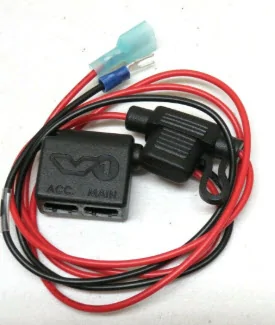

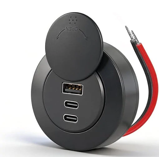

I purchased the Bulletpoint rubigrid and I am going to mount two of their magsafe charger phone holders as we are taking a long road trip and want to be able to have my phone and my wife's charging and will give a good place to keep them. I also purchased the 12v adapter that plugs into the factory cigarette lighter from behind the dash and provides 12v power and a usb c outlet (2c and 1a) that I intend to connect to the magsafe chargers behind the dash. I was thinking about it and would it be possible to have not just the usb outlet wired to the 12v but also hardwire my Valentine1Gen2? Normally its not in the Jeep, but for a long road trip I will have it in there. Thanks.

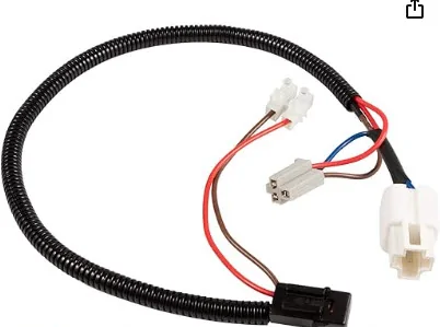

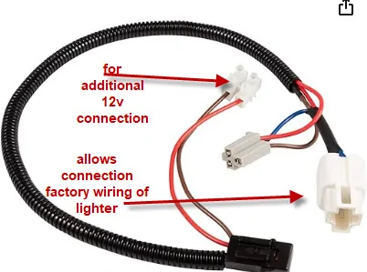

Yes. Just splice it in to the power and ground wires.
The 12v adapter factory wiring adapter has a red and black (looks brown in the pic) with a screw connection to allow additional 12v. I was concerned if I had the UBS red and black and the Valentine red and black both going into the two connectors would there be enough power for 2 phones and the radar detector.
I was going to combine the USB and radar wires together into the one connection from the 12v extender.

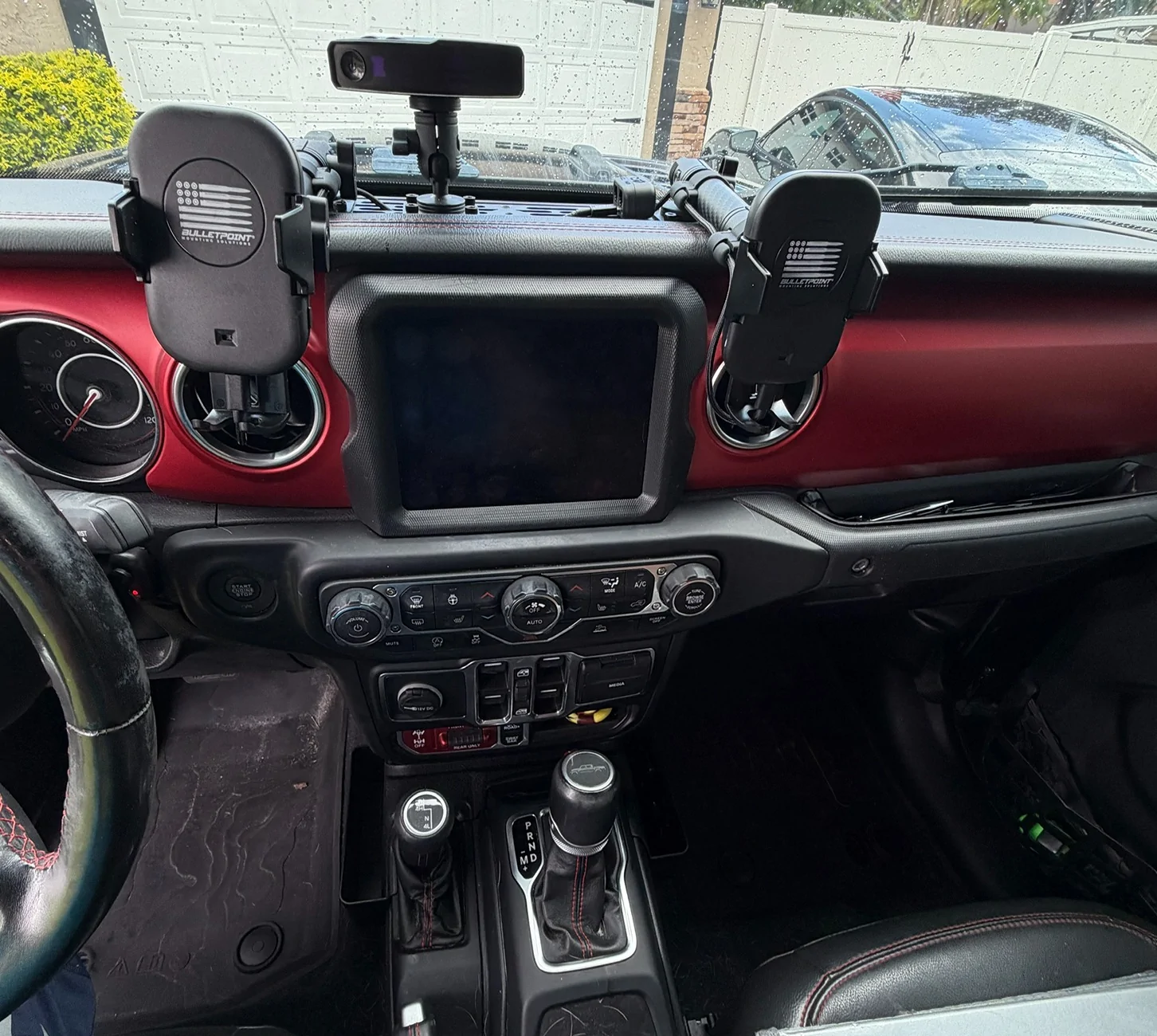

I used that same lighter plug adapter to power a radar detector and wired in a another lighter plug behind the dish so that i could use a higher output lighter plug power adapter to wire in an apple magsafe charger and run an additional usb-c wire out for my passenger to use. Dropped everything down below the dash from the tray on top so it would all stay hidden.
