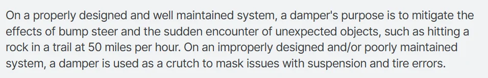

A dry steering test is where you should start with diagnosing death wobble. This is done with the tires on the ground.
The steering damper will not cause or prevent death wobble.
Yes, you need the load on the steering components to force any loose joints to show themselves.
