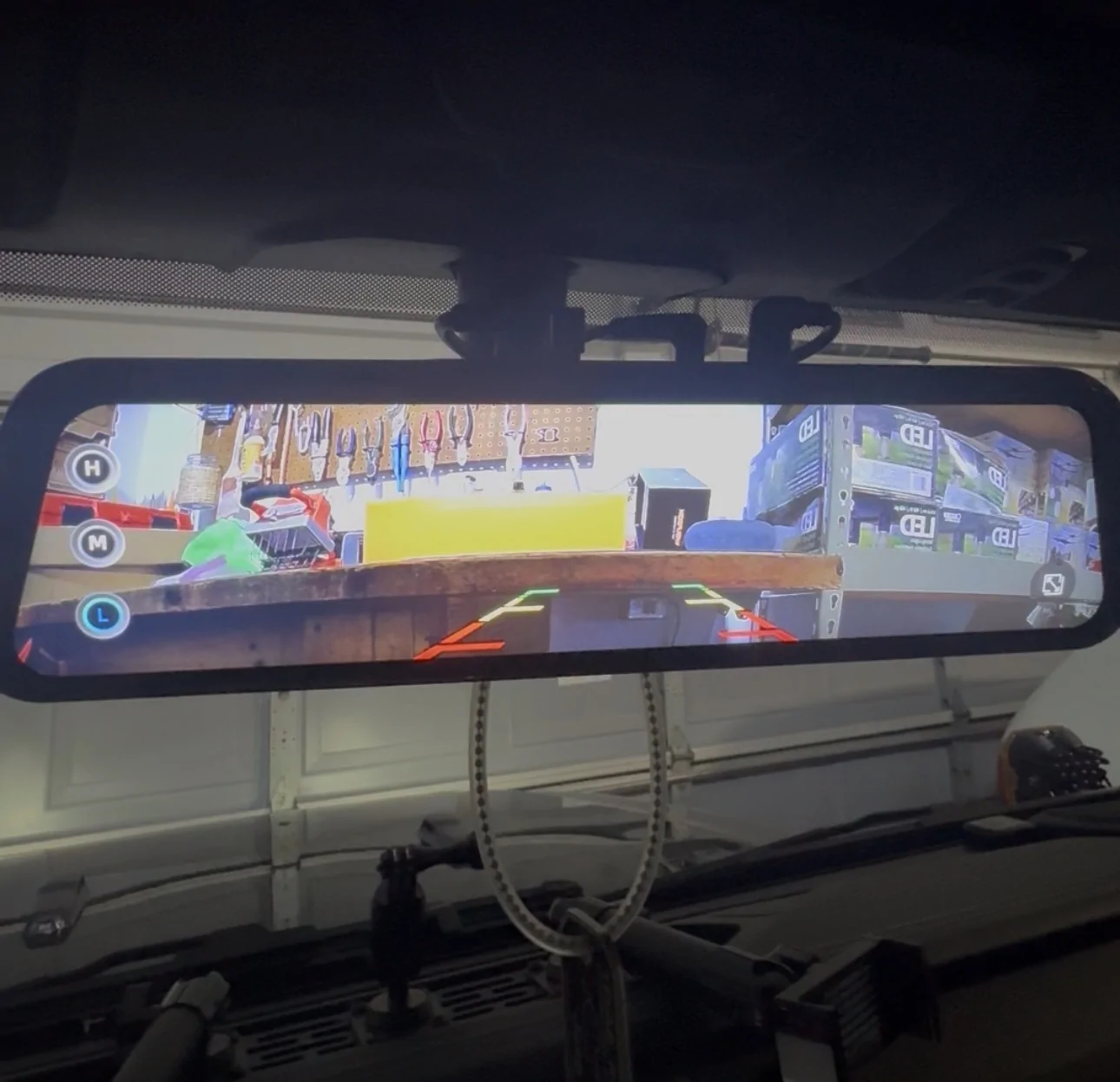

Secondly, at one point, the screen, even after rebooting would get stuck on my rear camera specifically under the grid lines screen as if I was adjusting the lines L M or H etc. (which I don't even have set for the rear mind you) but on top of that doesn't even give me the back arrow at the bottom left to go back to the original screens or even the Settings menu. Was literally stuck on that screen. The only thing that got rid of it is power cycling. I've done a factory reset and it seemed to get rid of that problem. (Atleast for now).
Lastly, and I'm not sure if this is due to an update or something on my end, but on all cameras I cannot slide the brightness up and down from the camera screen as I've seen others do before on the right side of the screen. Also I'm not sure which cameras have the function but I can only zoom in on the rear.
I'm not sure if I need a firmware update or what but even that seems complicated and I can't find much information. I just want it to work properly. First photo is the screen it was stuck on. Again this has seemed to be fixed for now. But with the random shutting off, not sure if it will happen again.

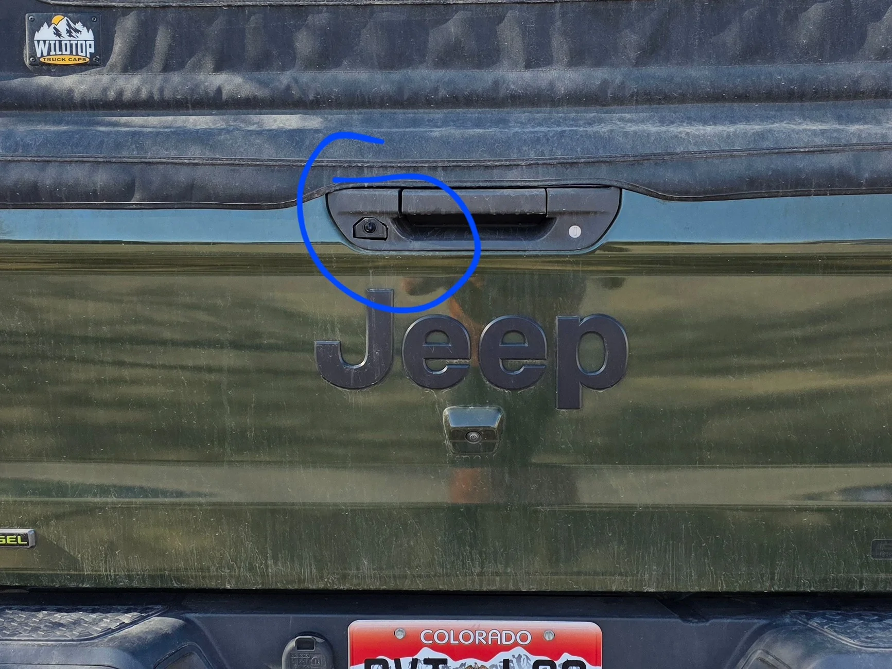

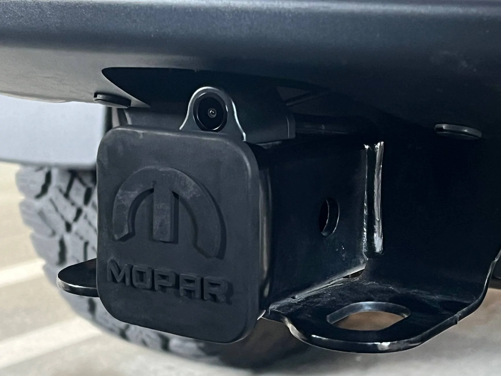

Has anyone come up with a good location to mount the rear camera if you do not have a rack or topper to mount it to, so as to keep it higher?
I saw one that cut a hole in the tailgate handle's cover. Not a bad idea but want to keep it as clean as possible.
Bumper mount is ok, but will that be high enough to get a good view?
Not necessarily an answer to your question... but after having a few of these in different vehicles (currently have the G900 Pro in the Gladiator), I am not sure that treating them as a 1-to-1 rearview mirror replacement is even the best way to think about them. I initially had the same concerns you do, but now have them mounted as high as the top of the SmartCap and as low as the top of the license plate. My brain can make both locations work IF I just treat them like the always-on, mirrored-image, rear-facing cameras they are.
All that is to say, you may not care all that much about the specific mounting location, depending on how you use them.
Nevermind... You said "Higher"

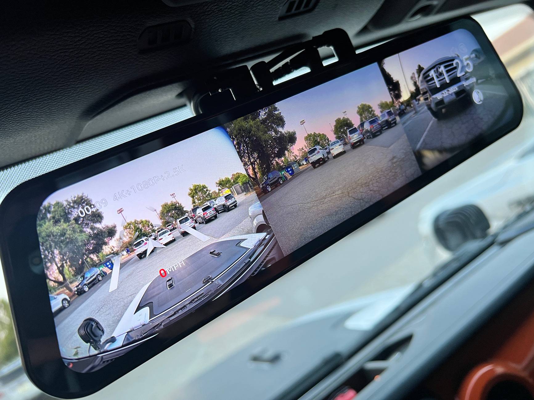

If it's any help the example of the rear view is on the far right
