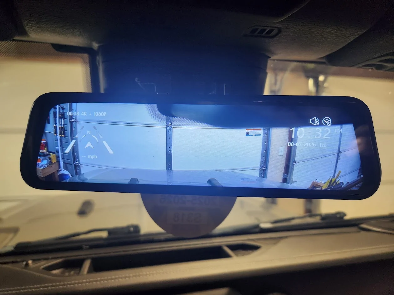

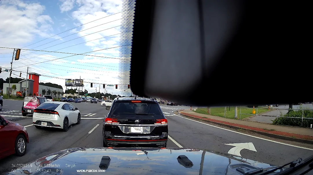

My biggest gripe is that the camera itself is mounted to the mirror. Because I have the ACC module, much of the actual footage for the front camera is a big black box. I thought I could space the mirror down far enough, but when I did that, it put the mirror fairly low, and I liked that even worse. Again, I know I should just get something that I can mount under the ACC module or on the windshield itself, but as I said, I already bought this, and I like to tinker. I have done some cursory research and think I have an idea how to "fix" this, but that's a problem for future me to figure out.
Jeep Gladiator WOLFBOX G930 mirror install and fixes 1786158606370-pa

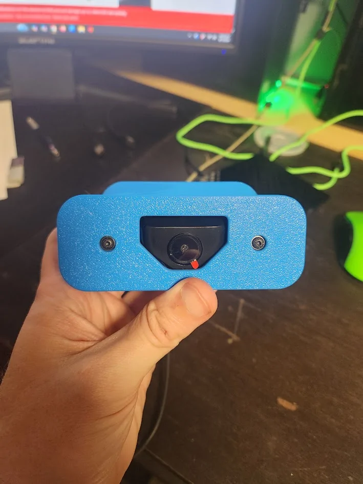

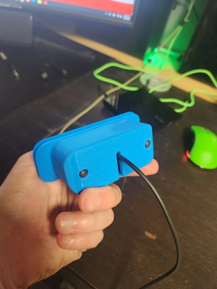

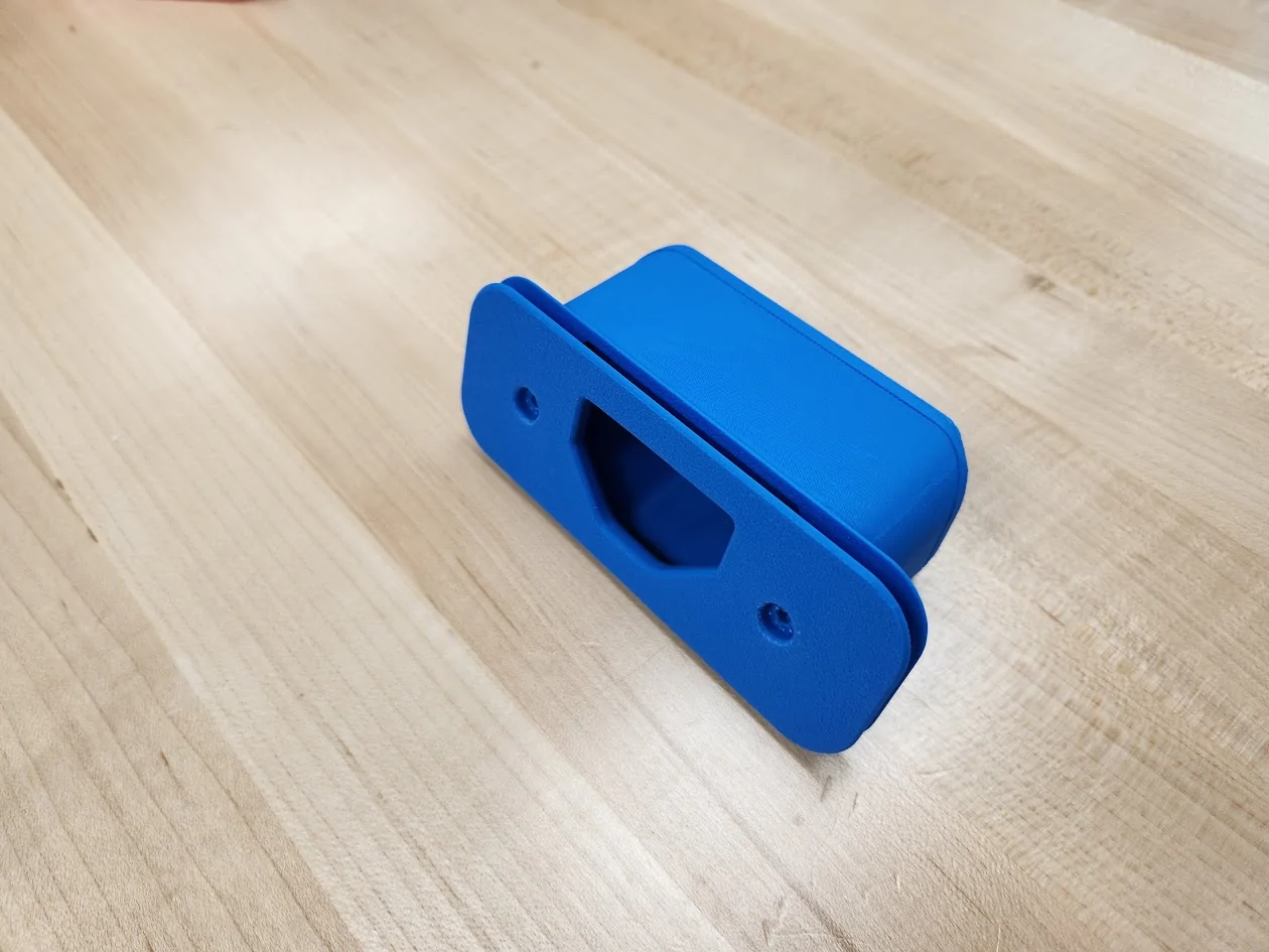

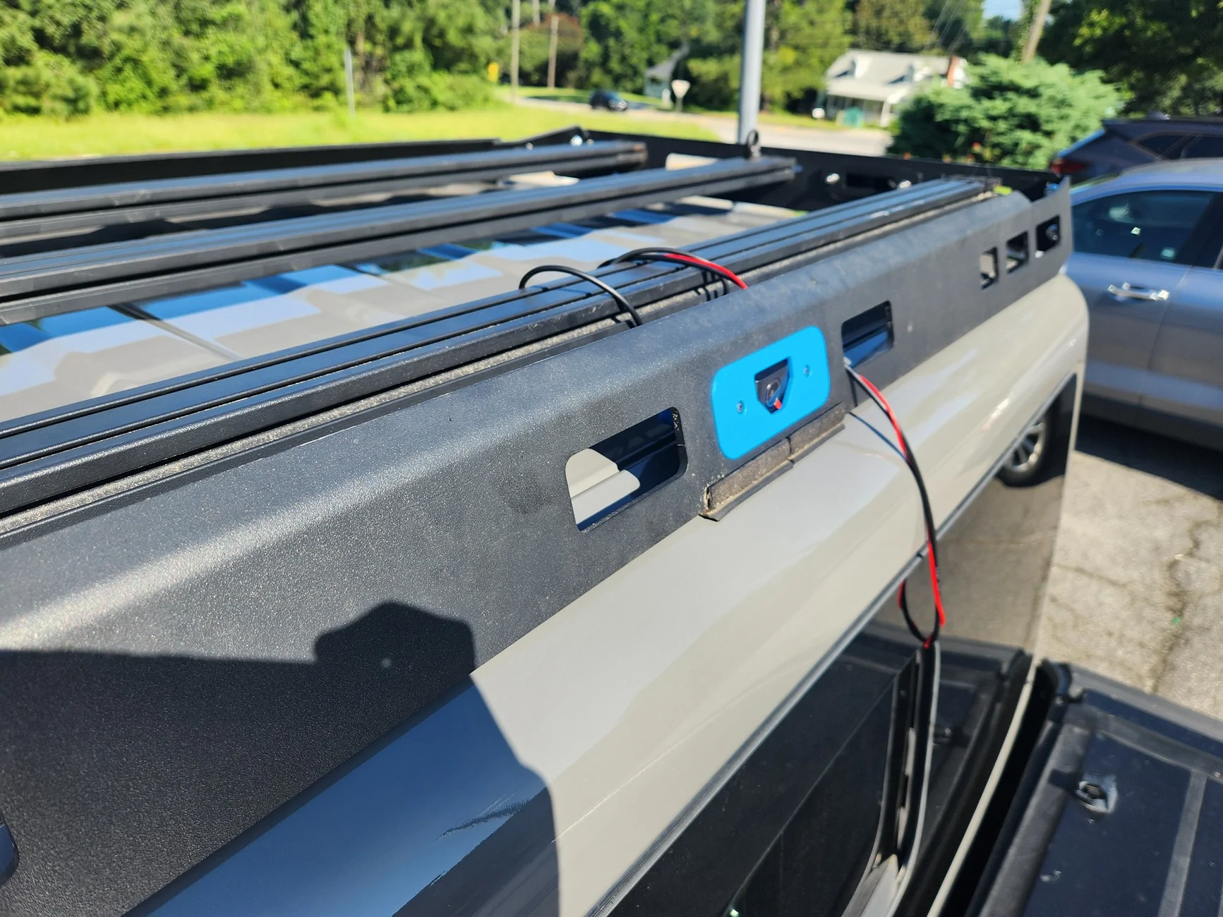

Next problem to solve is where to mount the rear cam. I already have a backup camera, and it works just fine, so I didn't have any reason to add another one the the bumper/tailgate. I recently installed a JCR Half rack, figured that might be a good place to mount the rear cam. So, like a completely normal person, I used some sticky tape and stuck it on the rack... wrong! I overanalyzed the fact that the way the stock mount works, it was either sticking out or sticking up or facing down and basically was hideous to me. That and I just imagined tree limbs or car wash brushes snagging it and ripping it off. So I noticed there is a perfectly centered hole on the back of the rack that would shield the camera from all of the things. So, like that sane and normal person I mentioned before, I made a simple mount with some angle aluminum and mounted it to the existing cross rails and called it done. Oh wait no I didn't, I shirked my responsibilities at work, spent days designing, printing, testing, redesigning, reprinting, retesting, etc... to end up with this thing.
Jeep Gladiator WOLFBOX G930 mirror install and fixes 1786157395149-cn
Jeep Gladiator WOLFBOX G930 mirror install and fixes 1786157442097-2d
Jeep Gladiator WOLFBOX G930 mirror install and fixes 1786157909102-wu
Jeep Gladiator WOLFBOX G930 mirror install and fixes 1786157969297-lm

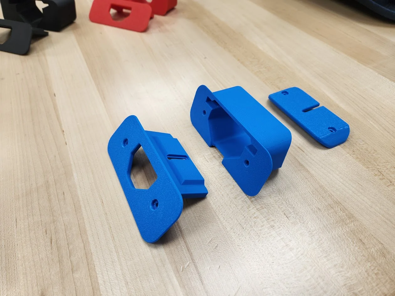

So this is where we are currently. A completely covered mount for an already water-resistant camera that already came with a mount. This is still a test piece, so this is just standard PLA that I had lying around. The final product will be ASA and will be black to match the rack. I will get this installed this weekend and will update from there. I think I already foresee an issue, but I will hold off on that for now. Wish me luck and feel free to ask questions, give suggestions, leave comments, or even make fun of the stupidity!

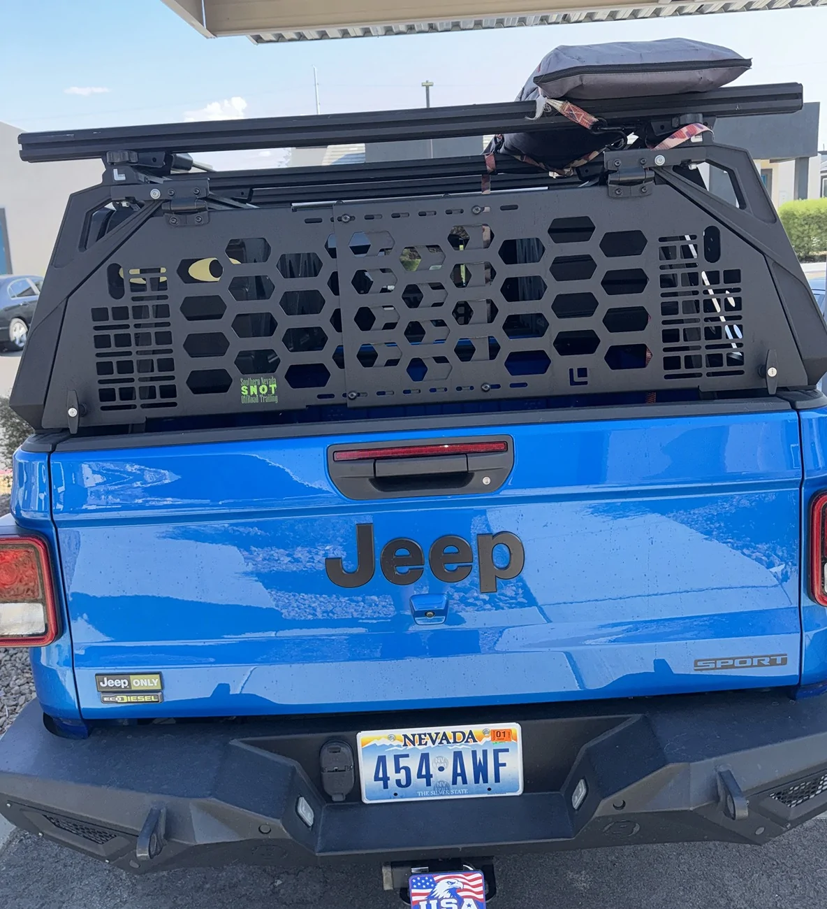

Just around the time Wolfbox was releasing this I bought the Stinger STR4K I placed the rear camera on top of the hitch out of the way. I still have a love hate relationship with it there and thinking of moving it up onto my rack some place. I just don't have the designing skills for the print. I have the printer, not the design skills. I also get a lot of headlight glare with it there.

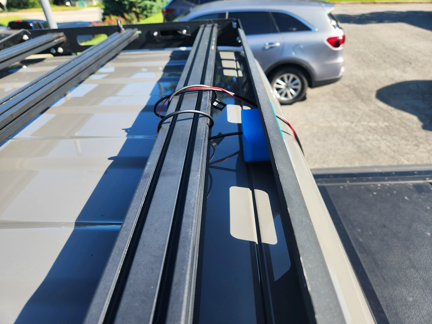

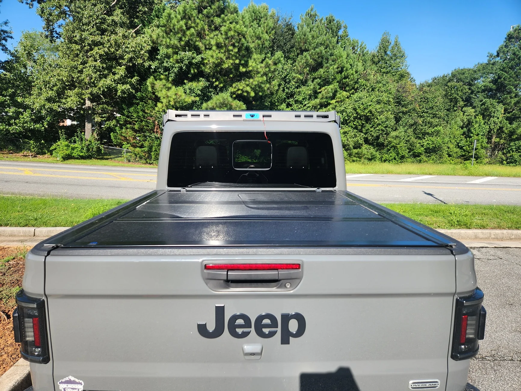

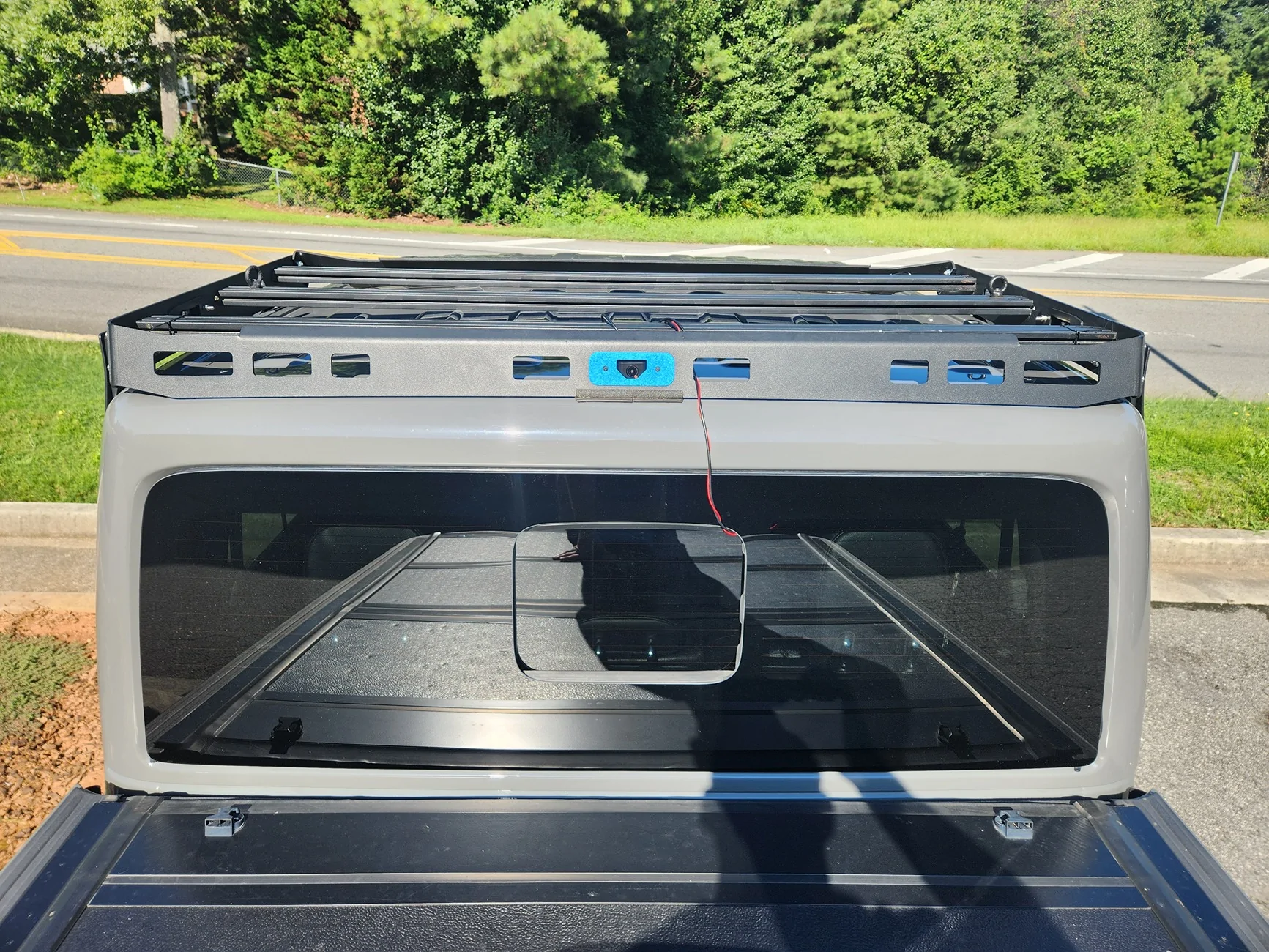

Got the prototype rear camera mount mounted today. Think it looks pretty good except for the color. I think I might go grey to match the body instead of black. Prob gonna try both once I finalize design. And yes will run the wires a little more cleanly for final install. Guess I'll have to add getting wires on the roof into the cab to the list of problems to solve in the future.
Jeep Gladiator WOLFBOX G930 mirror install and fixes 1000022100
Jeep Gladiator WOLFBOX G930 mirror install and fixes 1000022096
Jeep Gladiator WOLFBOX G930 mirror install and fixes 1000022097
Jeep Gladiator WOLFBOX G930 mirror install and fixes 1000022098

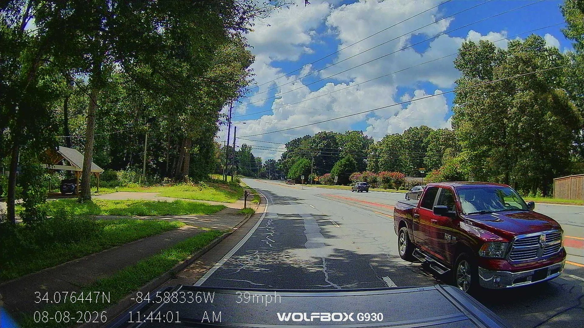

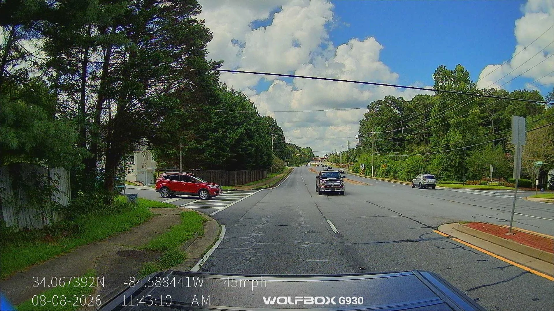

As for the camera itself. I love having it mounted up high. Gives a great view of everything behind including blind spots to the sides. Terrible for gauging distance while backing up but that's what the stock one is for. I think I might re work this mount so I can angle the camera down just little more. Would be nice to have the option to see cargo in the bed as opposed to so much sky. When you are looking in the mirror you only get a section of these full pics so couldstill adjust to watch the rear and then just scroll to see the bed.
Jeep Gladiator WOLFBOX G930 mirror install and fixes 1000022104
Jeep Gladiator WOLFBOX G930 mirror install and fixes 1000022106

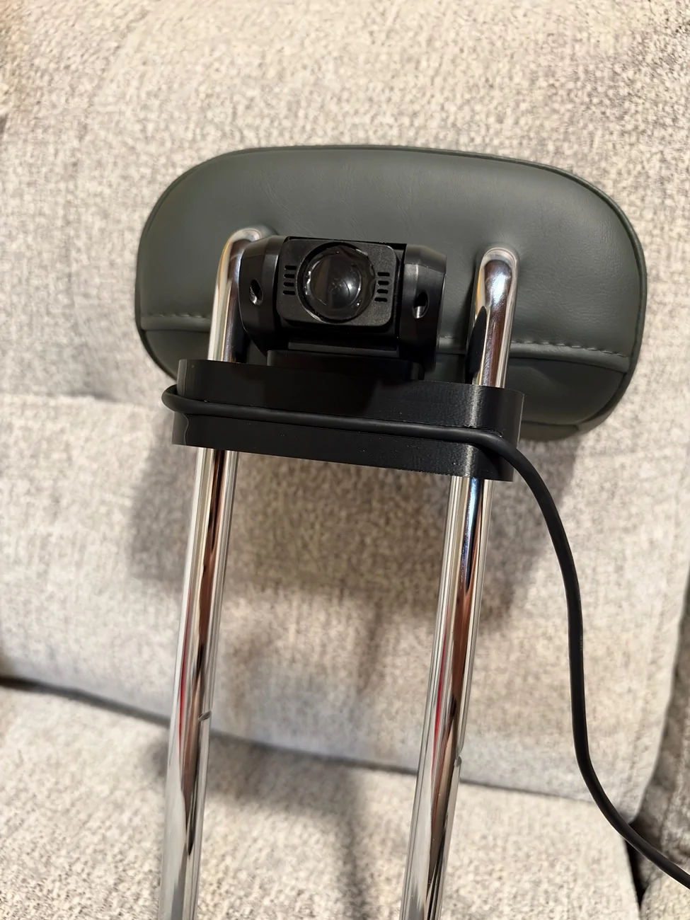

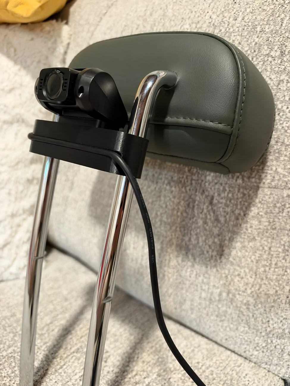

I don’t have the same camera, I have a VIOFO a129 pro duo but I also wanted a way to mount my rear camera without having to disconnect it from the hard or soft top since I switch back and forth. I just printed a little bracket out of ASA that went between the head rest bars and points backwards. All the clearances look good now I just gotta test it out this week.

That bracket looks great. How is the picture/view?
