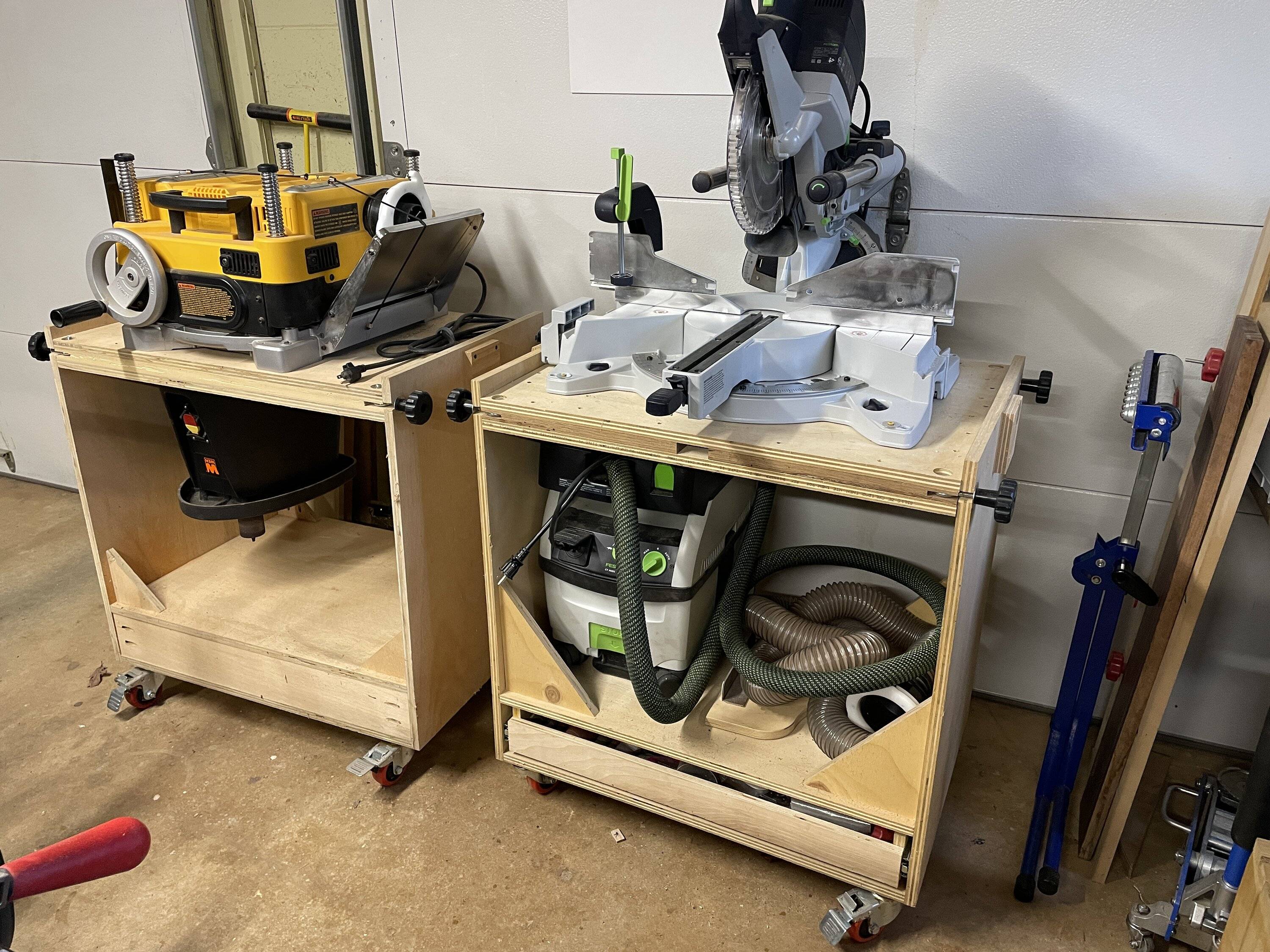

I have two flip carts, one with my planer and spindle sander, and one for my miter saw. They are a great use of space.
10’x10’ is pretty small. How high is the ceiling? Any chance of using a pulley system for storage up high? My current house only has 8’ ceilings so I have no high storage, but we are moving to a house with 10’ ceiling soon so I may be able to utilize some of it.
I’d love to see pictures of the flip carts. I built an extension off of my table saw years ago in order to have a routing table as well. That combo gets nested over the welding table usually, or over the metal cutting bandsaw. The drill press just takes up space, but I love it so much that I don’t care. I’d love one of those combo grinder/sanding wheel/belt tools. That would make a monster difference for projects. As much as I’d love a wood bandsaw, I just don’t know where it would go. I end up doing weird cutouts by hand with an oscillating tool. The miter saw gets a ton of use.

I bought the plans online. They are very convenient for saving space. I had a scroll saw mounted under the miter saw until I bought another dust extractor. I never used the scroll saw anyways.
Jeep Gladiator Woodworking suggestions needed IMG_6583
That's pretty sweet.

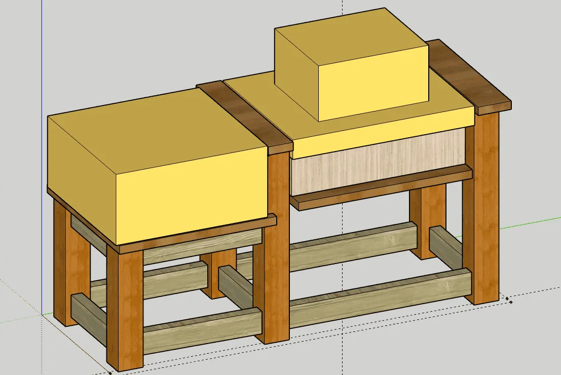

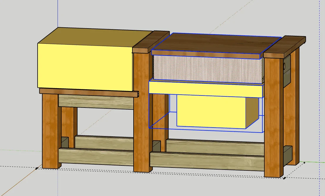

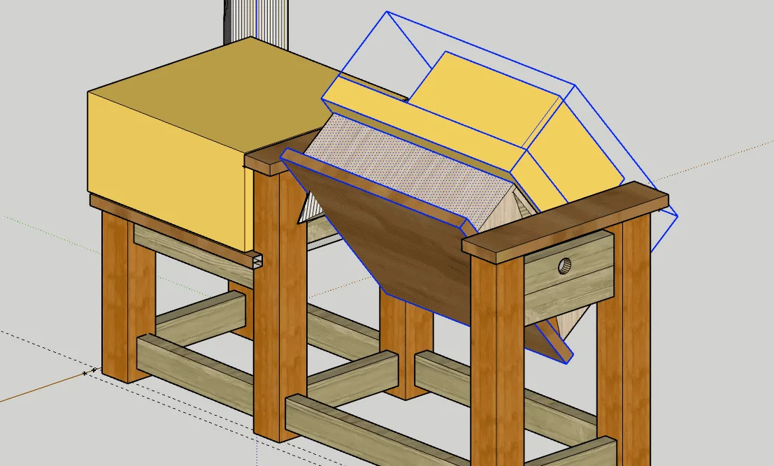

Here is my idea. It's 6' long, 28" wide. So I can use the winch to pull it out of the basement as it will fit through the door, if I move it to a shop some day. The yellow blocks are mockup's as a table saw and miter saw placeholder. The miter saw is held in place by some slide locks and sits on a polished brass 2" tube so it fully rotates. The top edge will be a butcher table so it should be thick enough for some dogholes and track extensions for the table saw. The left side of the table (if your looking at the table saw) will have a 2 or 3 foot fold up butcher block table extension for ripping larger sheets of plywood or longer pieces of wood stock. Then a second table will be the same dimensions to hold a plainer that will rotate like the miter saw, and a router. I think I'm just going to make a jig that will effectively turn the table saw into a jointer.
Then I will have to make another table that can fold up agains one of the walls to hold a CNC machine. I'm planning on starting a small, in my spare time, business for wood products and photos so I can take those proceeds and donate to a few charities and groups that do good work to help the less fortunate.
Jeep Gladiator Woodworking suggestions needed Screenshot 2023-11-29 at 15.06.25
Jeep Gladiator Woodworking suggestions needed Screenshot 2023-11-29 at 15.07.48
Jeep Gladiator Woodworking suggestions needed Screenshot 2023-11-29 at 15.08.22
Oh and I plan to have the whole table held together by old school methods - probably dowels to make it easier, so no screws or nails, just wood and glue.
Cool. So the top plywood sandwich just pops out and flips? Genius. I’ll build one for my drill press and a bandsaw. It’ll be 13’ high. I’ll need a ladder to use the top tool. Totally reasonable.
