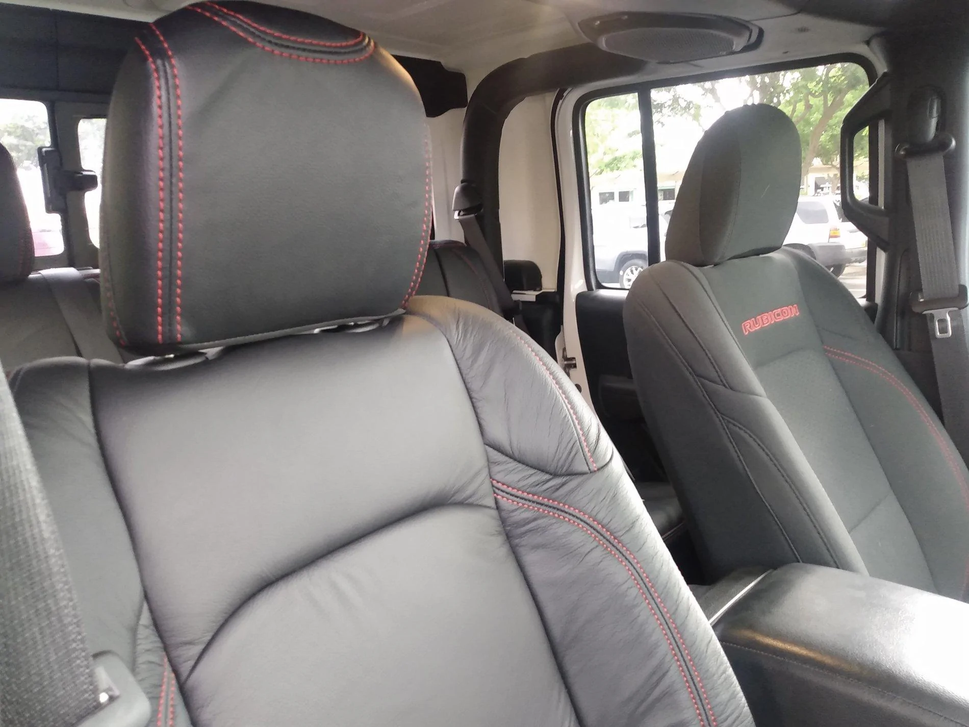

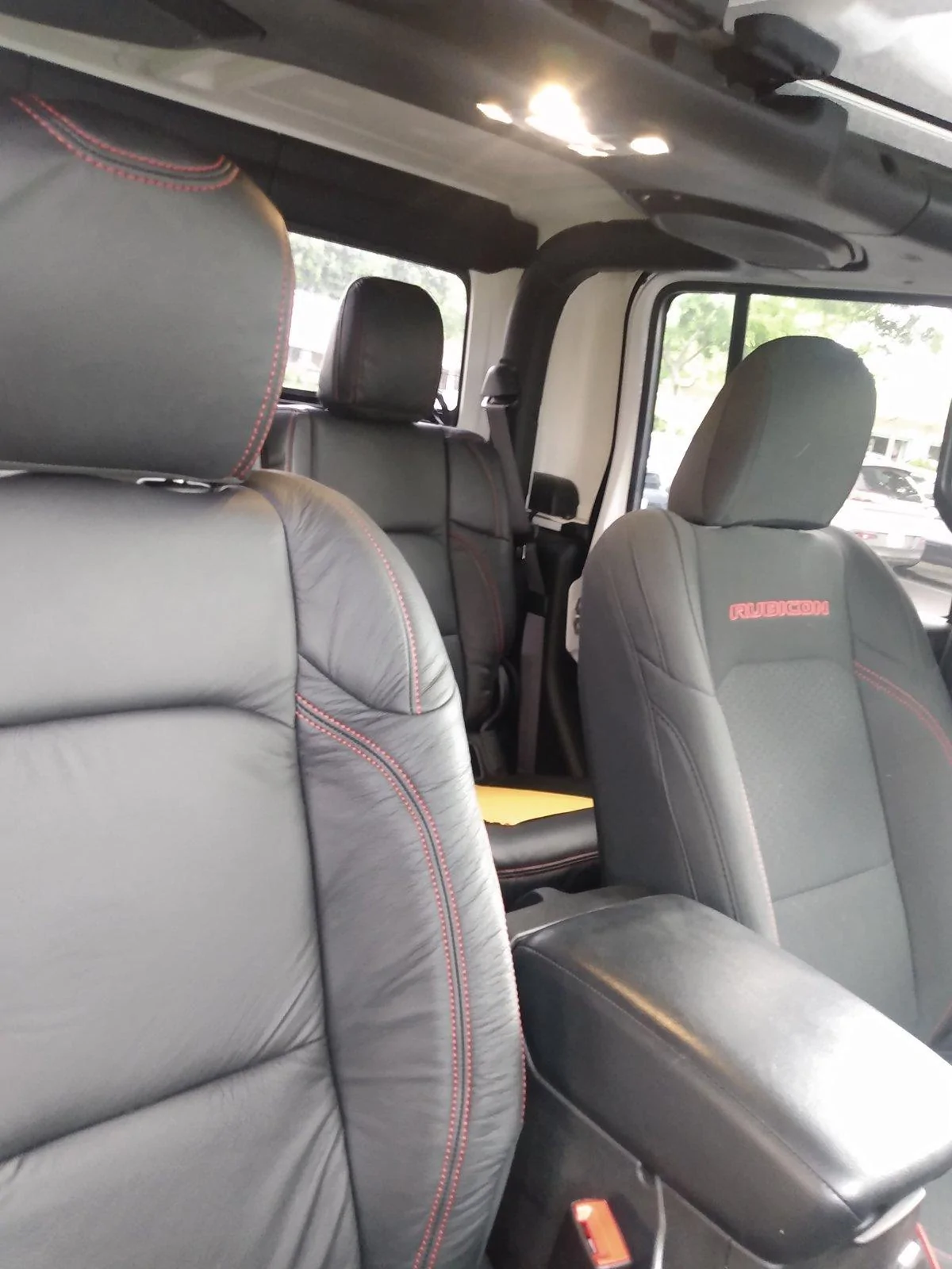

The leather is just so much better.
We debated getting the Rubicon embroidery but didn't. I don't have strong feelings either way but I'm happy with the almost final results.

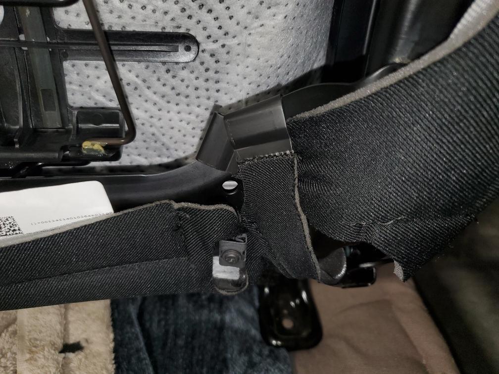

The way these two clips are crossed is important. This is at both lower corners of the back side of both front seats. If you don't memorize it or take a picture you will not remember how it goes when it's time.

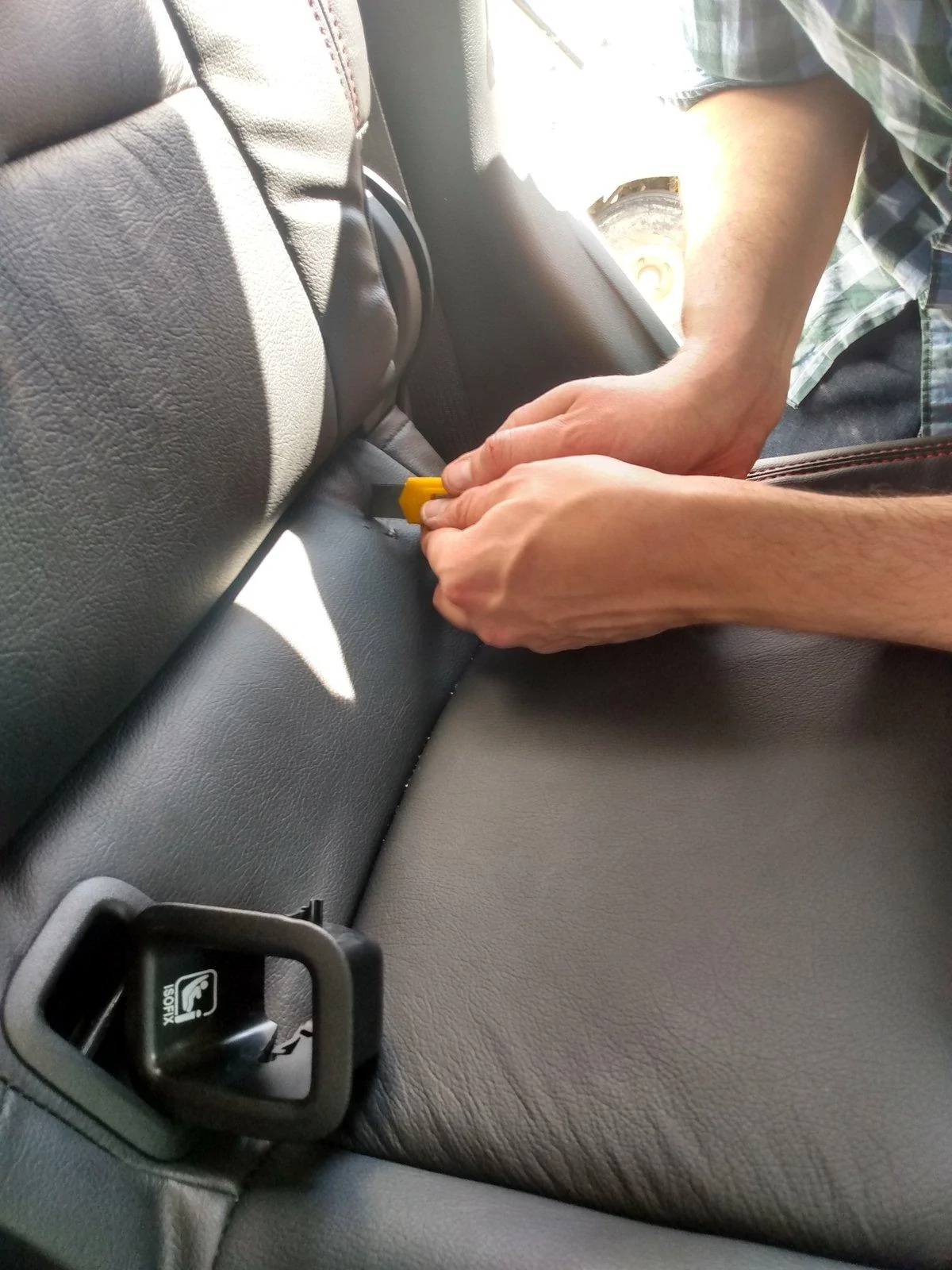

The baby bracket cups unclip from the bar that runs through them. Shine a light in there and you'll see.
You have to cut your own holes for them - you'll end up cutting a lot of your own holes. Have a good sharp box cutter and don't cut until the leather is in place.
