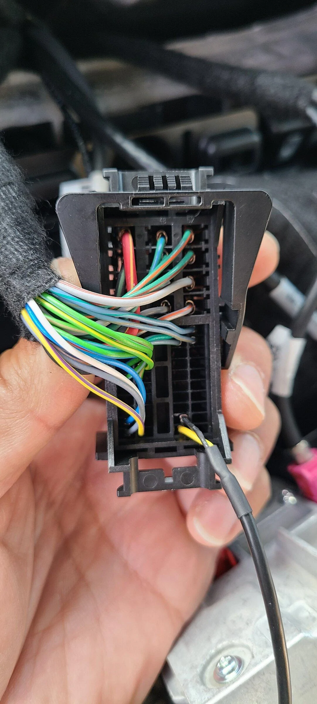

I installed the Z Automotive front facing camera on my 2021 JT High Altitude today. The instructions say to put the new pig tail connector in spots 21&22 on the UConnect harness. The problem is, is there are already wires in those spots. I'm not sure if this is specific to the HA edition or if anyone else has run into this problem as well on other models. Any help would be greatly appreciated!

I thought the same too originally. I can't explain it the best but It's because you are looking at the plug straight on and comparing it to the diagram when in fact you have to look at the plug from the backside and compare it to the diagram. Then, you will see the two empty slots because now you are reversed.
Jeep Gladiator Z Automotive front facing camera problems 20211202_095634

You are 100% correct. I was looking at it from the wrong side of the connector. Thank you so much for your help!

Haha I knew that picture would come in handy hence the reason I took it.
