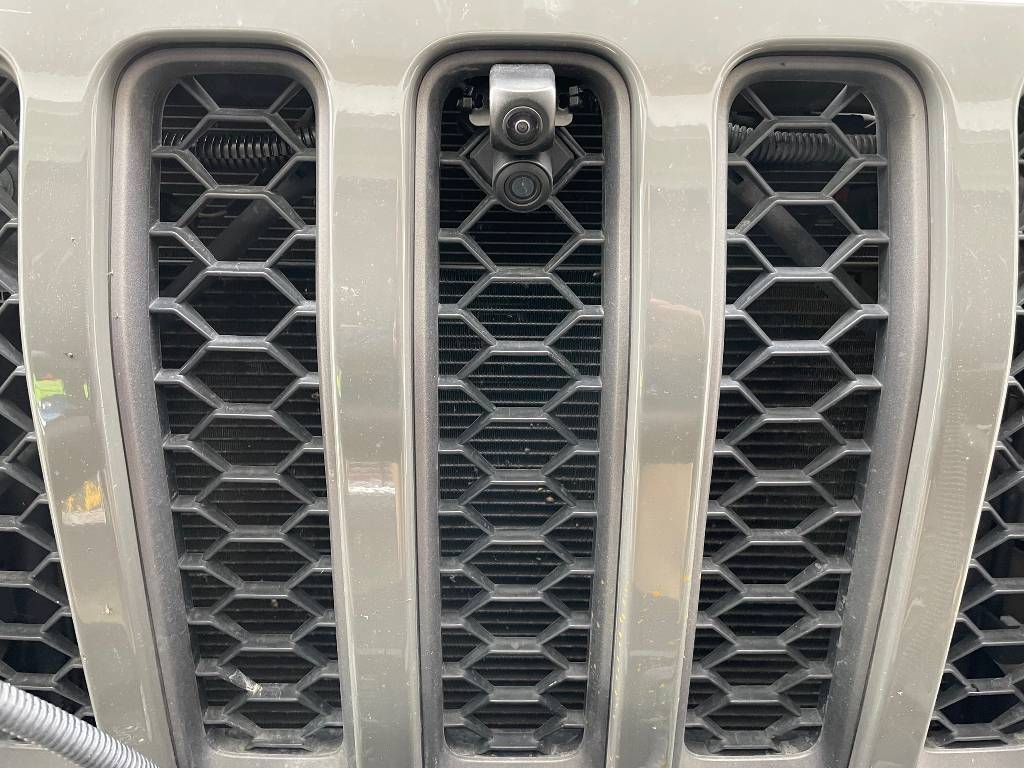

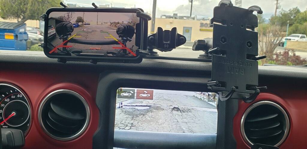

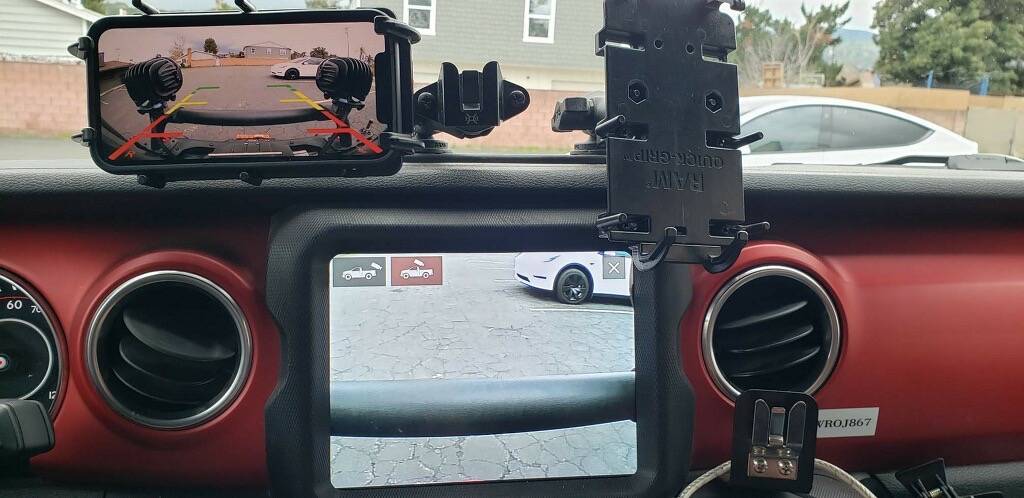

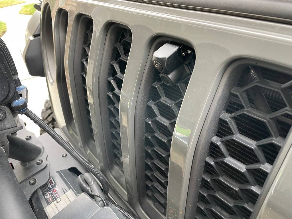

Not sure why anyone would go through the headache and expense of retrofitting a hard wired front camera after this
I purchased a GreenYi 5G wireless Wi-Fi camera from Amazon. Install took about an hour and could have taken much less, but I tend do chase squirrels…lol. At some point I may correct the angle a bit due to a touch of OCD, but it’s damn close. So, I was out < $60 and have a camera with fully adjustable guidelines…through wireless technology…less a power and ground wire. The ground is run to one of the numerous fender ground posts and the power is ran to the cigar lighter switched power fuse in the fuse box.
The last 2 photos where from a horizontal screen, which were too large of files to upload so I screen shorted them in portrait mode.
