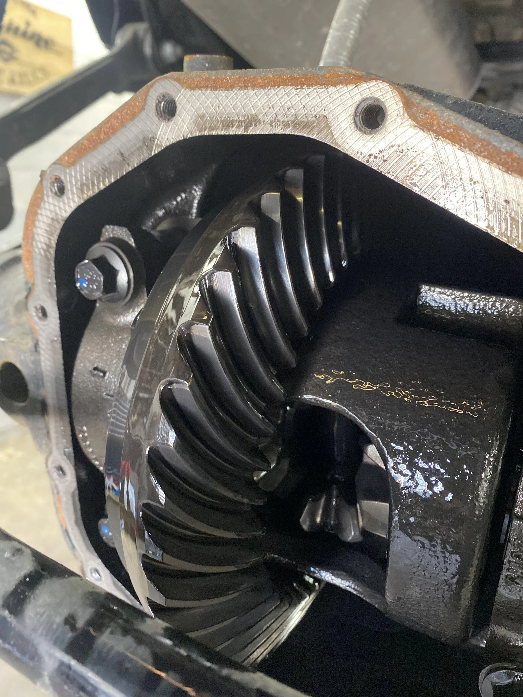

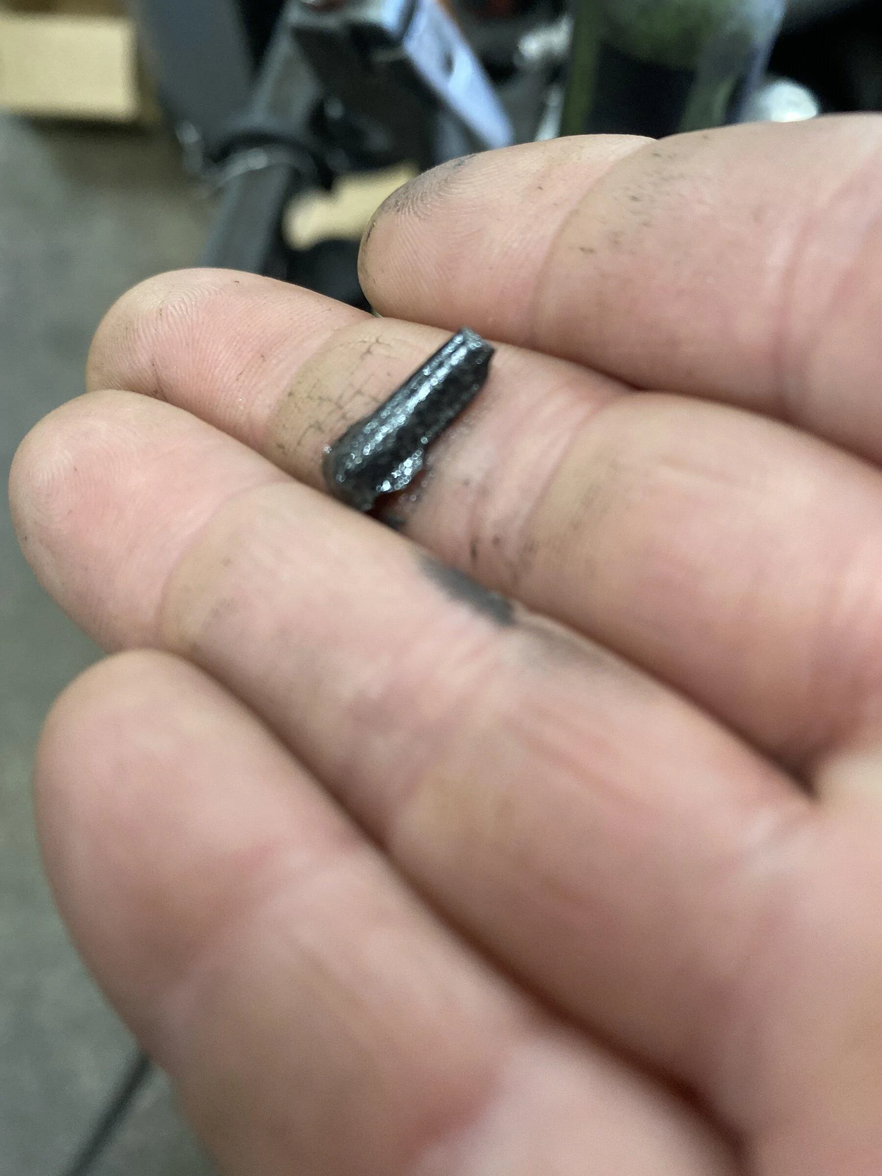

I dropped off my 2021 Willys JT for a lift and differential cover change. I have 7,000 miles on it. The installer called me to report finding a chunk of metal caught by the magnet. See picture. There doesn't appear to be damage to the gear teeth. I've never seen that, nor has his shop. It does bring to mind that I occasionally hear a sound from the area of the rear differential, but never isolated the sound. My installer thinks it might be cast iron from the housing, but can't tell where it came from. I'm not really sure what to do going forward.

It does sort of resemble flashing - but I'm sure you've already done or determined, have them go over that thing with a good light and good eyes, into every nook and cranny. Had that gotten wedged into a gear, I hate to even think..........

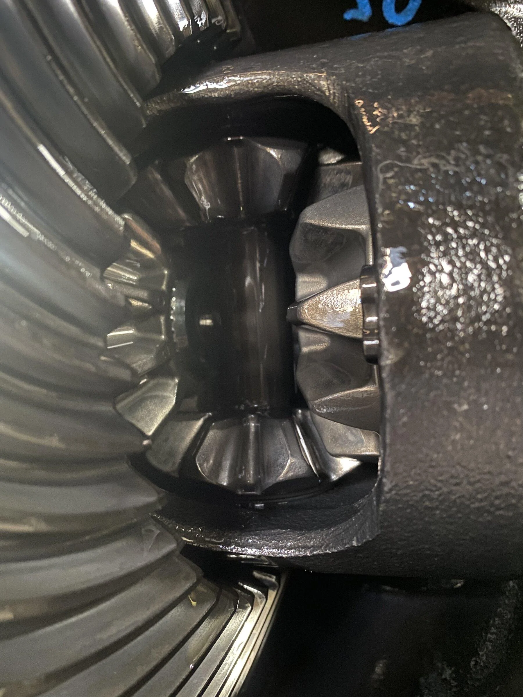

I actually just had my rear dif fluid checked and they found the metal in the fluid, as well as a "large chunk". They ultimately replaced the rear gears and guts under my extended warranty. Thankfully I have the extended warranty our it would have been a pricey find. The truck was asymptomatic when I went it and they found the problem during a routine mile based service. No idea where the metal came from.

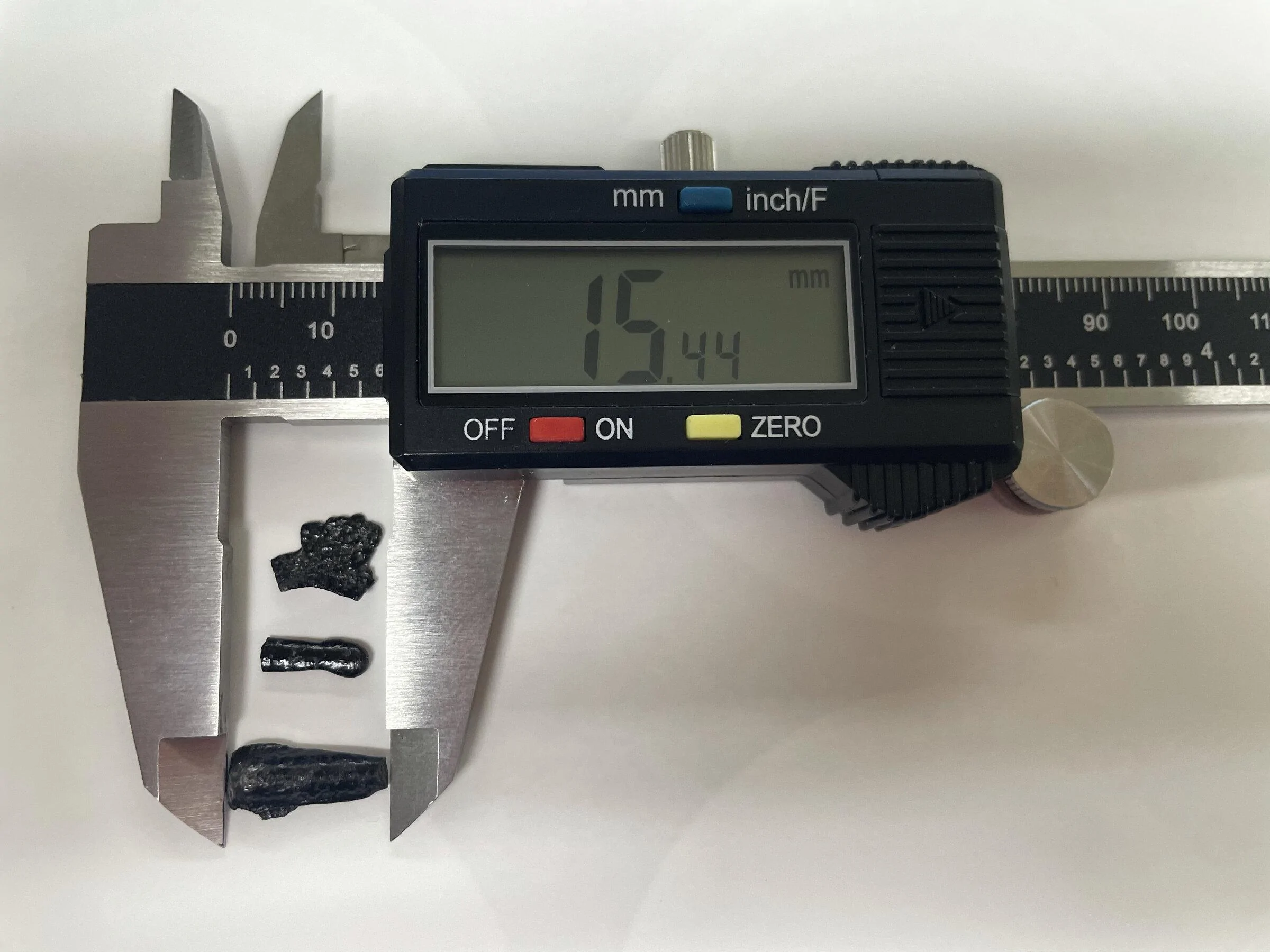

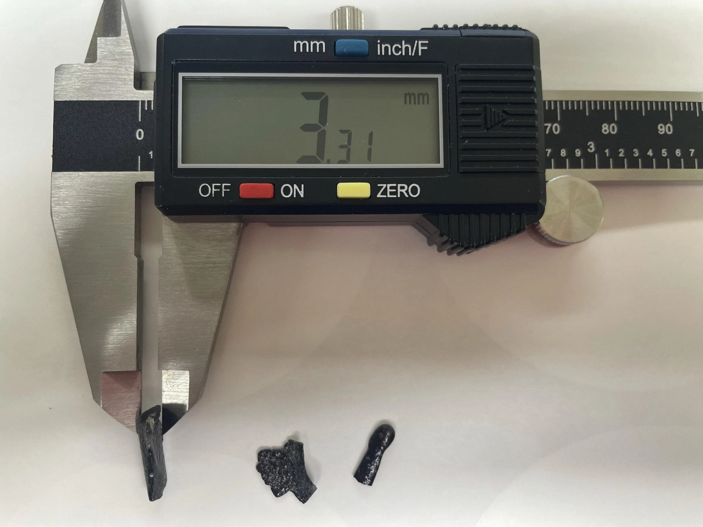

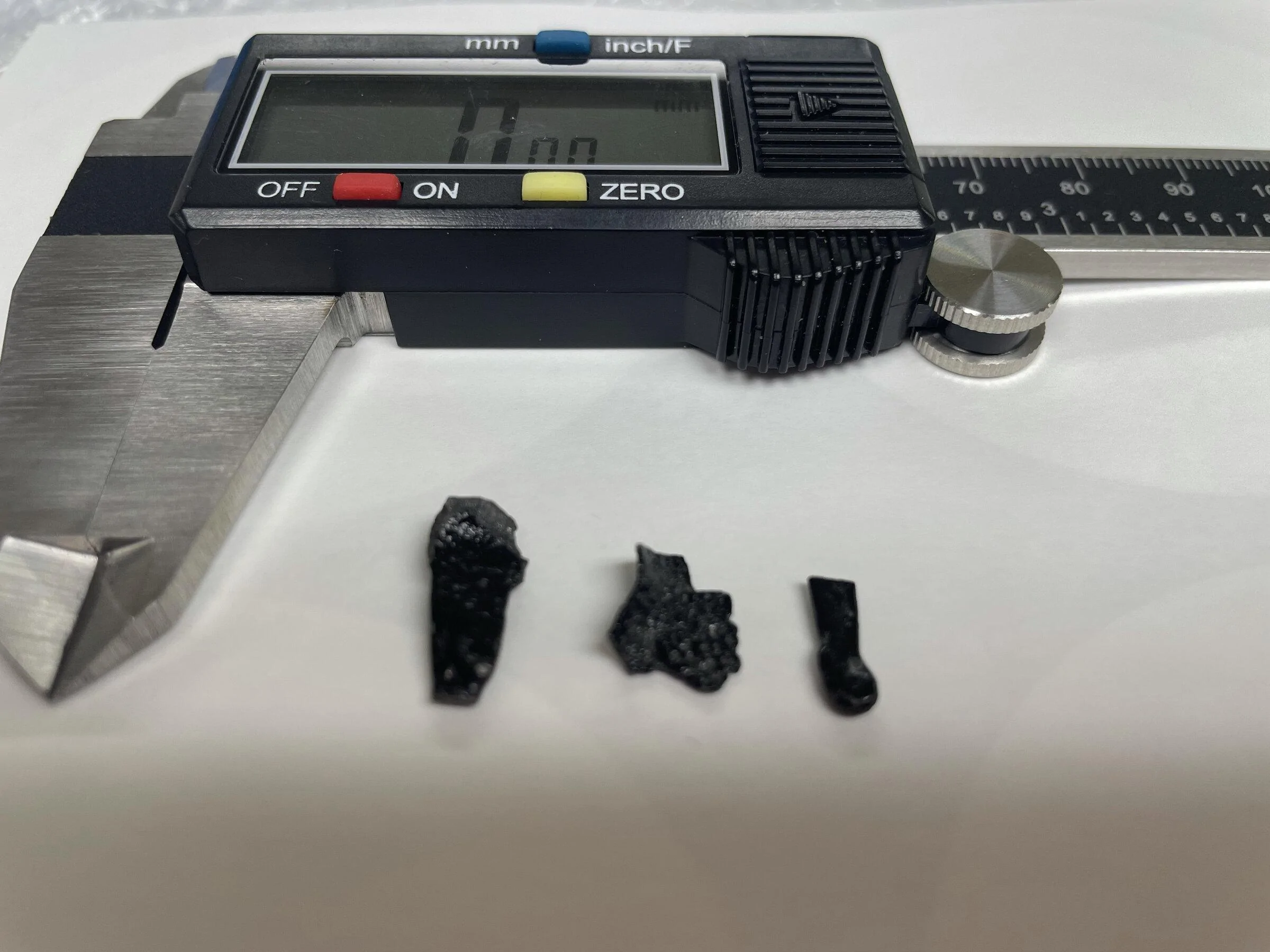

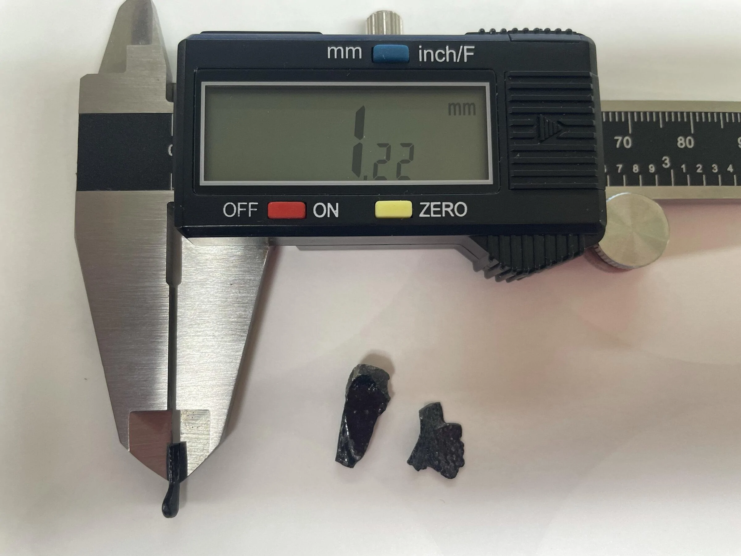

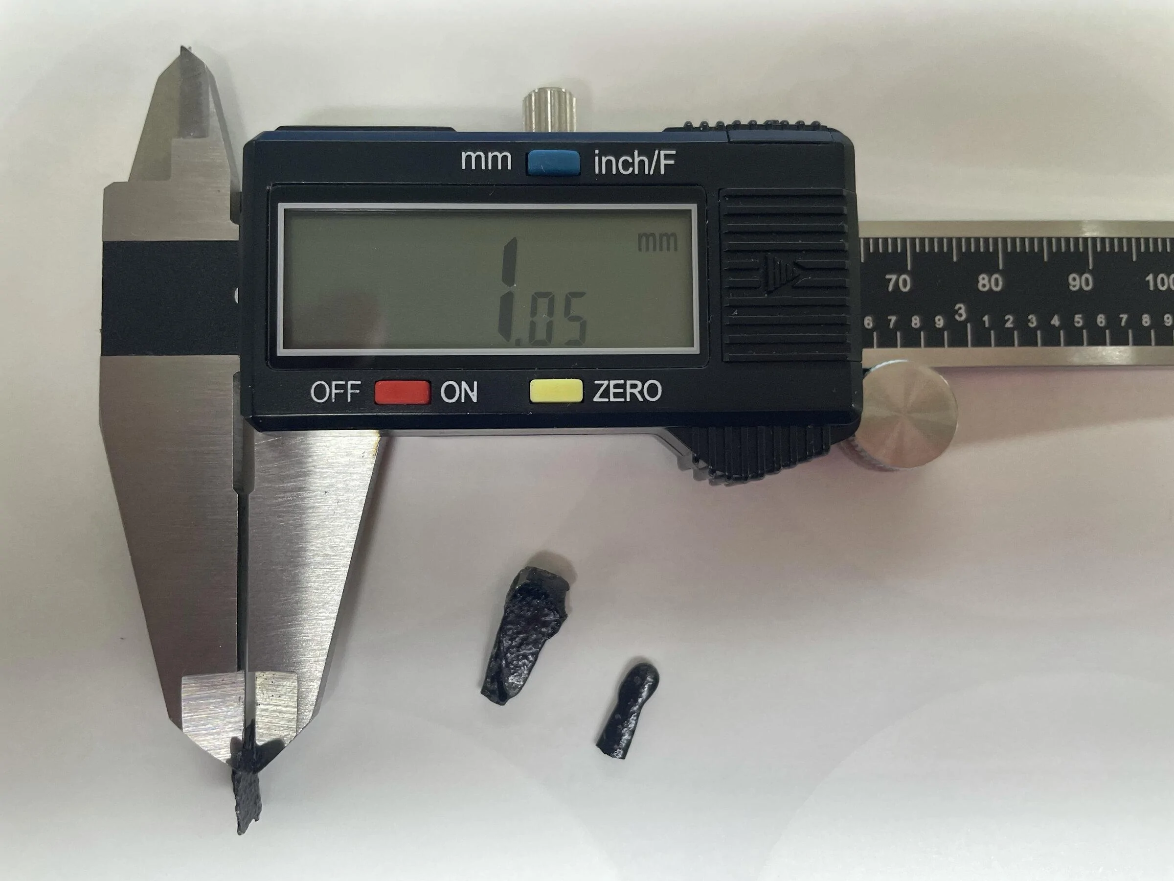

Attached are pictures of them with measurements. The three pieces are each metal and attracted to magnets, if that matters.

Definitely look like remnants of the manufacturing process - casting debris, flashing type stuff. That's really sloppy to see that in there, scary, IMO.
Poor quality and that’s not good too see, sorry, man.
