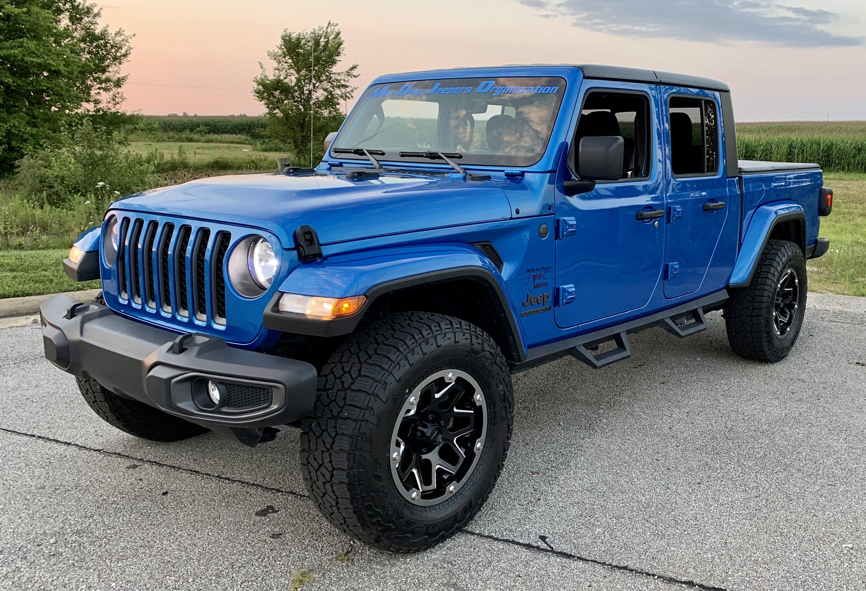

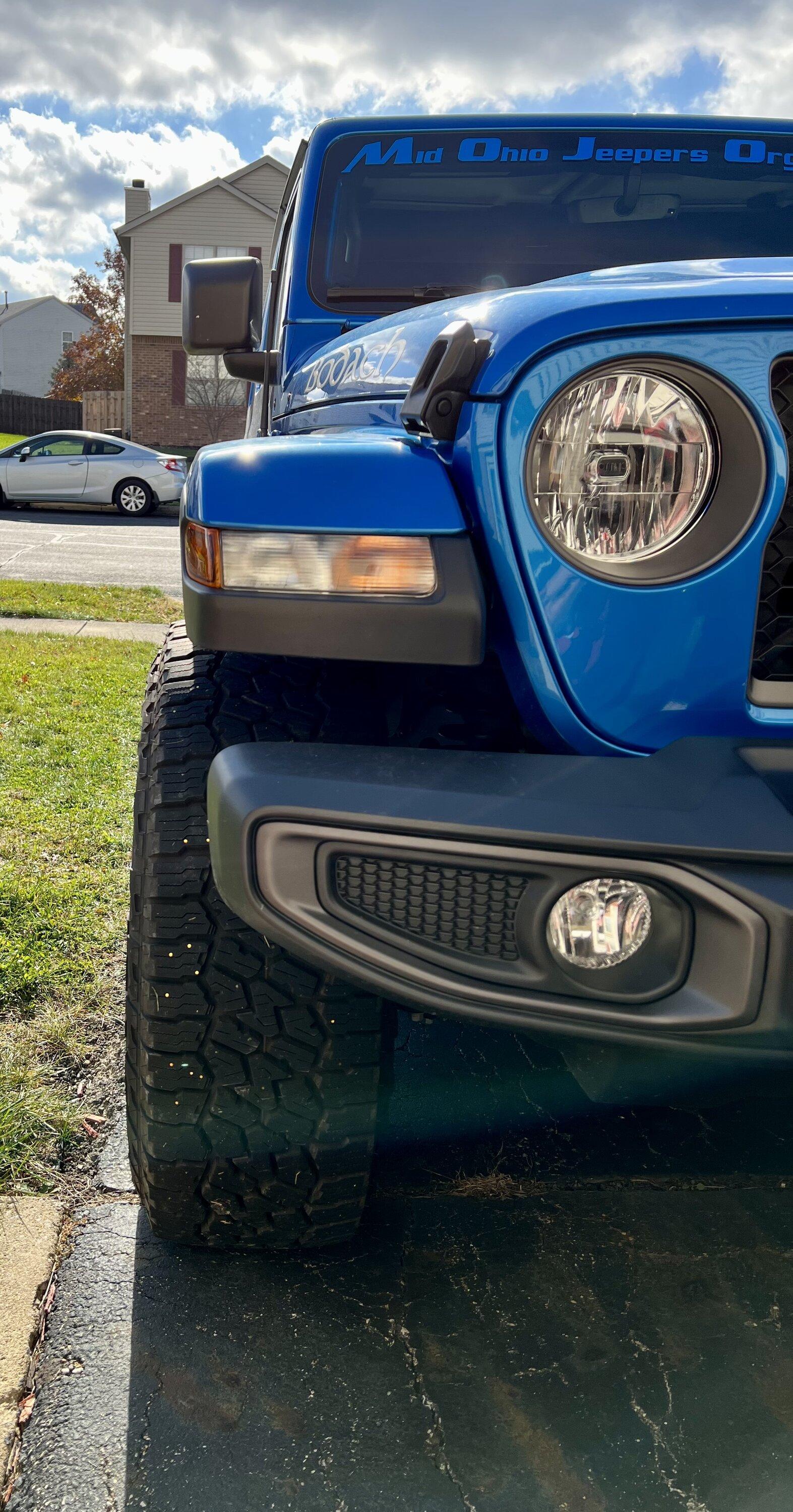

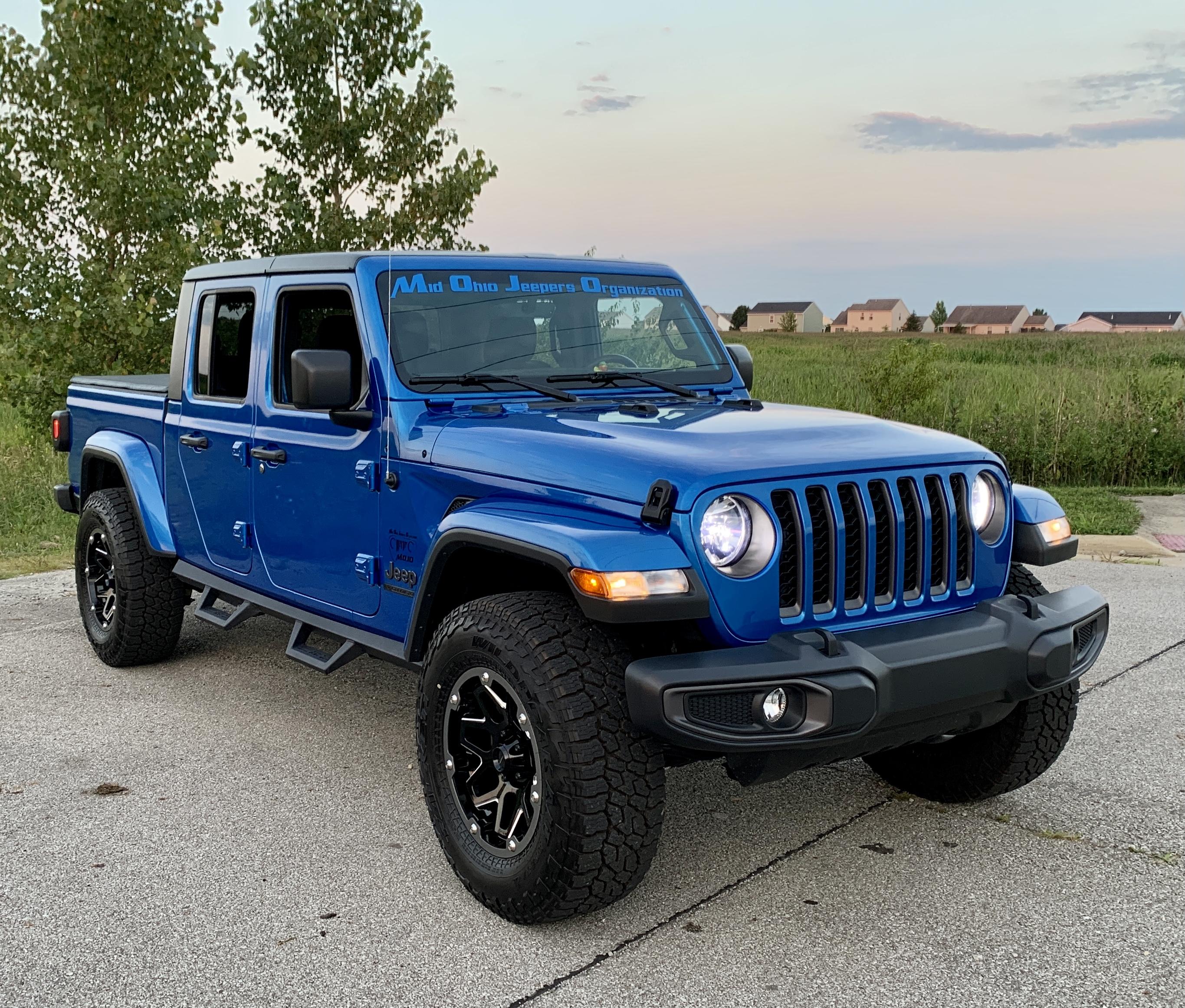

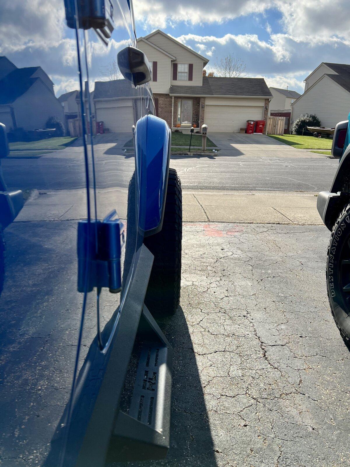

So maybe this will help you decide or give you a comparison.
I’ve got 18x9 with a +12 offset Vision wheel with Falken Wildpeak 295/70/18s mounted on them.

These are on my 80AE with only the Teraflex 1.5 leveling kit.
Also, for reference, my 295s are considered 34s, yet mounted measure 1/4 inch taller than my daughters 315/70/17s.
