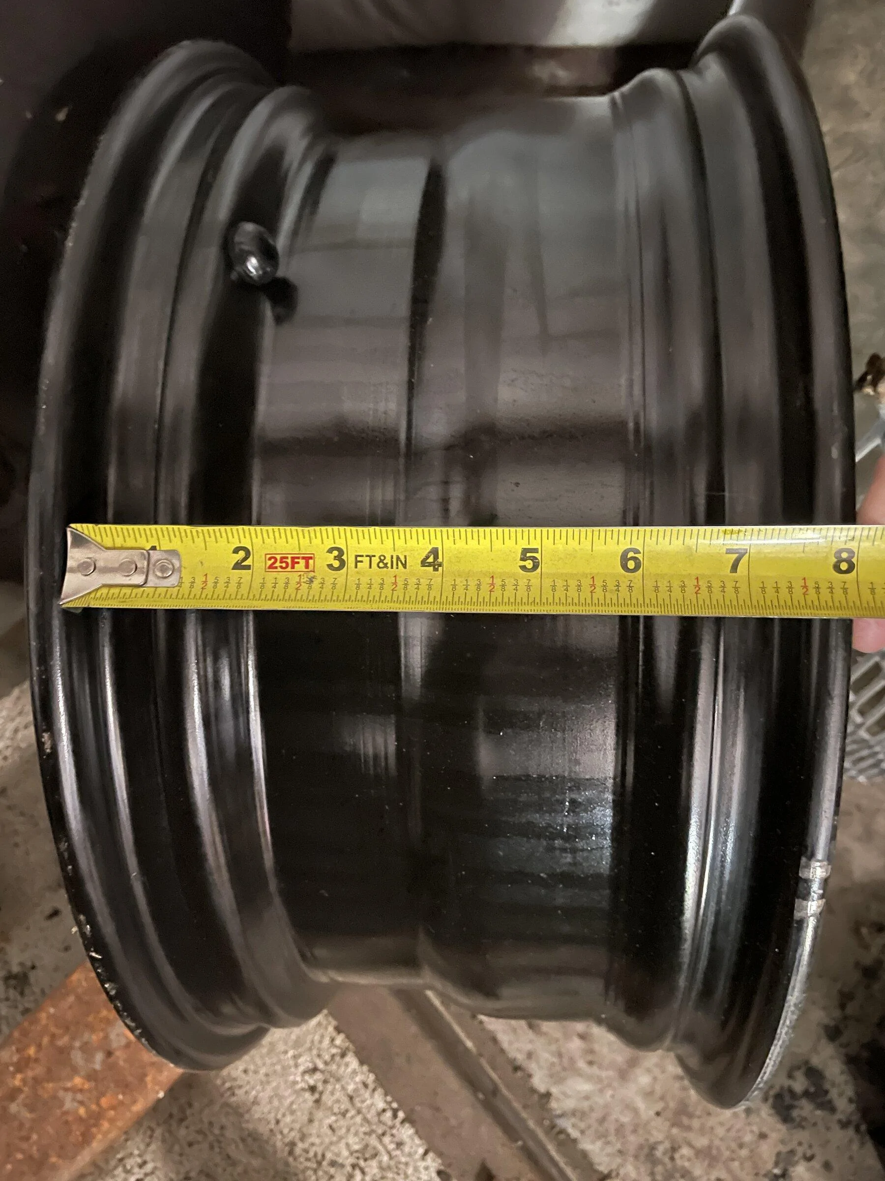

Oh! I've got a spare spare rim (rim) without a tire mounted. Lemmie go measure...
Assuming wheels are measured from the inside of the rim, it's 7.5.
Yes, that would be correct - inside where the bead sits against the "rim". Looks like 7.5"

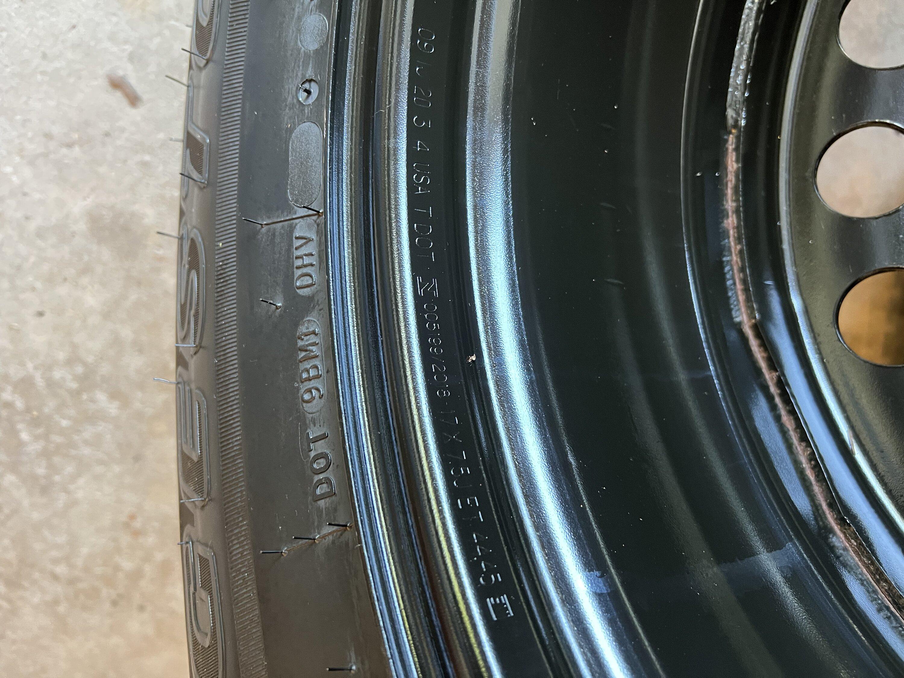

are you able to measure the offset? I am curious what spacer size I will need to fit after the lift i think I will need a 2" spacer.
Lunentucker
Apr 24, 2022
5,873
15,381
2021 Jeep Gladiator Mojave
People Work?
Check the surface of the backside of your rim. Size and offset is stamped into the stock 4 rims, so it may be on the spare as well.
