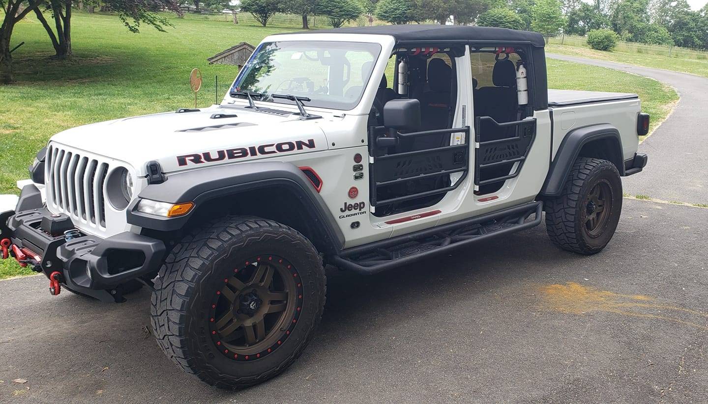

I have a 2020 Rubicon with all stock lift. I put 35x13.50R20 Nitto Grapplers on Fuel wheels with no clearance issues at all.
Jeep Gladiator 2020 Gladiator Rubicon - 1.5 Teraflex leveling kit -Factory Rims - Accessing larger tires 240809307_4546429792043629_6718234385865627537_n

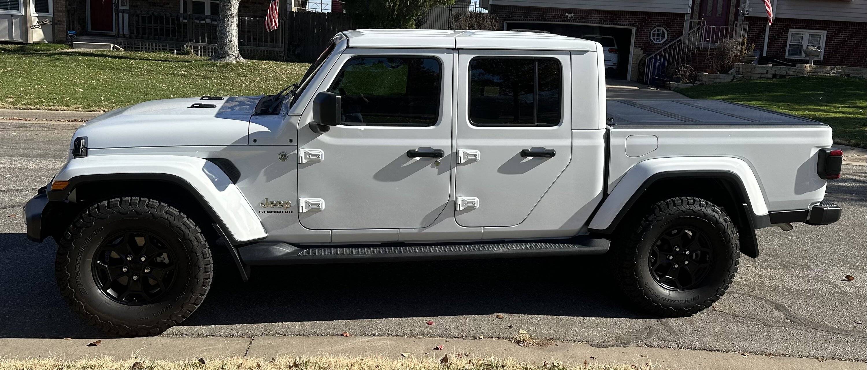

35 X 12.5 X 17 on stock rims. No clearance problems but rubs when cranking the wheel hard.
Jeep Gladiator 2020 Gladiator Rubicon - 1.5 Teraflex leveling kit -Factory Rims - Accessing larger tires IMG_4984[1572]
