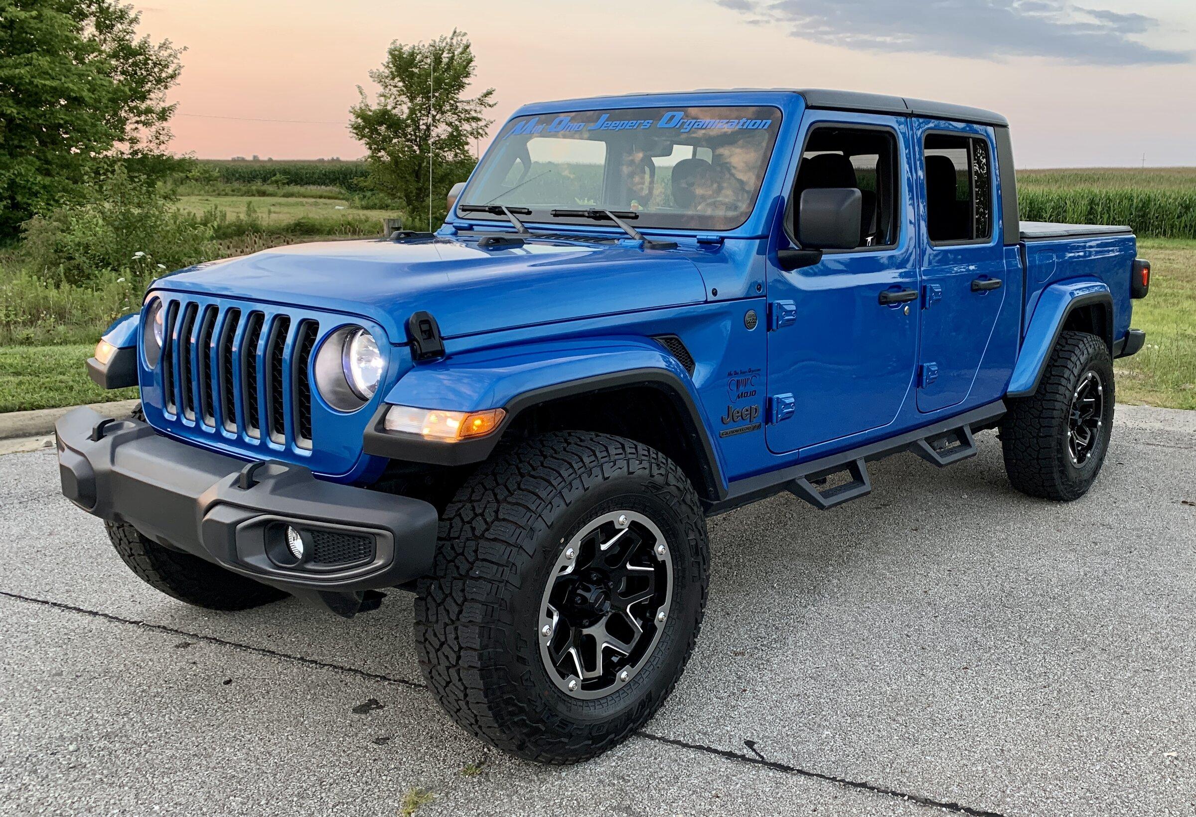

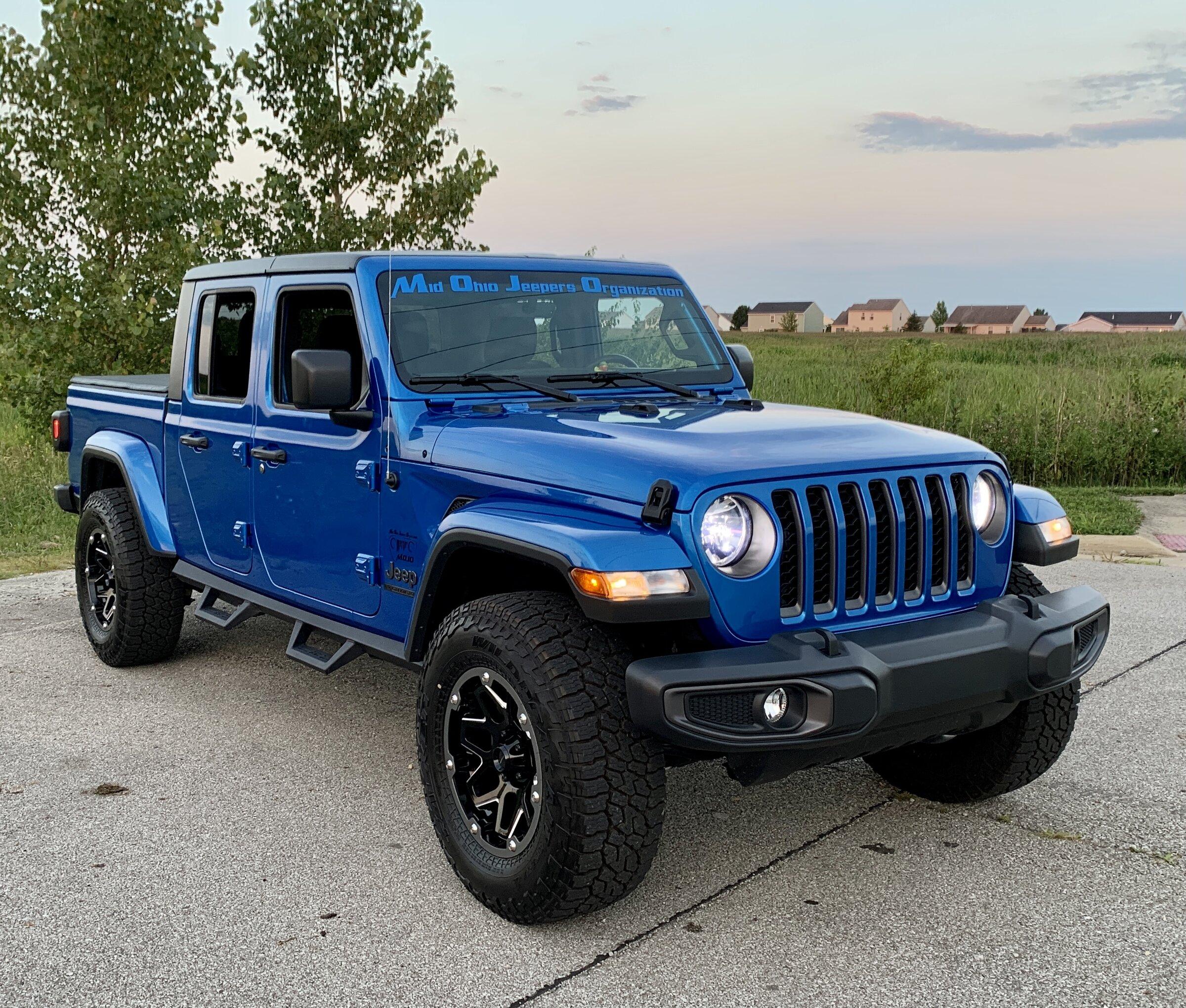

This may help you a little, though not exactly the size in question.
Mine is an 80AE. Added the Teraflex 1.5 to the front. The tires are 295/70R18 which is a 34x11.5. They do stand just a touch taller than the 315/70R17 on my daughters JKU.
Jeep Gladiator Tire setup recommendation(1.5 front spacer leveling kit) F9AD8102-9714-4C29-91E3-7265234FA036
Jeep Gladiator Tire setup recommendation(1.5 front spacer leveling kit) 68F34026-98FC-4C33-946F-0A1726280425
Jeep Gladiator Tire setup recommendation(1.5 front spacer leveling kit) 702C1E09-B684-4C6D-81DA-61FDD8959556
Note that my 80AE seemed to set really low in the front before the spacer. I measured about 2.5 inches of rake. So if yours has less, then you should get more clearance than I did.

Thank you for pics. Good looking truck.
No mod or rubbing issue?
I might go same setup as yours.
Only real mod is the 1.5” spacer. I also added the Mopar lower control arms just to add back some caster and help it handle a little better. No rubbing on full left or right. I don’t ride any trails that require extreme articulation, but for minor trails they clear fine.
