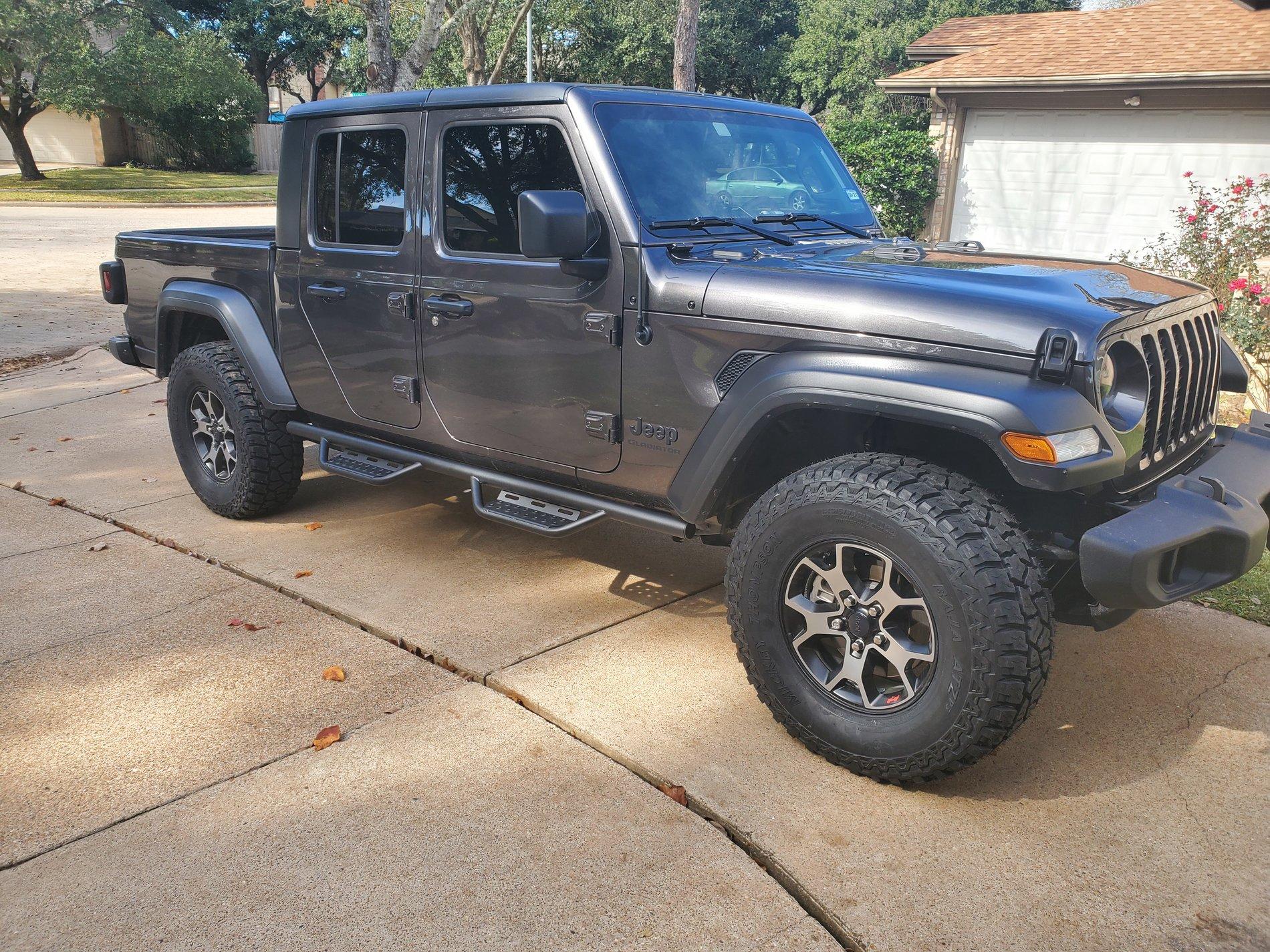

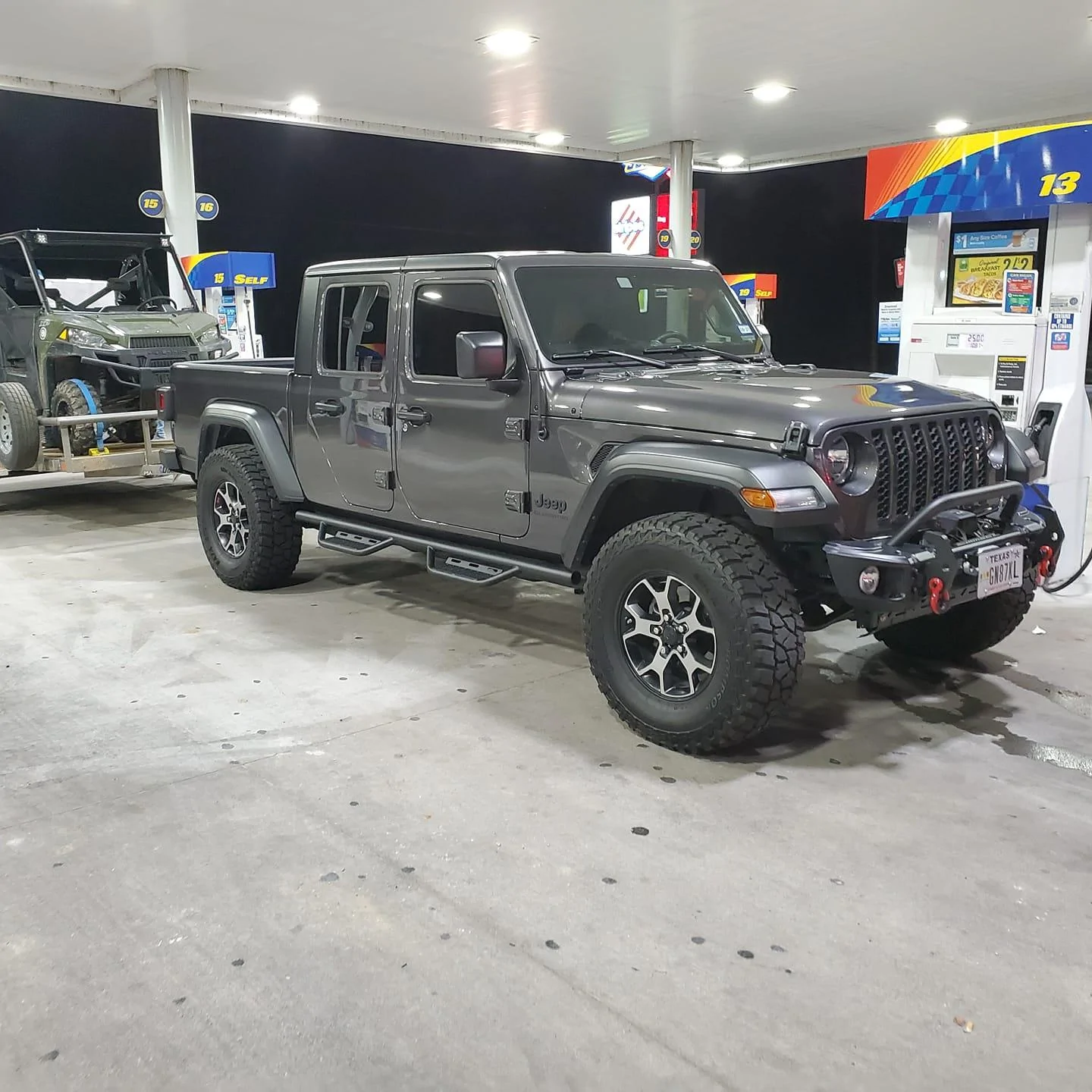

I am running them on stock Rubi wheels, 7.5 is the minimum width listed on my tires. No issues here.

Mickey Thompson Baja ATZP3 315/70r17. Website list 8 inch as minimum, Discount Tires data says 7.5.... Running on JLRT factory wheels 17x7.5

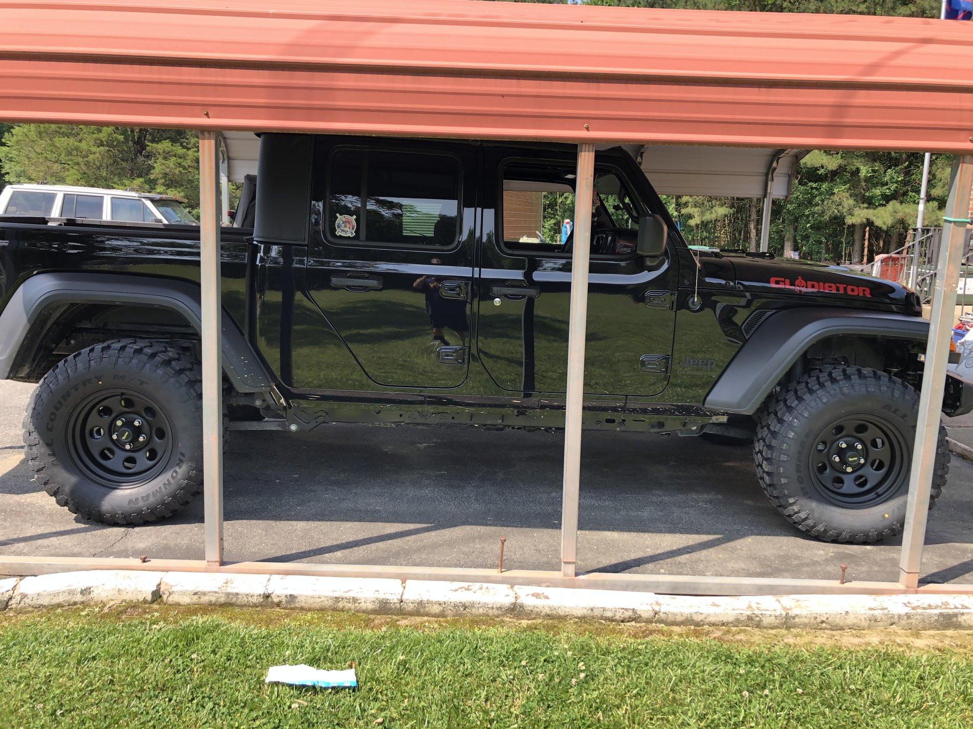

2.5 inch RC lift front no shocks and 1.5 in pucks in rear rusty off road and 315s 35" front damn taken out and cut down to match bumper and to cover the fog lights no rubbing anywhere

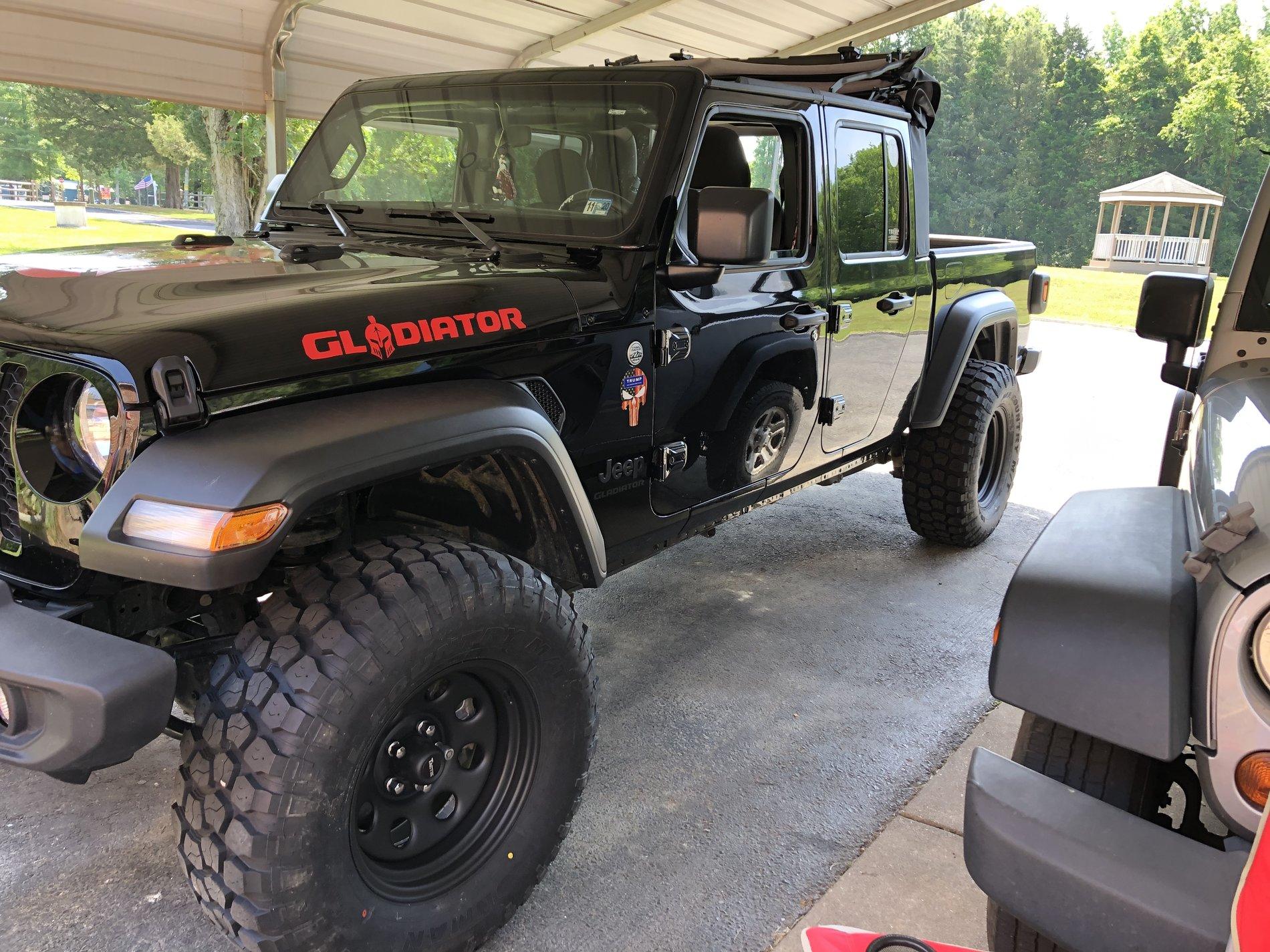

Here is my Sport with 1.5 inch Daystar spacers on 315s (35s) I had to remove to inserts between the bumper and fender (ended up putting a Rugged Ridge Arcus on anyway), but they fit just fine.
Jeep Gladiator 35x12.50-18 tire fit with 1.5" Teraflex leveling kit? 473ADA9E-B108-43CA-858E-24393F1BCA7C.jpe
No lift?
