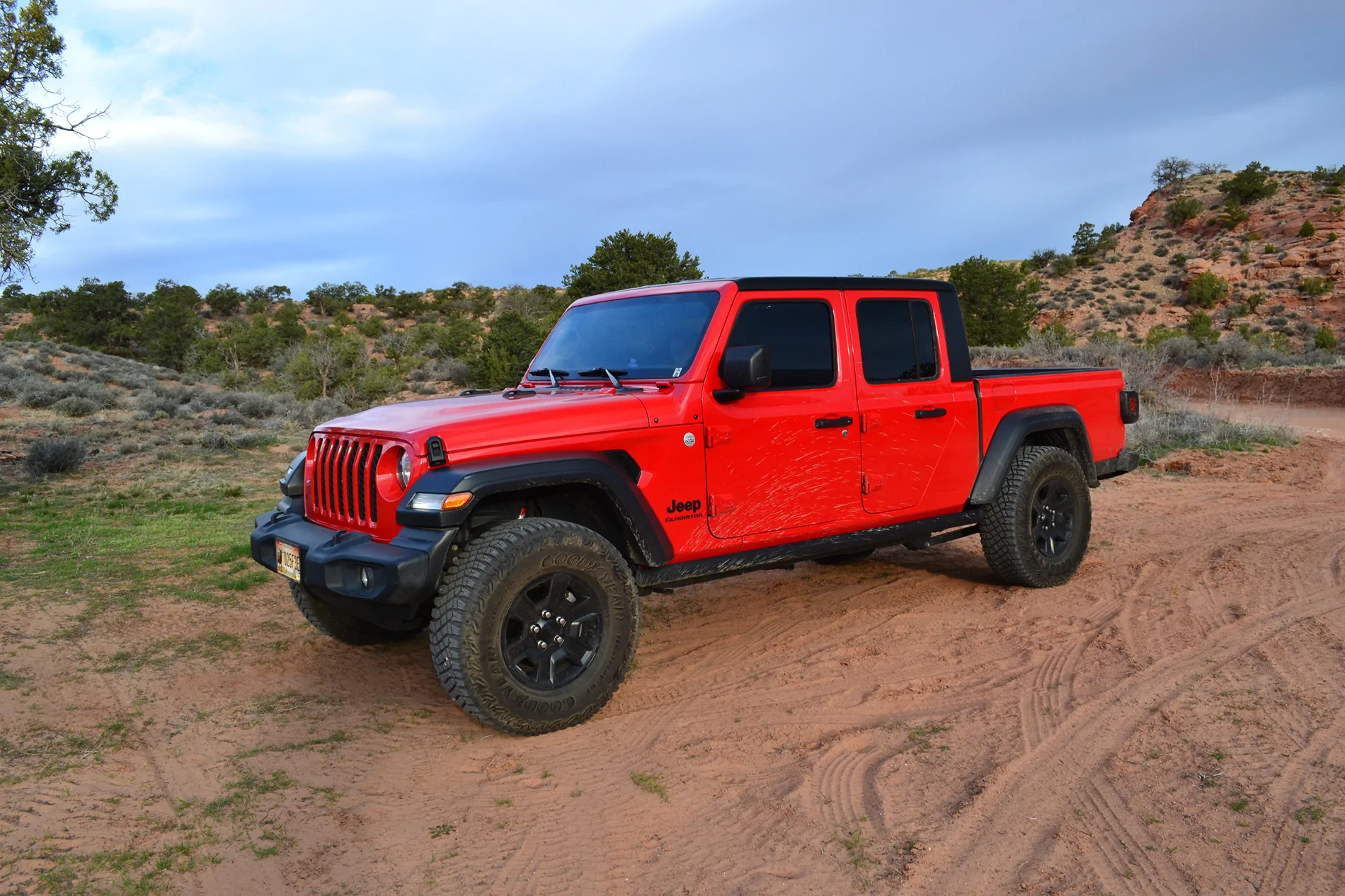

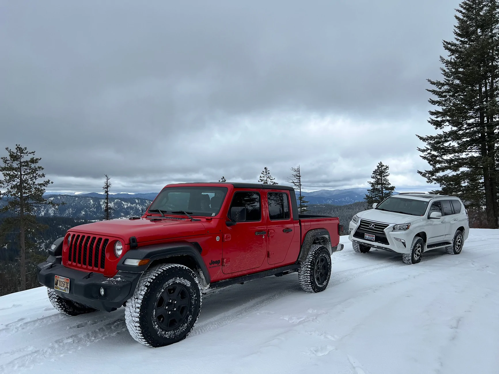

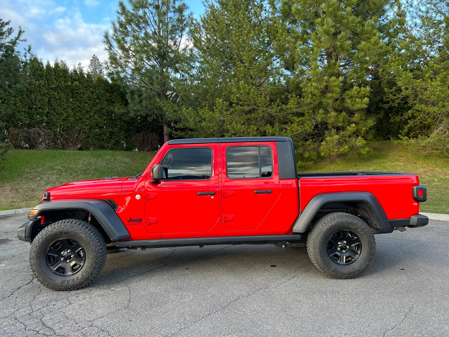

This is a 3/4" spacer with Rubicon coils (about 1.75") and 35s. The tires rubbed the front bumper pretty good but your bumper should have more clearance. I had some slight rubbing on the inner fender liners but that was with the swaybar disconnected and wheeling in Moab where we pushed it pretty hard. Drove 99% of the time no problem.

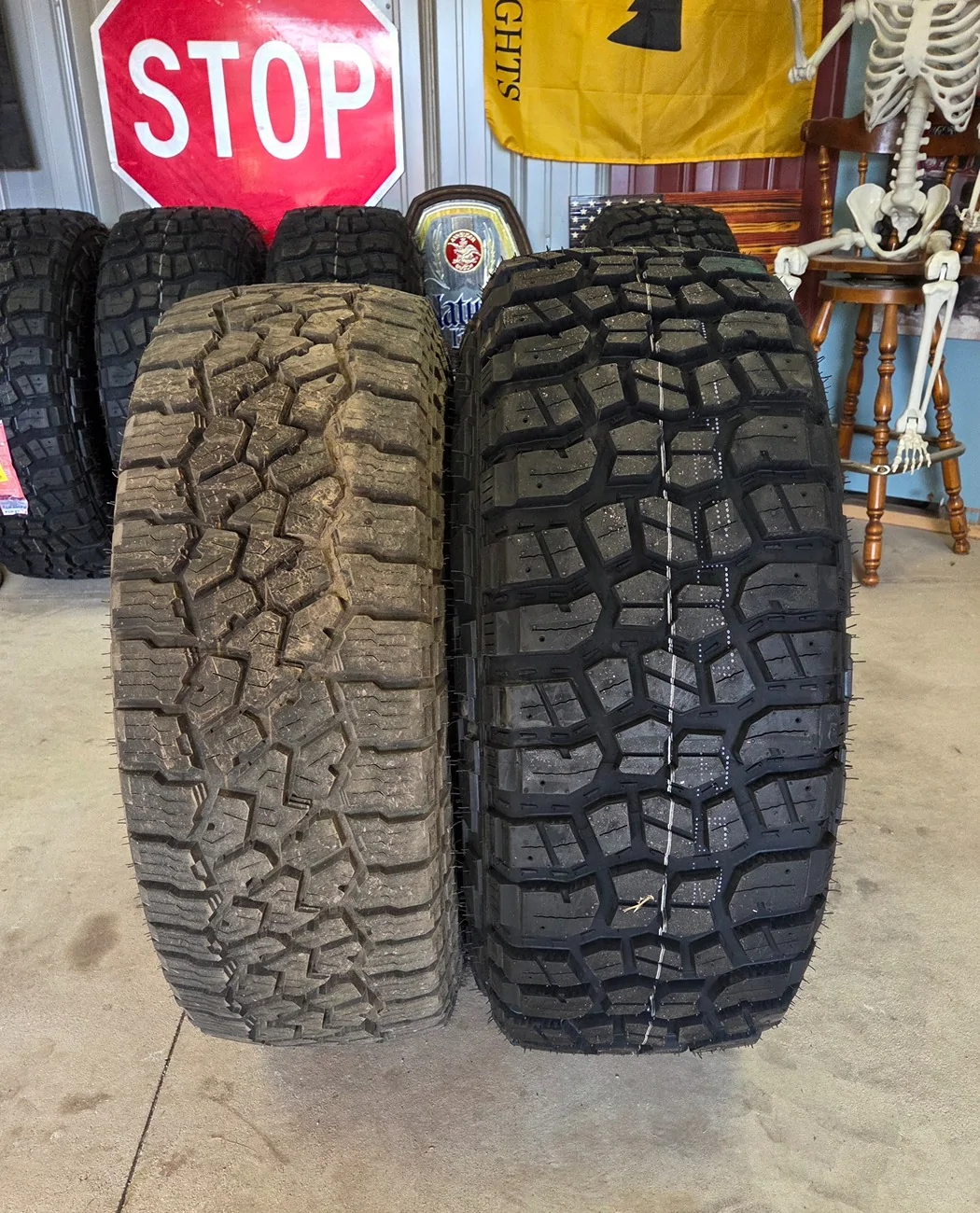

I did the leveling kit and switched to 315x70R17's (Which is almost identical to the 35's) with zero issues. Skipped the 35's only because they are a little wider but I am super happy with the swap.

How have the Kenda M/T2 been? I'm really liking the R/T, but looked hard at those.
I absolutely love them! They have held up on travel when I moved from Indiana to North Dakota and did really well in the mud holes. Not a lot of road noize either. I will definitely be replacing them with the same tires when I am ready again.
