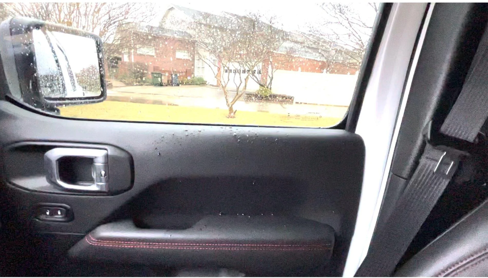

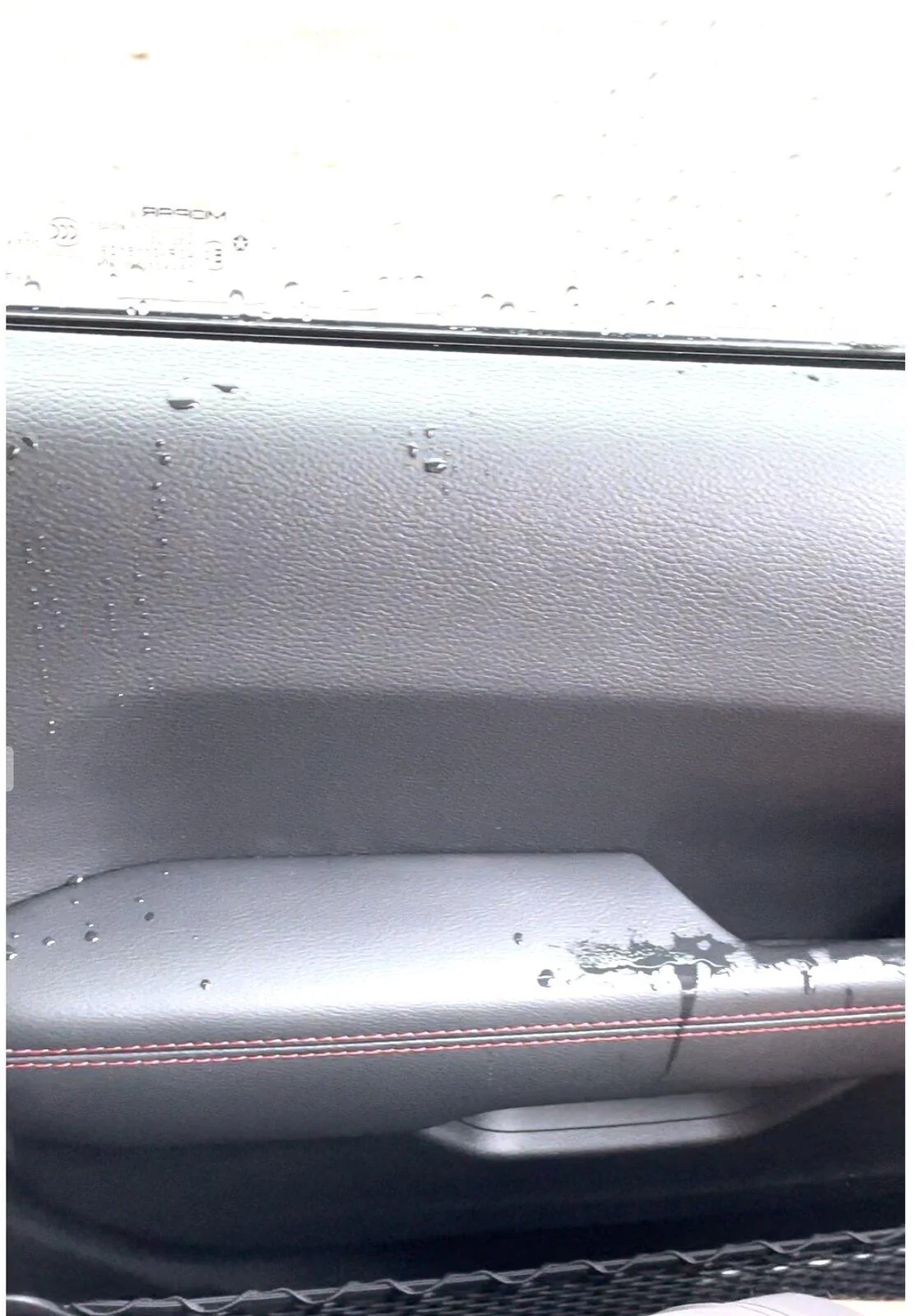

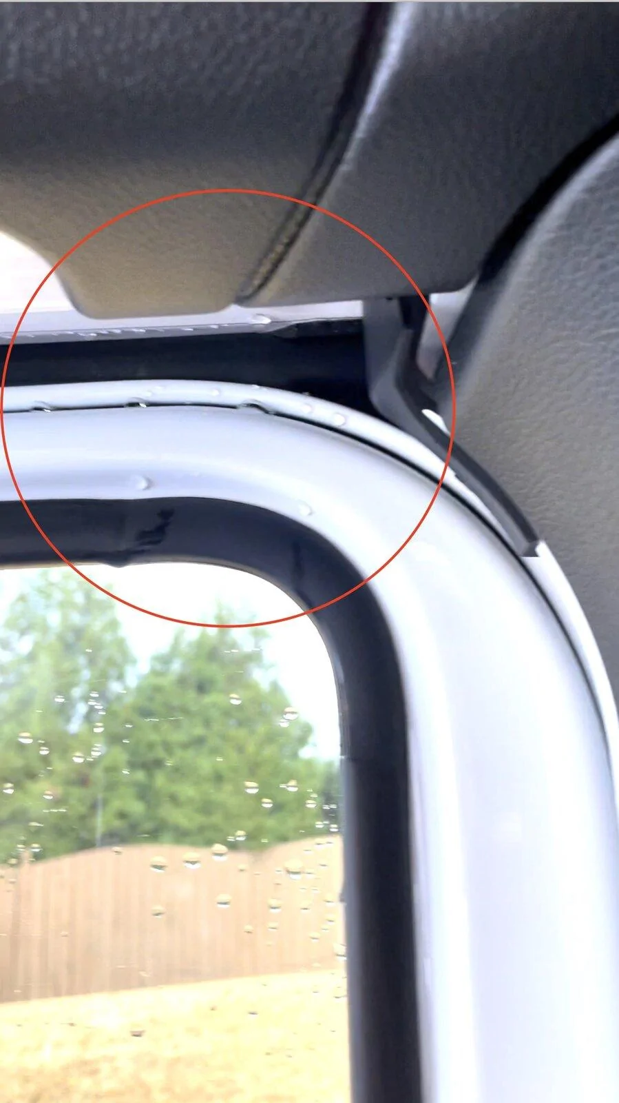

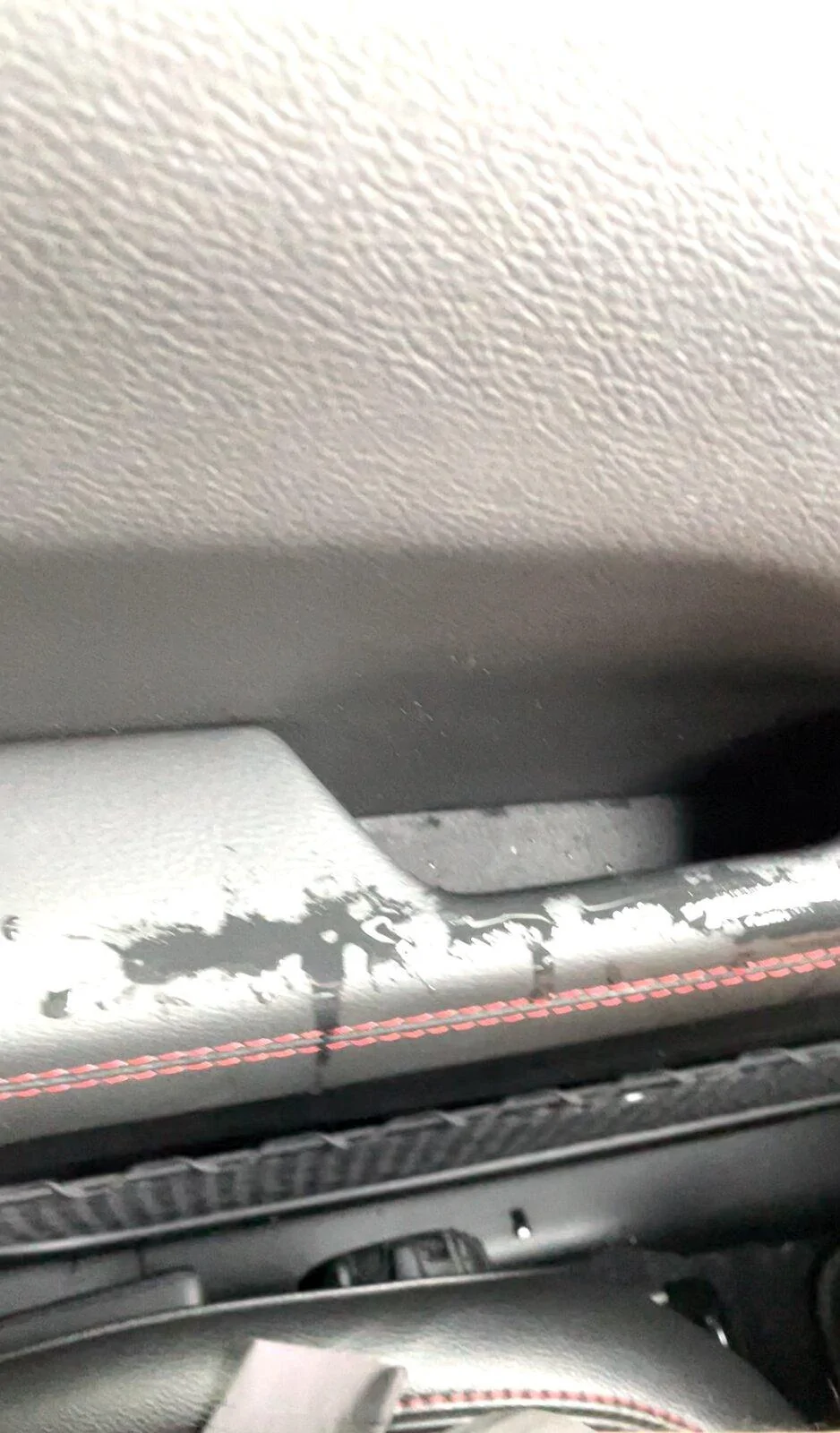

Got a new Rubicon EcoDiesel in October and love the truck... except for a really annoying roof leak. The dealer has replaced the freedom panels and had LeakPro come out twice to work on the weatherstripping. Nothing helped. Then, the dealer replaced the header panel, and still no help. It does not leak while parked or while being driven during rain. Only issues is once it has rained, the first time I drive it and come to a stop, water pours down inside the doors. And, not just a drop or two. It's enough that you would need to change your shirt if you were sitting just right. But, once the initial leak happens, it won't leak again until it sits parked in the rain. I have driven it nonstop for several hundred miles in a monsoon and didn't leak a drop.
Dealer has asked me to bring it back and has created a "star case." My understanding is next option is to replace the entire top. I hate the idea of that - anytime a dealer works on my cars, it seems like something gets scratched or damaged!
Anyone had a similar issue with your top leaking or have any suggestions?

I'd say check the fit of the headliners against the rubber gaskets and seals as well as see if there is something that's preventing a tight fit. Even if the fit is off a bit with a clip or latch not being in its cubby perfectly, it'll create enough of a gap for leaks.

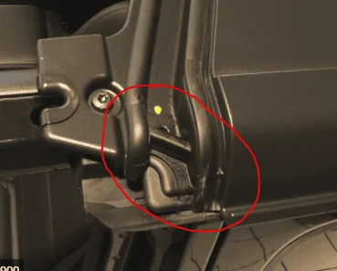

Have you checked the drains in the rubber seal at the sides of the channels in the front part of the rear section of the hard top? They release water near the top of the B-pillar.
I'll give that a look.
