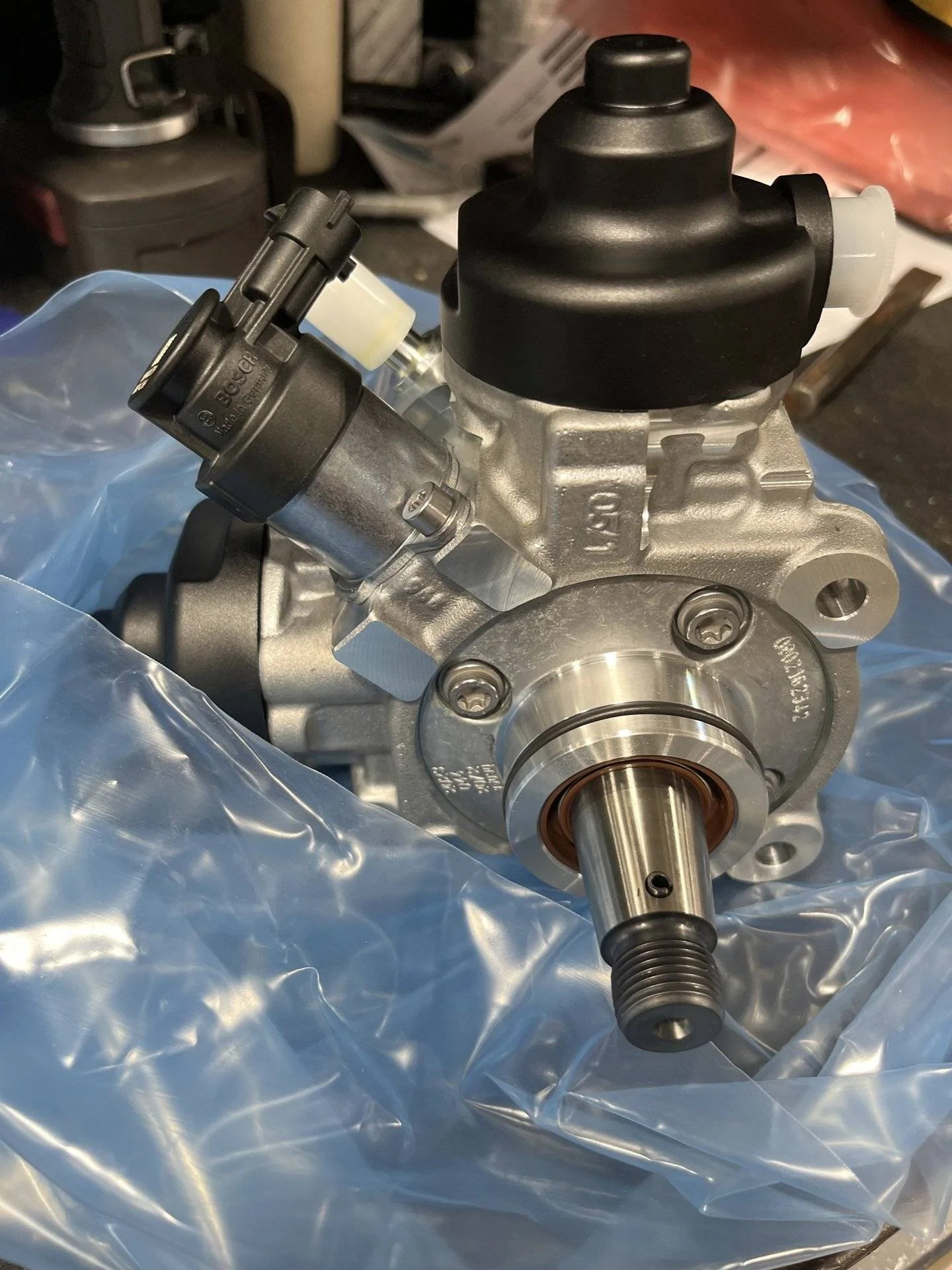

There's a FCA dealer tech on the forum who has been installing the new updated pumps for about three weeks now. He's only authorized to work on the vehicles that are sitting in the shop with a failed CP4 pump.

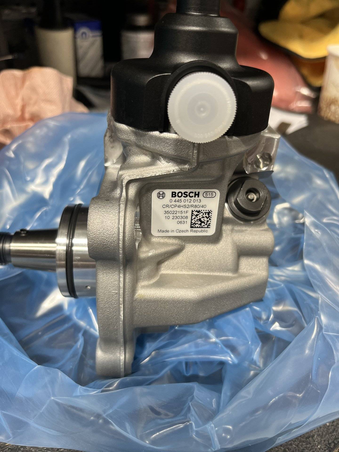

Is this part # even new or refined ?
The dealer tech said the new pumps are made from 'hardened parts'. Otherwise, he doesn't have any other information. There are no software updates, though. It's simply a bolt-on part.

Going through the TSB briefly. The replacement pump looks to be another CP4.
CSSMZ461AA - recall part number
68631088AA - warranty replacement part number
According to the tech, both are identical parts.

So, they are replacing a pump that can implode it when failed, to a pump with hardened internals that will just wears down over times if the pistons does rotated.
