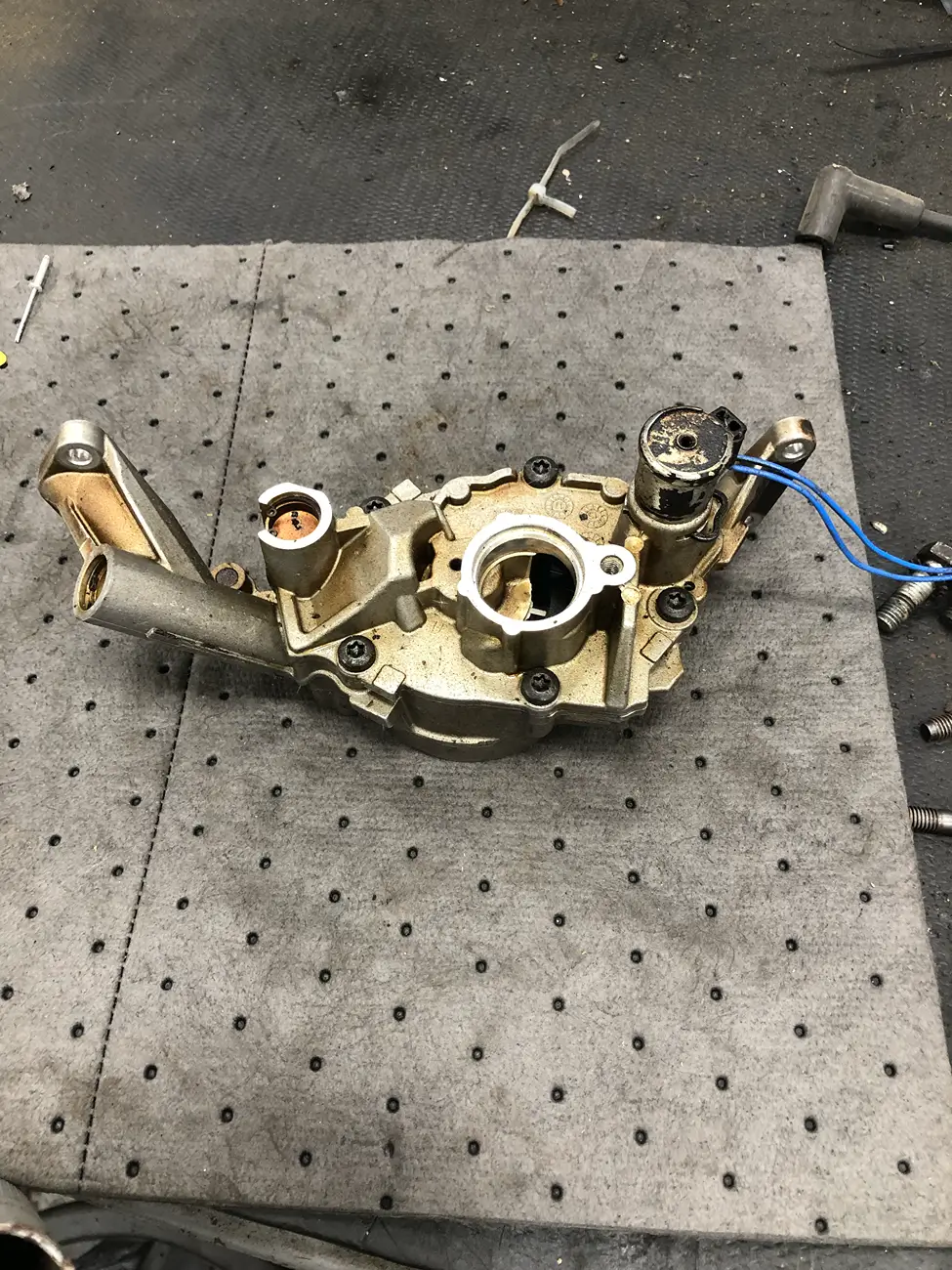

high volume is the default startup mode. It's possible the pump solenoid is stuck. They should be able to determine if it's REALLY that high and not just a sending unit issue, or if the pump is stuck in high volume or default mode. It's got a part that pivots on a pin depending on a solenoid position.

I see a lot of solenoid failures in our fleet of Promasters but I'm yet to see one stuck in high pressure mode. Usually they won't go into high pressure mode.
