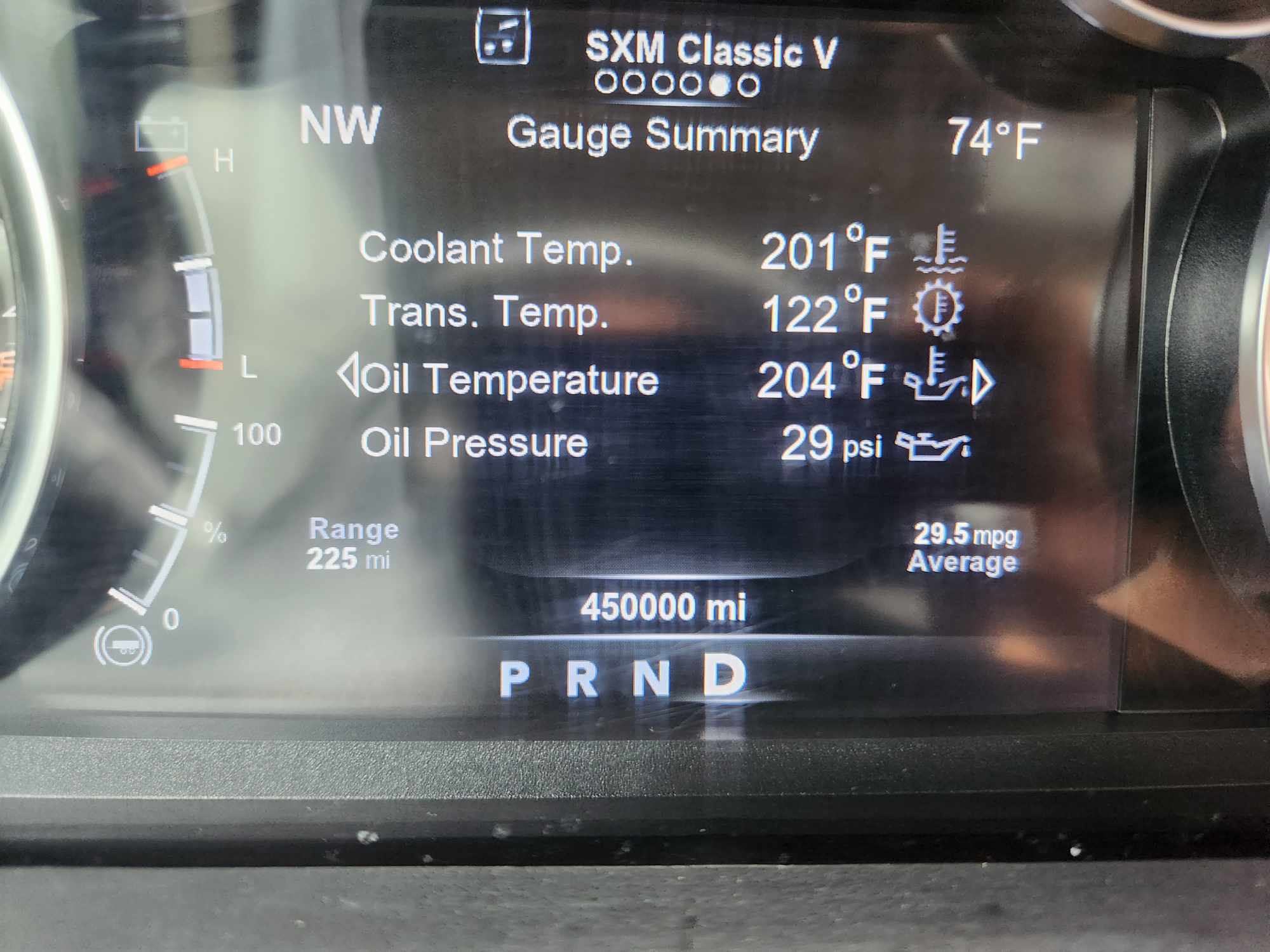

With that said, I don't fault anyone for selling/trading their vehicle if they are truly worried. Peace of mind, in my opinion, is much more important than worrying. But I also don't want to be the guy who is using fearmongering tactics to discourage those who don't have a good understanding of the CP4 and its track record. I've had my 2015 and 2020 EcoDiesel since new. I've had no issues. I have a buddy that just turned 450,000 miles on his 2015 EcoDiesel. He's still running the factory CP4 pump. We both run biodiesel and a fuel additive in every tank.
