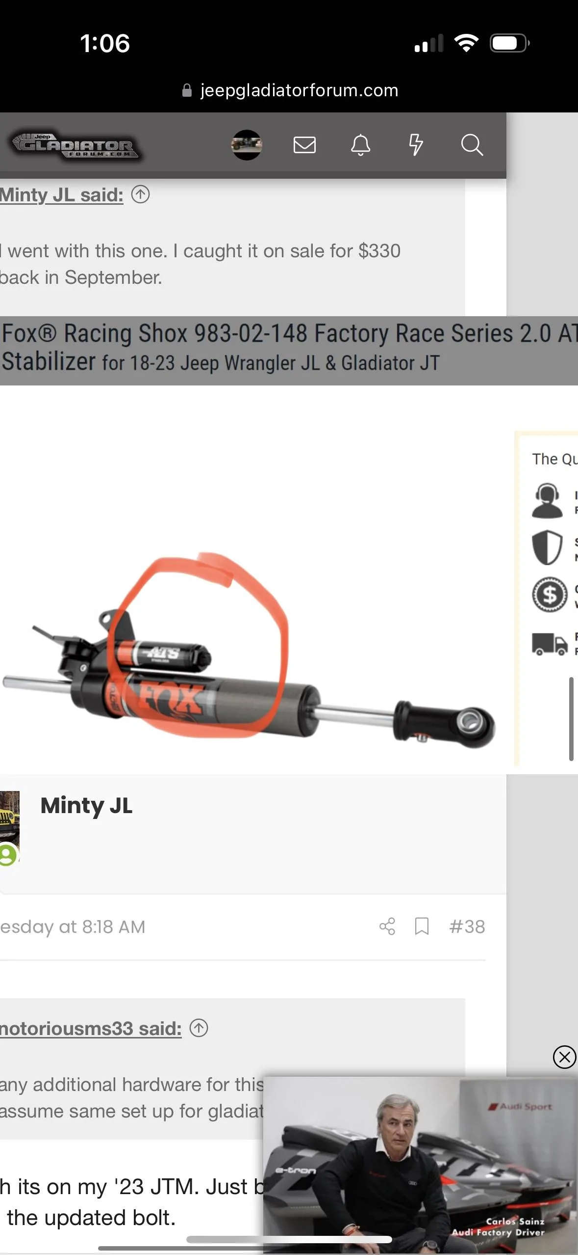

This is the one with the 24 clicks? Easy install?
Yes and Yes.
Like the others have mentioned, ensure you buy the correct bolt.
I have mine set at 12 (midway) perfect steering feel around town or on the highway doing 80mph. Its worth every penny without a doubt

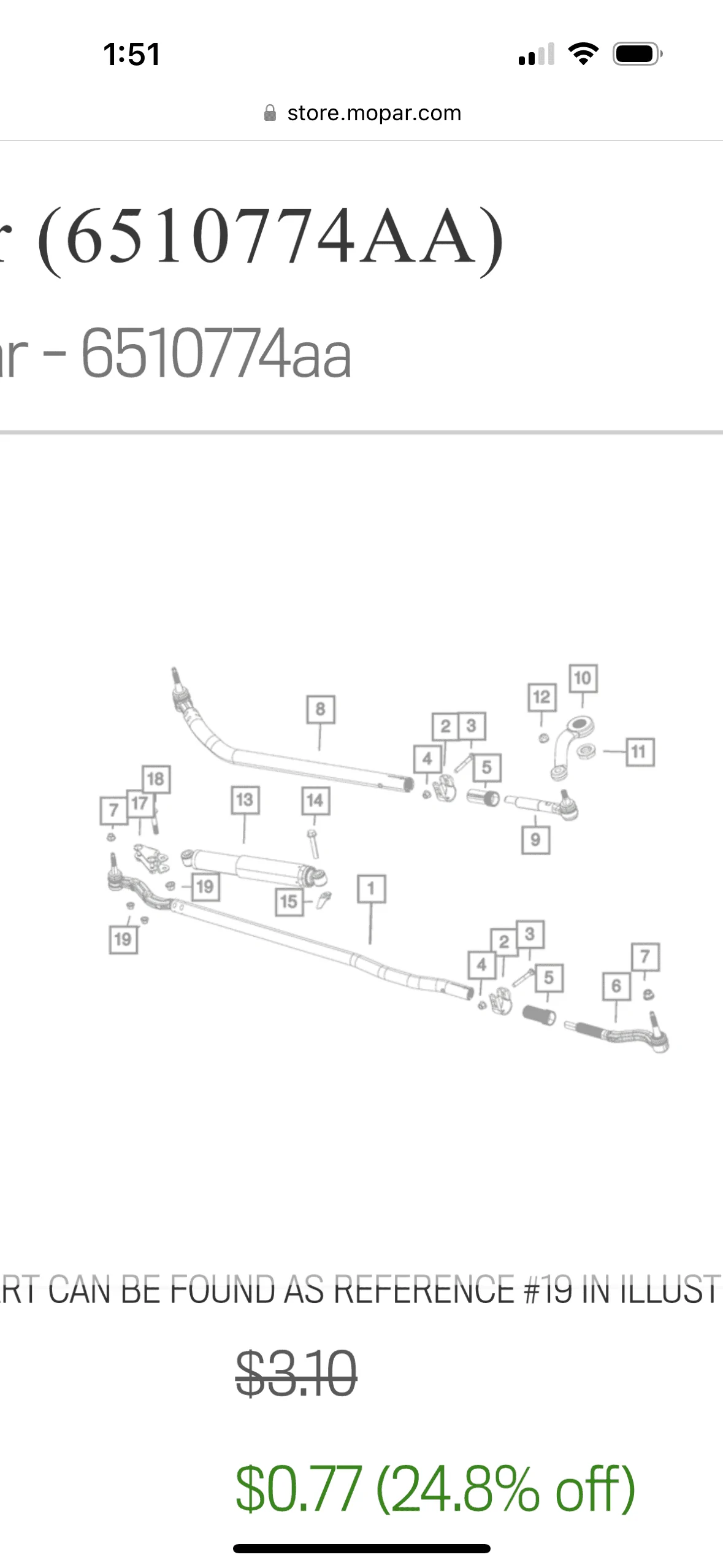

So I hate to repeat something that I havnt installed yet, but everyone including fox says you do not need a different bolt.
Either way I have a bolt on the way just incase you guys are right.
I was able to use my carriage bolt for my falcon nexus, will see about fox ats
I needed it for my '23 JTM
