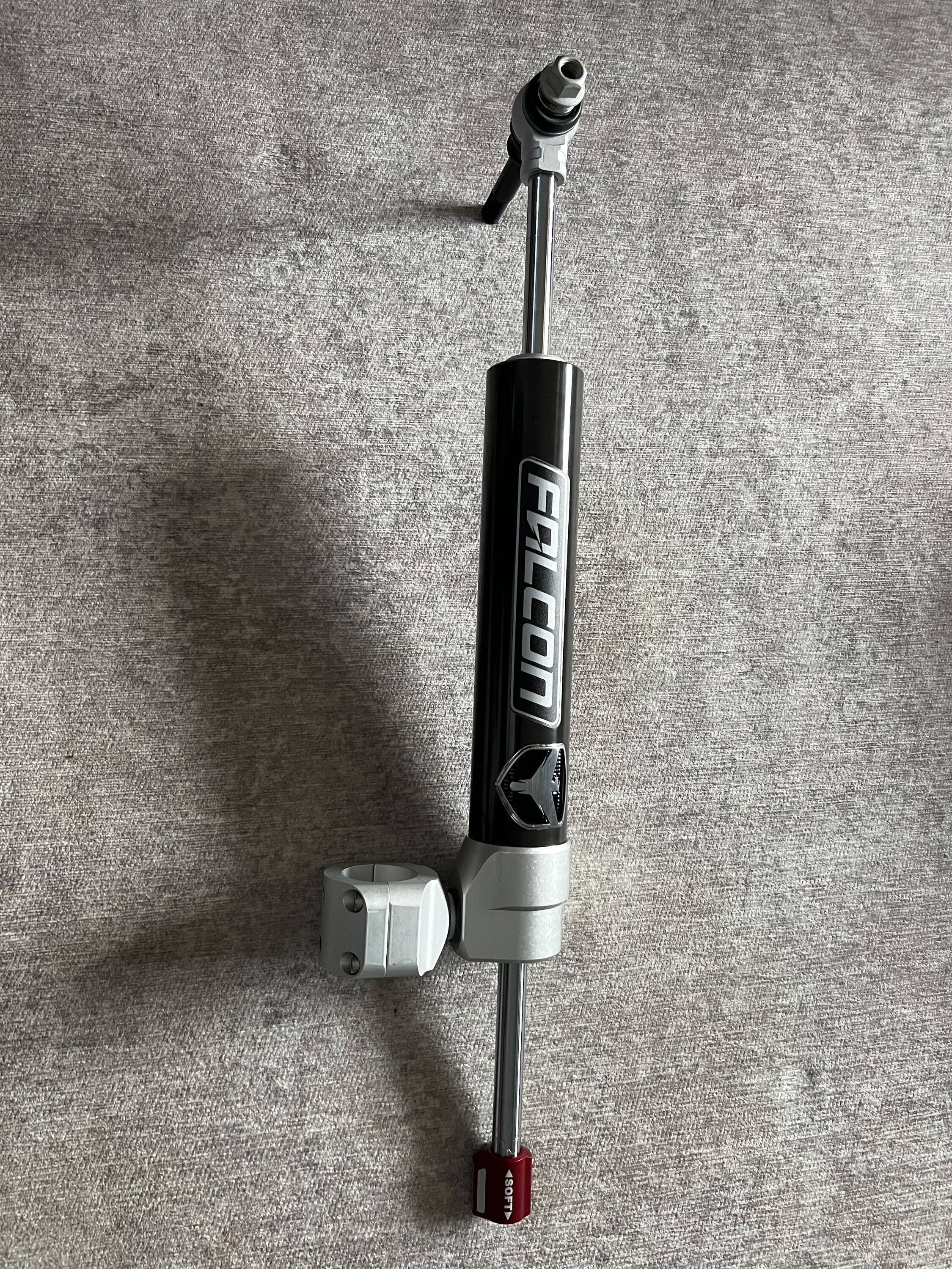

Anybody know if this is the same part number mentioned above?
Jeep Gladiator 2021 Mojave and steering stabilizer benefits 24F8C6AE-3FBF-465F-A266-5446E7A14CD0
I ordered the jk model to relocate up and over. Beauty of Amazon, hassle free return to the ups store down the street. I’ve been looking and email trying to confirm with teraflex but no replies 🤷‍♂️
totally right fitment.They also told me you need to order the bolt from mopar for final install mopar part #6510774AA
The one you ordered is correct for oem fitment since it still uses the JL/JT axle bracket. To relocate the one you ordered , you’ll also need to order a new clamshell mount. Mine should be here today. I’ll send picture if it had everything needed for the simple bolt on/relocate.

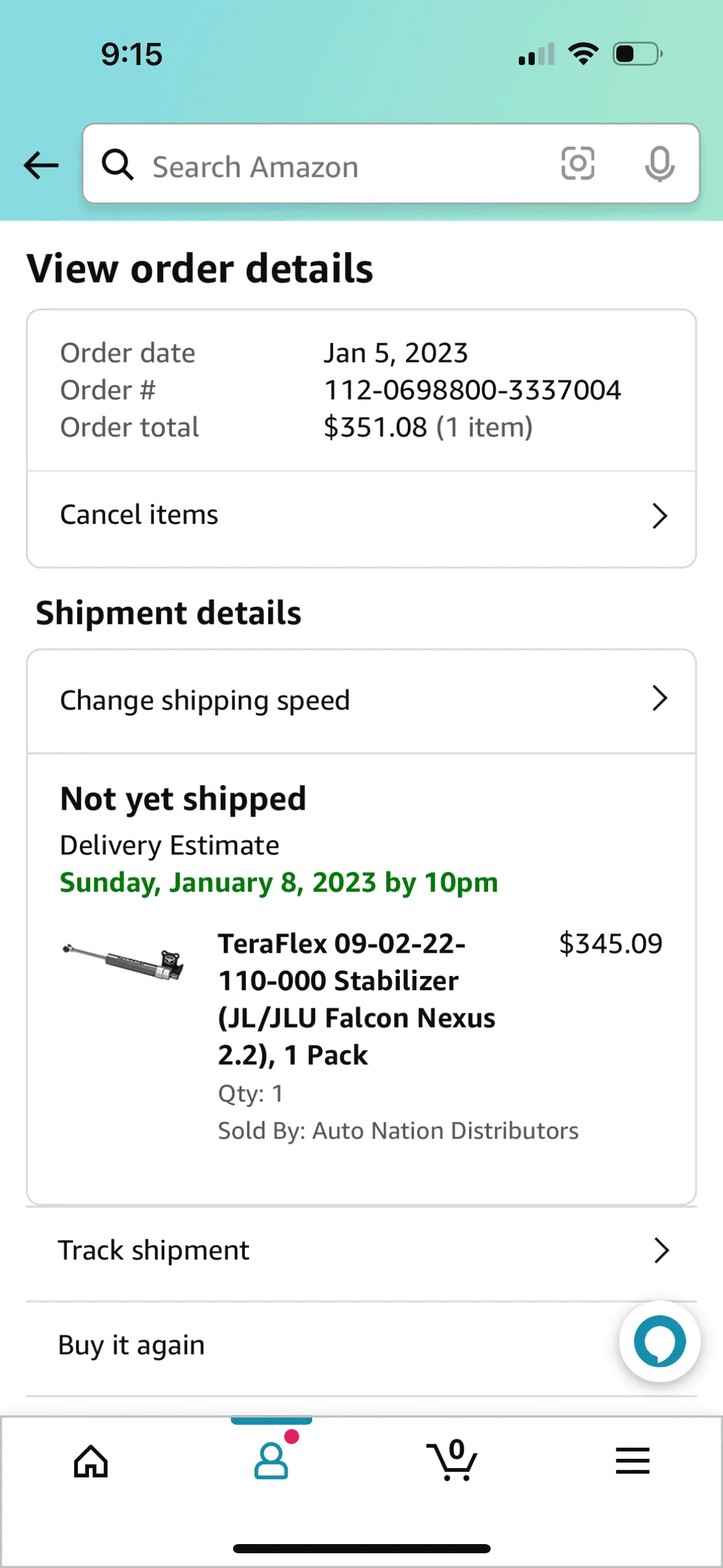

I went with this one. I caught it on sale for $330 back in September.
Jeep Gladiator 2021 Mojave and steering stabilizer benefits 1673030940753

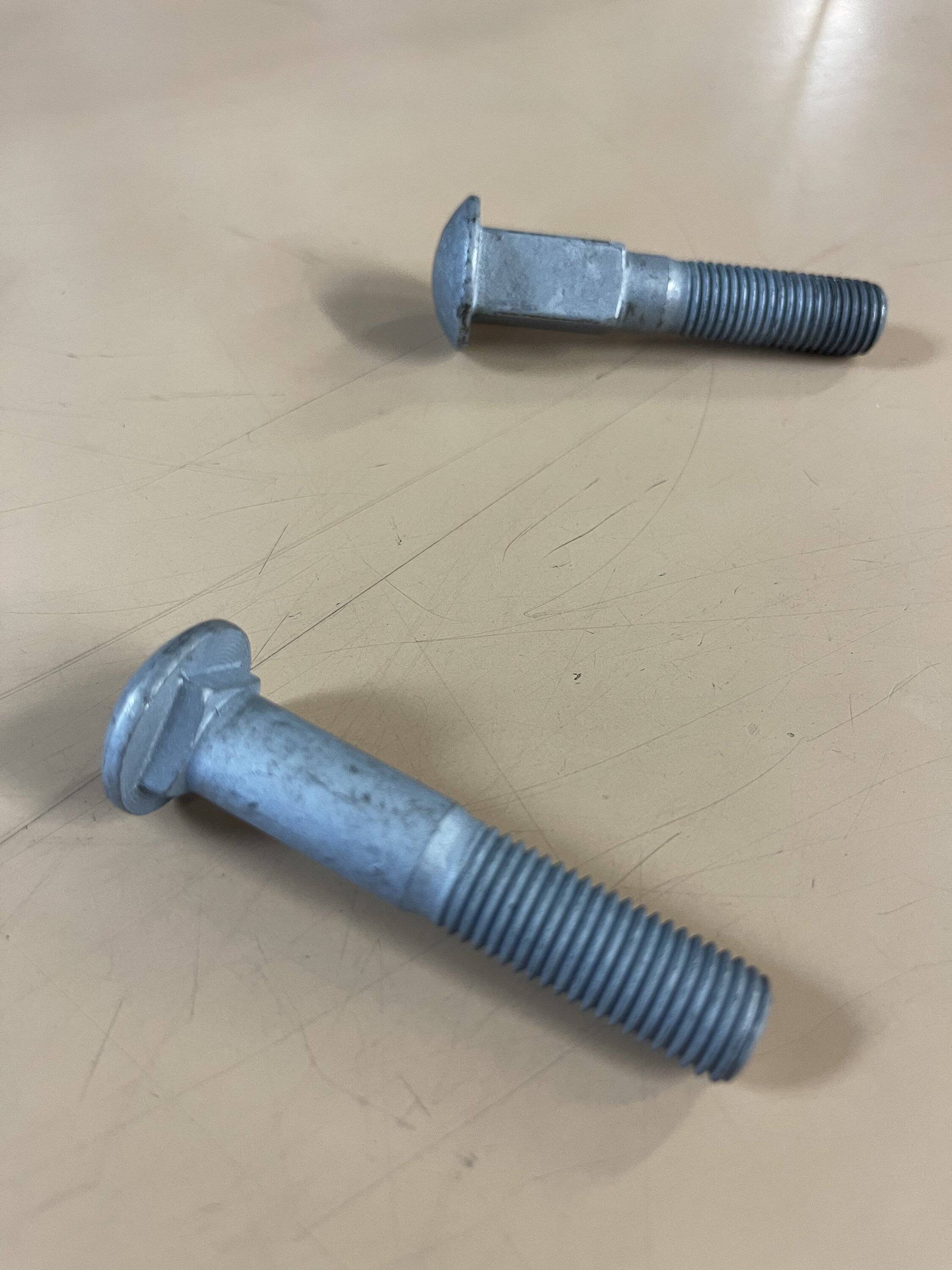

Make sure you buy this before install. The cost is between $3-$5. You can reuse the old nut. But if you want a new nut they are over $20 each(!).

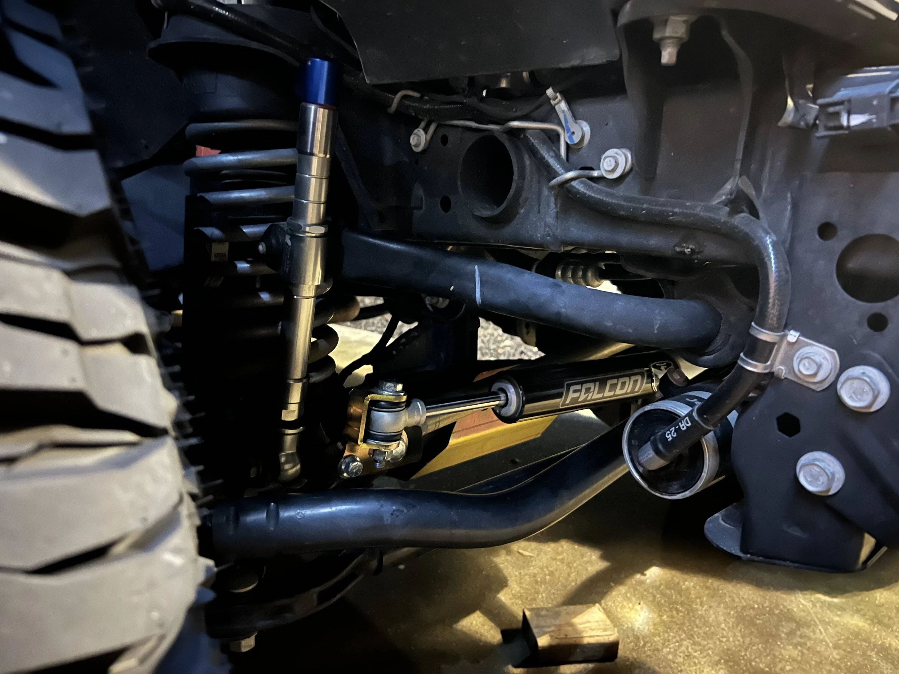

2021 Gladiator Mojave
here’s the correct one to order which will relocate the stabilizer up and over. I prefer the ease of adjustment too.

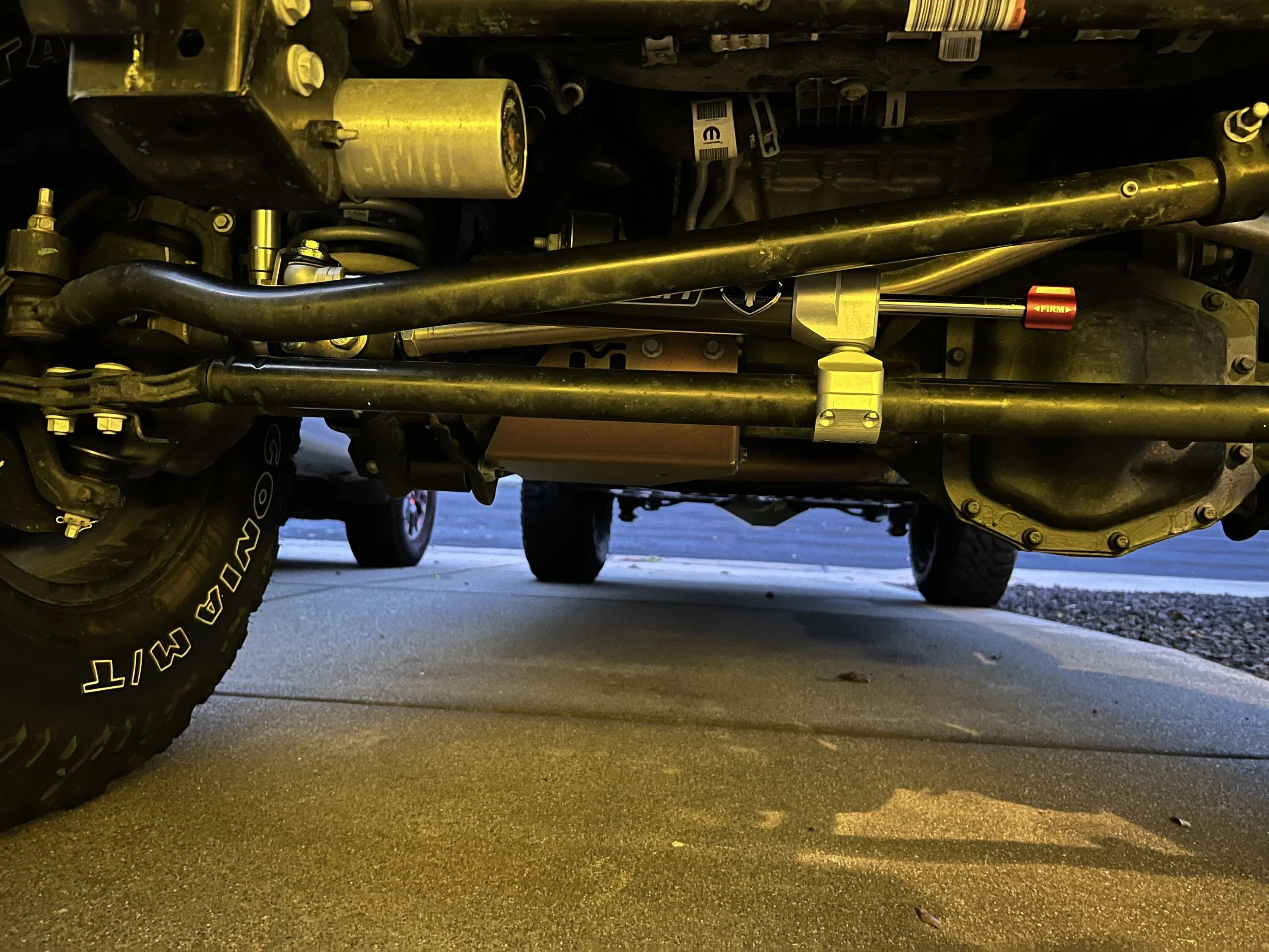

No need to buy additional hardware. Works with the metalcloak relocation bracket too. Otherwise, use the supplied new trackbar bolt. Even on the soft setting it almost eliminated the side to side play in the steering wheel. My factory one I can feel the dead spot in the center and you can hear the air in it just by pushing it in and out at the dead spot.
(Sorry about the yellow tone of picture. Diode dynamics lights are kind of bright 😁)
