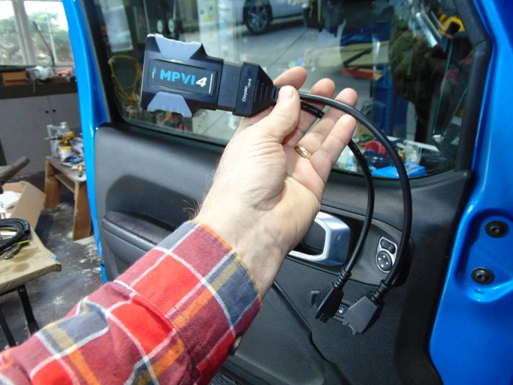

I did manage to get my bypass cable hooked up, and the HP tuners MVPVI4 communicated, or at least gave me a green light from the vehicle. My instructions told me to download an app called TDN and use it to retrieve the stock vehicle file.

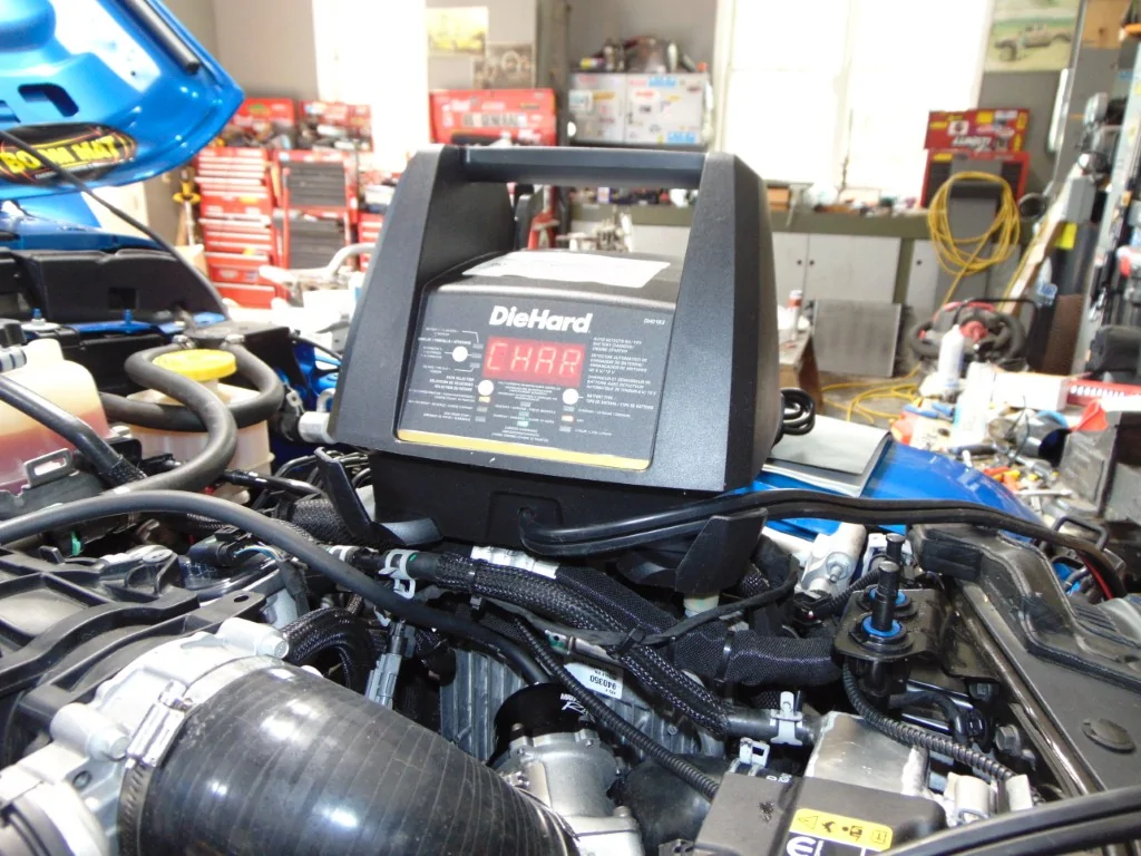

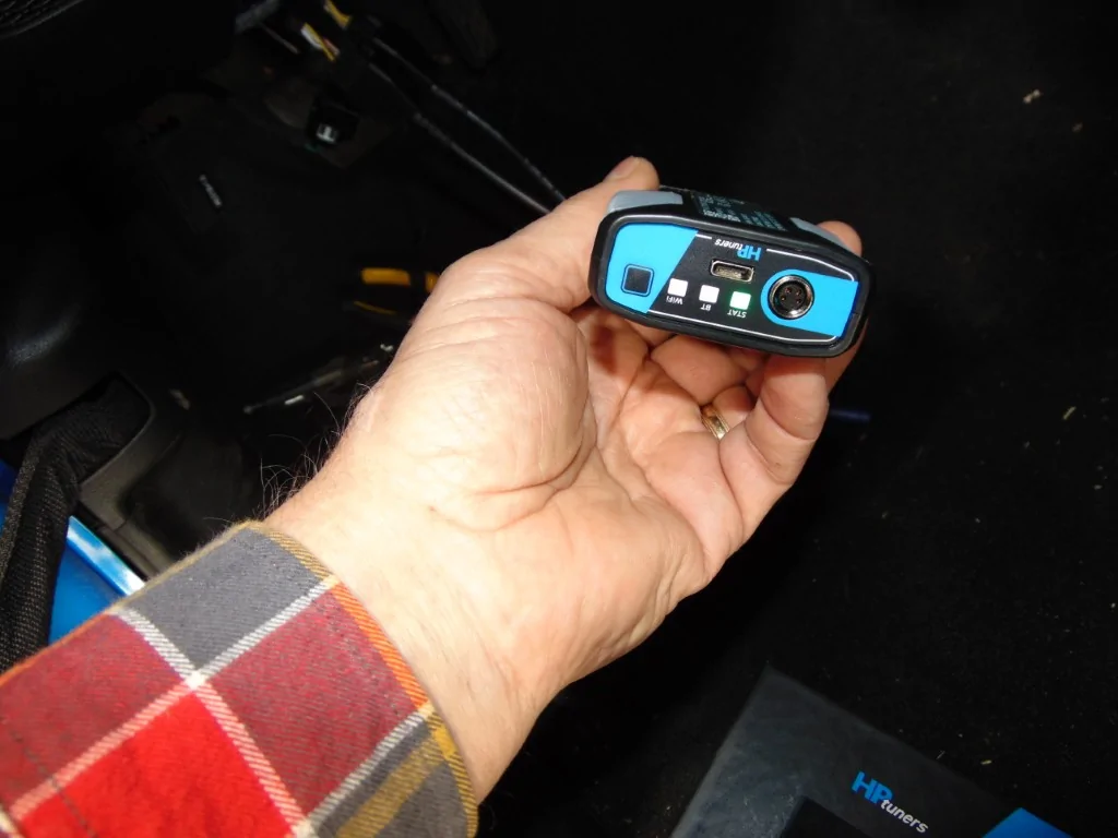

First, with the tuning process, it is very important to have everything charged up. I needed a new one, so I opted for this DieHard unit that I scored for around $160 with my military discount.

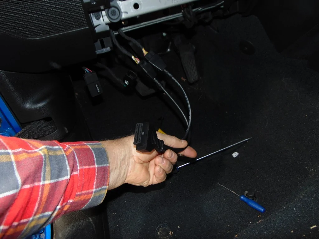

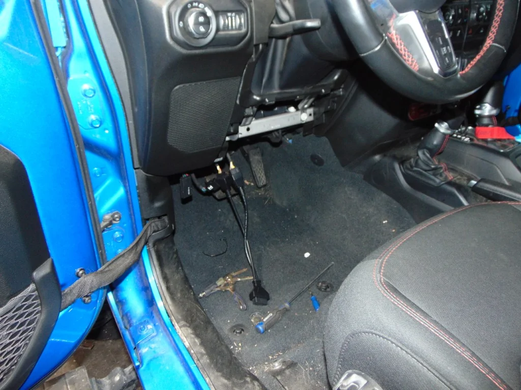

I referenced a bypass cable required to bypass the security module. Here is the one I use for my Ram truck. Stellantis tends to standardize things, and this is no exception. It plugged right in, and this particular unit, marketed by "Weekend Garage," adds an extra OBD port, which I successfully used.
I would also like to note that getting to the security module is somewhat easier with the panel removed

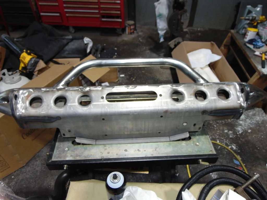

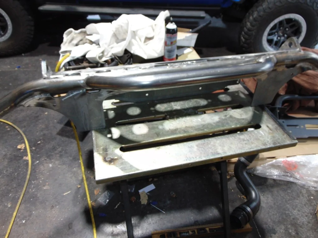

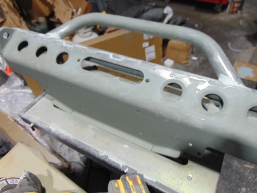

So, onto the bumper. I had it roughly welded, however, I had some sort of a malfunction in the gas flow for my Miller MIG welder. The gas connection slipped, cutting off the gas supply. That causes the weld puddle to bubble, which will likely require grinding and re-welding. I have been working on that process.
Here you see a Barnes Off Road Pritchett Canyon U-Weld-it bumper that is light, strong, and inexpensive.

Once I had it close, sanded, and cleaned, I applied a liberal coat of self-etching primer.

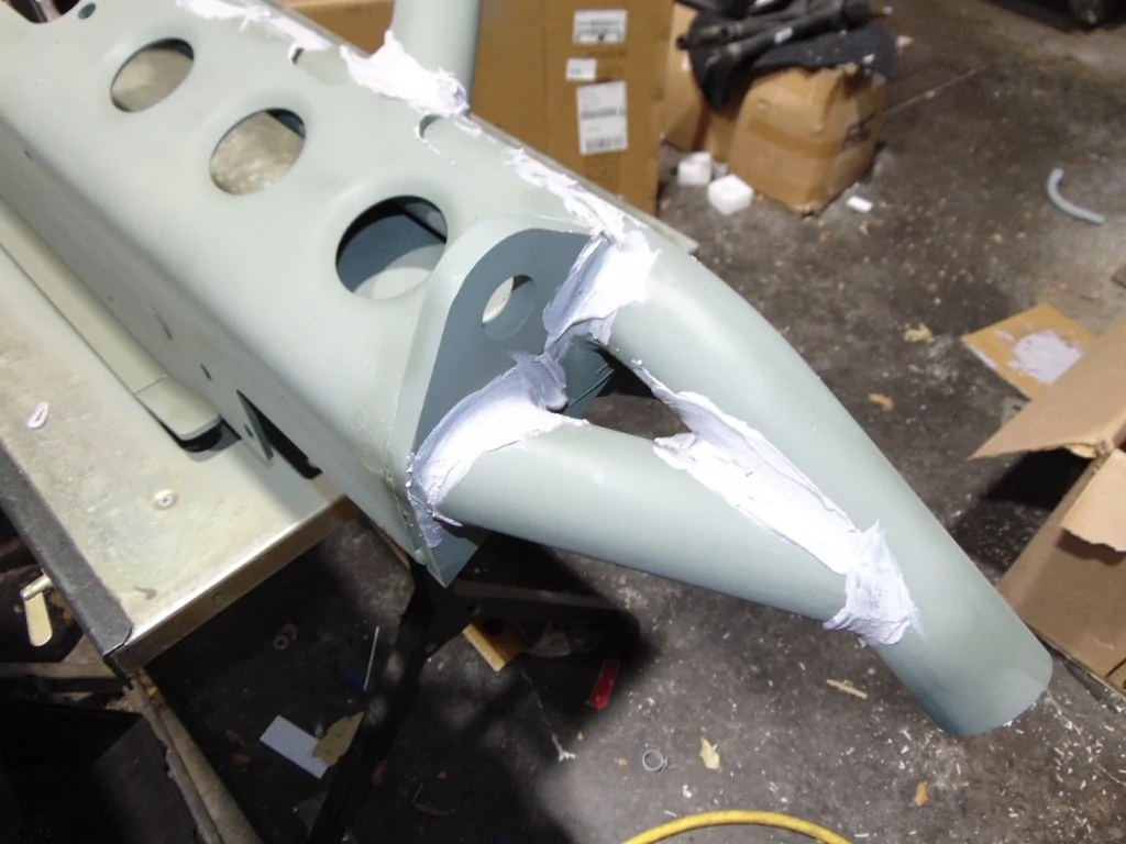

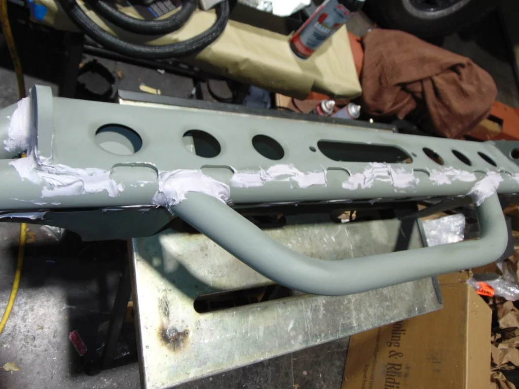

Since I did not give this one my "Stacked-Dime" welds, I just ground them down and decided to try something new. Using body filler and a set of rubber gloves, I smeared the polyester material over the welds. I think I'll go for a smooth finish appearance that might last until I push my first Prius out of the way!

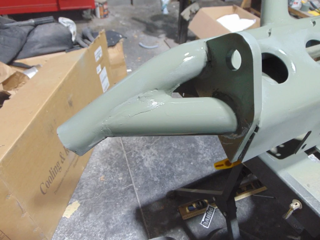

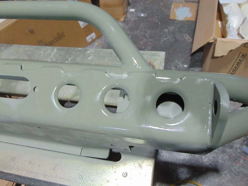

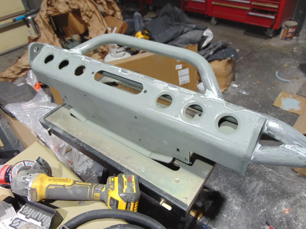

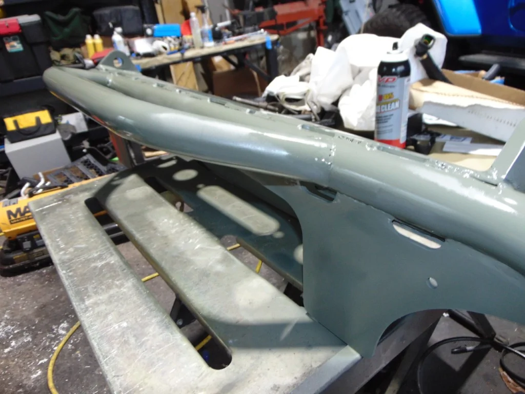

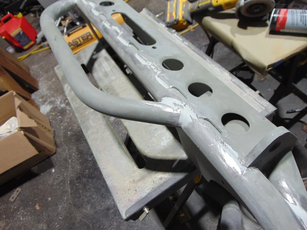

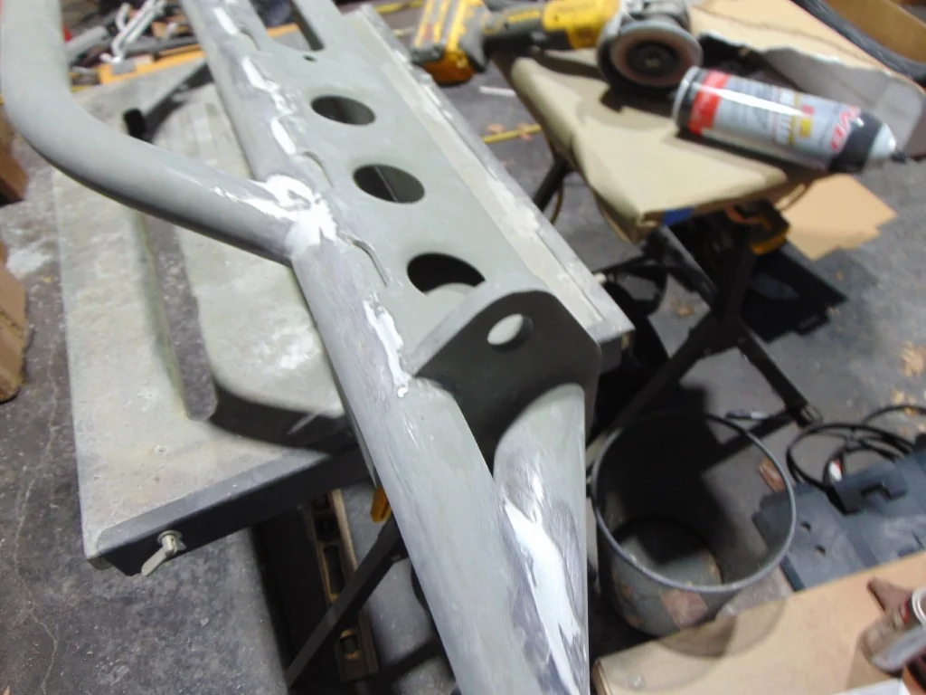

Today I moved the ball downfield a tad more.
First I got an email from Ripp asking all sorts of questions to allow them to dial in my initial tune. So, I may only be a day or perhaps two from the startup.

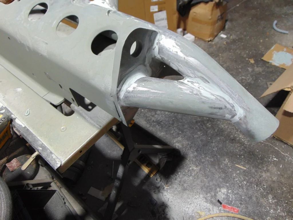

Next I sanded on that body filler on the Barnes bumper for some time. If ever I wanted to rob a bank, today would be the time, since I have no finger prints left. They departed my fingers sometime around mid day and are now pasted to a bunch of #50 and #150 grit sandpaper.
After all that I was left with a pretty good beginning toward the smooth appearance I am shooting for.

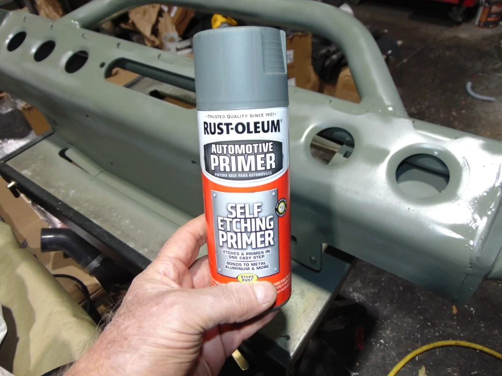

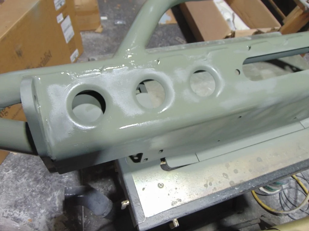

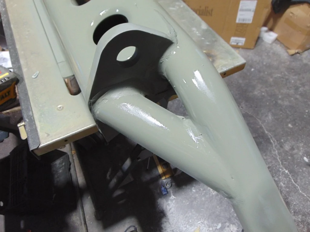

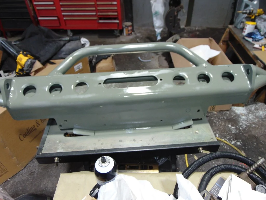

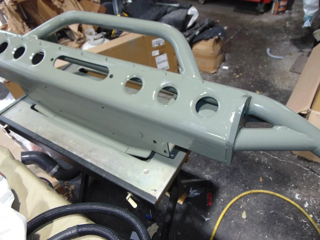

After a cleanup, I sprayed all the areas where I had sanded through with more of the self-etching primer.
