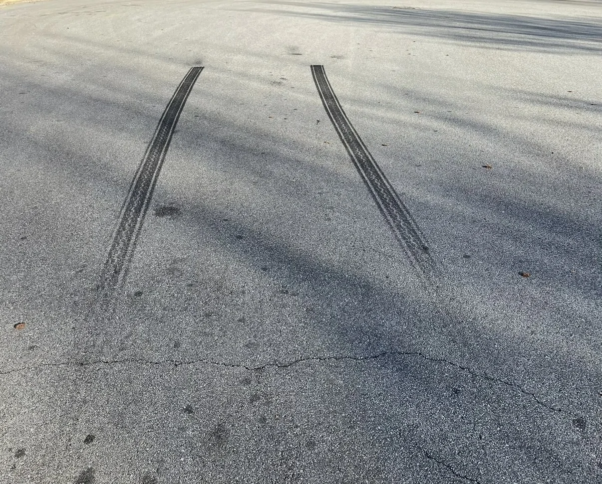

Both of my rear differentials (first one was replaced at 20k) started making a squeak for the first 100’ or so in the mornings after a rain. I replaced my rear differential fluid at 59k because it was starting to make noise when turning and I wanted to make sure there were no issues before it ran out of warranty. The fluid looked good. No surprises. I refilled and added the Mopar friction modifier back and the noise went away and it still works. I had to test it. Lol
Jeep Gladiator 2022 Gladiator with burned up rear differental. IMG_2277

Yeah, pretty sure I could benefit changing the fluid in mine too. Mine doesn't always leave the marks quite equal lengths, granted I'm in a manual with 3.73s and 32" MTs.
I do manage to consistently get the advertised 0-60MPH times (according to Tazer) with this setup. Maybe I'll either locate the pic proof, and/or try again in spring. This was with new 255/75r17 MTs weighing about 49lbs each.

I just used the valvoline squeeze bottles because it’s easy. They are supposed to have friction modifier included but I didn’t trust that. You walk a fine line because too much and it won’t work as well. I used roughly 4/5 the required additive amount and I got lucky and guessed it right.
