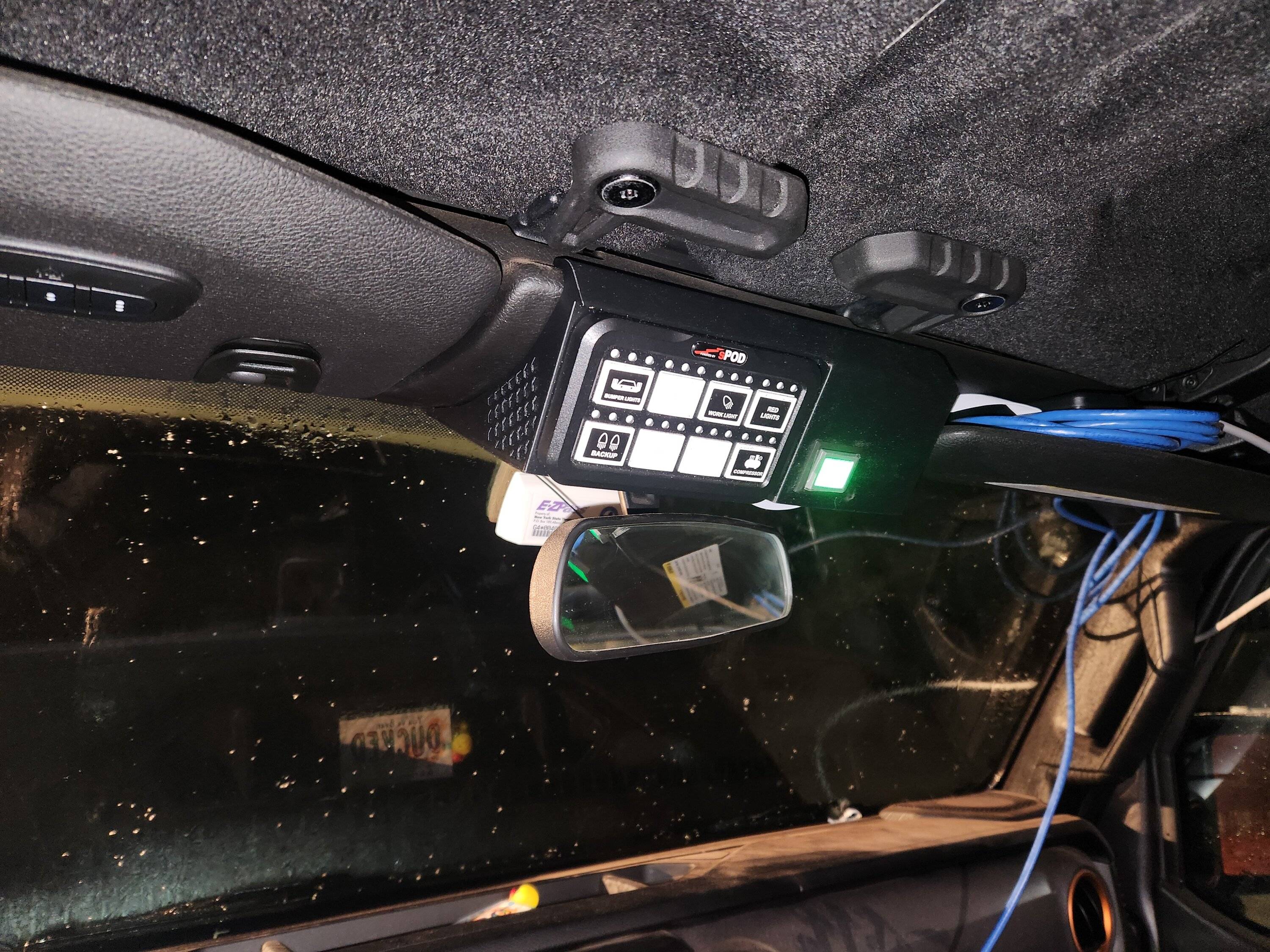

I have an spod and I'm pretty happy with it. Not the cheapest thing, but it is made in the USA...
I also just got an auxbeam panel for my auxiliary setup in the bed, it looks pretty well made, but I haven't actually used it yet..
If you want more of a factory look I think Lasfit is the only option. I like the factory look, but I think the location that jeep used on the dash sucks for access. I also needed more than 4 circuits, so that was another factor.
I 3d printed a bracket for my spod and I think it looks pretty good. I haven't permanently wired it yet so it needs to be cleaned up still.
