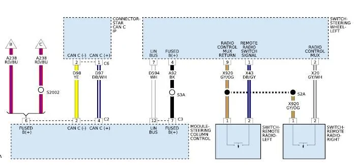

Really not much to the switches themselves. I would expect some can bus codes to be setting if they actually did a high level systems scan if the can bus.
I think it is going to be down to wiring between the SCCM and the steering wheel left switch.
so in other words fuses, relay switches ?
