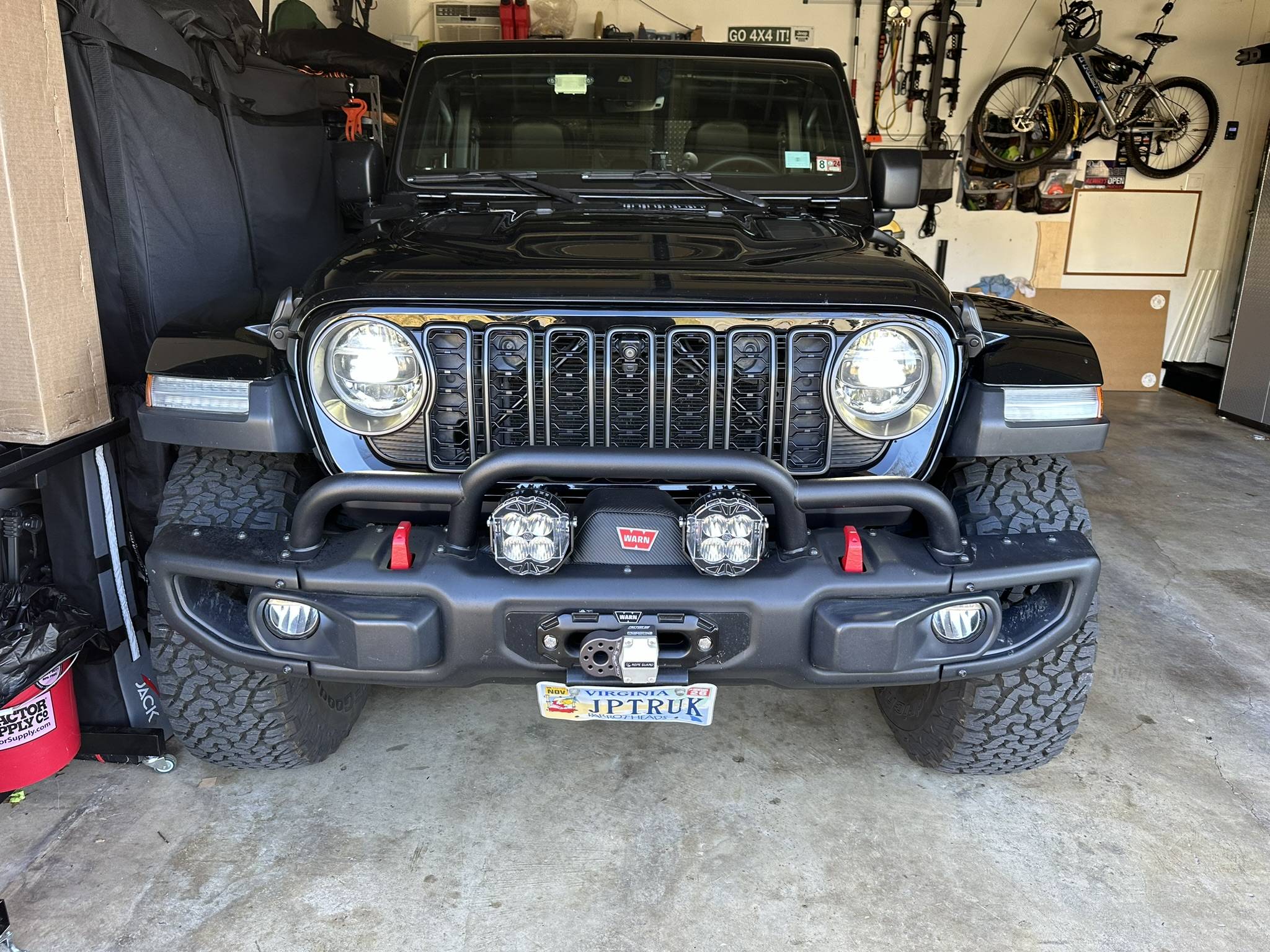

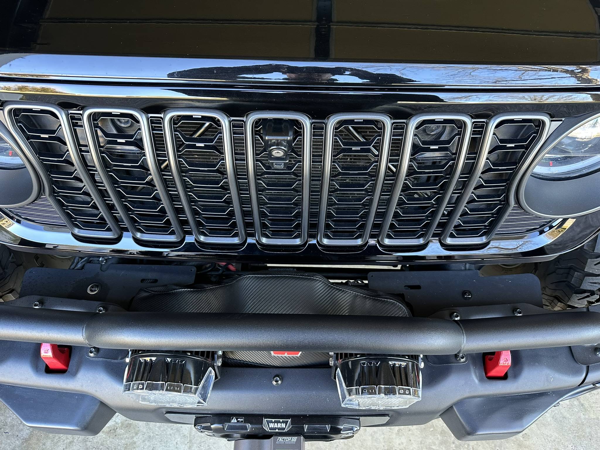

Does this mean that in 2024 there are no color matched grilles?
My 2024 Mojave X has a color matched grille. I kinda wish it was black, but it does look pretty good with the Granite Crystal. If the JTMX was a lighter color, I would have to go with a black grille.

Knowing you didn't get the Rubicon trim color.. I have a 23' Mojave... curious if the 24 Mojave has the "rubicon grey" trim color or standard grey?? Anyone?

Looks great.
2024 Mojave X
Jeep Gladiator 2024 Grille on my Firecracker Red 2020 JTR Hood Deflector

2024 Mojave X
Thanks but not seeing any 24's in person and or the rubi grey or the standard.. this image does not help explain which grey I'm looking at.
I'm sorry my attempt to help you, did not. Apparently a picture is not worth 1000 words. I did an internet search for you. I found the following on the Distinction Applied website. I bolded some text to make it even easier for you. If its not helpful, I'll try harder next time.
This product listing is for the Mopar 2024 refresh Grille that will fit your 2018 to current JL/JT Jeep. The Grille assembly does not include the rubber stripping, foam, and mounting push pins that are needed to mount to the vehicle - you will need to remove these from your existing Grille.
Please select the your prefered color in the drop down boxes. Your color choice will be applied to the outer Grille surround and panel. The grille trim will remain "Factory Medium Gray" (not Rubicon Gray), the mesh and chin will remain "Black Plastic".
I extrapolate from the above that the color is Factory Medium Gray, not Rubicon Gray.
I hope this helps.

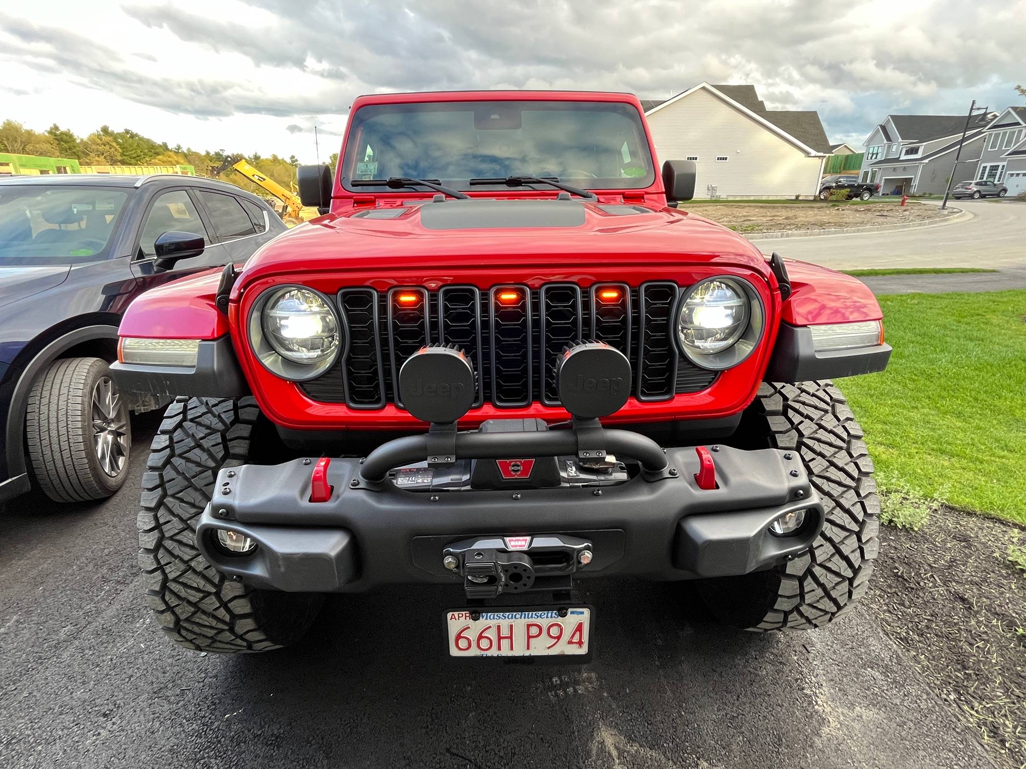

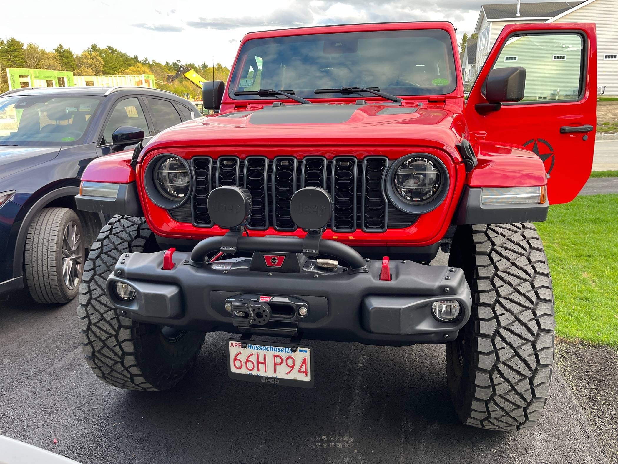

Upon further examination,
it appears that the grille surround can be color matched
but the bars cannot.
It is the bars, in my opinion, that are the Jeep trademark,
the most easily identified and distinguishing feature.
For 2024, they have in essence been obfuscated.
Is nothing sacred?
I had them color match the slots on mine. Cost a bit extra but this is what I thought Jeep would do if there were a 2024 High Altitude trim (also had to specify the gloss black around the headlights but that wasn't extra).
Jeep Gladiator 2024 Grille on my Firecracker Red 2020 JTR 1715700435930-qc
*I also notice a very very slight decrease in running temps (3.6L) but not enough to justify any of the cost.
