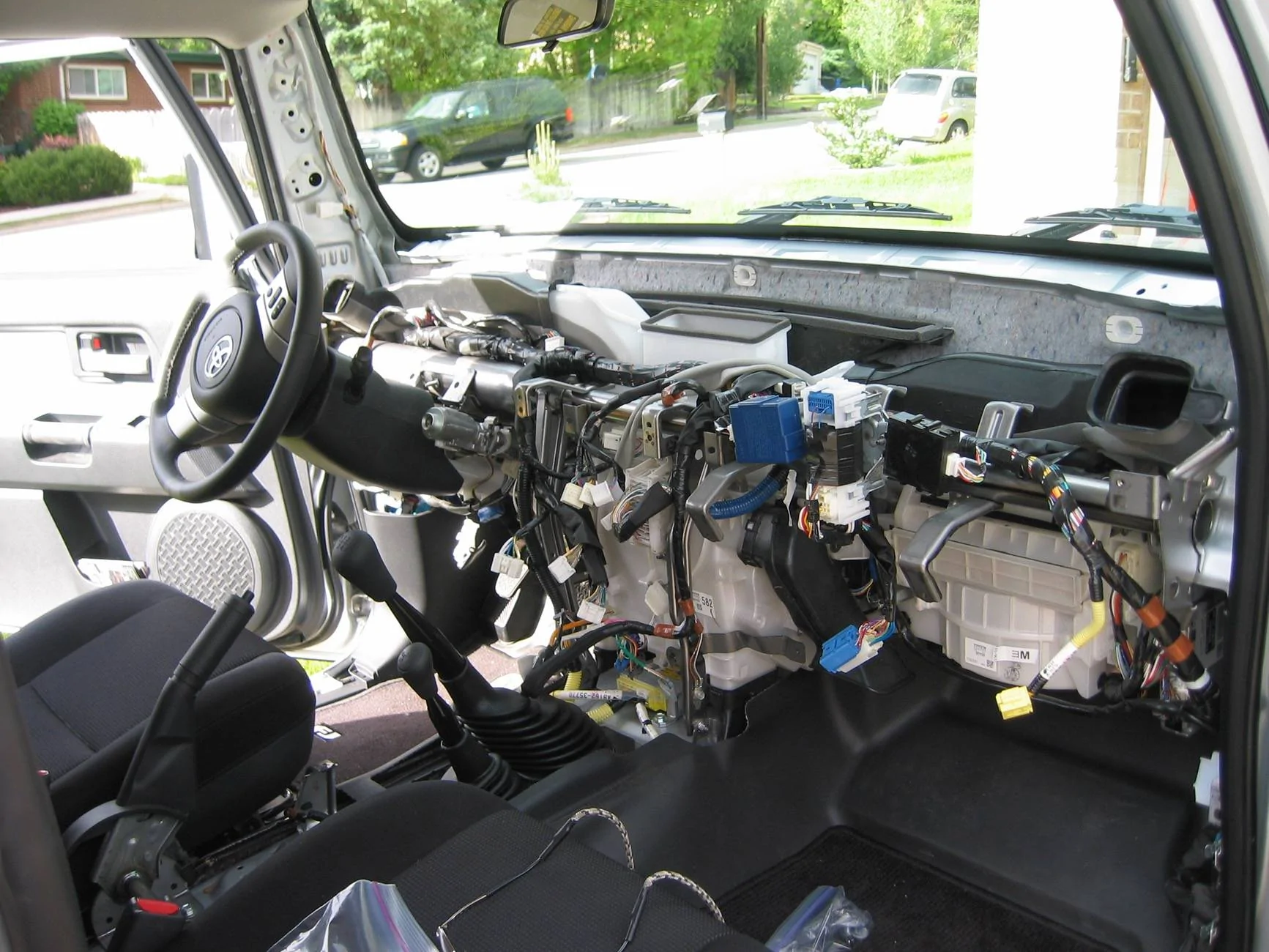

Here's the video that helped me most with the 2024 dashboard disassembly:
The panel that gave me access to the area where I found the connector was removed at 14min, 24 secs i.e. the speaker trim panel. I then loosened the speaker box/ pod via its 3 screws to give more wiggle room. The 3 screws were located 1) top screw was behind the pink connector (looks like an antenna connector to me) in the photos above, 2) 2nd screw at the bottom securing the it to the horizontal aluminum support bar, 3) the 3rd was to the left on the panel facing the door. As you look through the crack/ gap between the top of the speaker box and the structure above it, stick your finger in towards the top left. It was there out of sight.
At 14:19 I think I saw his soul leave his body. I did a similar dash removal on two Toyota FJs to,swap for a completely stupid part I wanted. Took us about 6 hours. Never again lol. EXCELLENT video thanks for posting it
