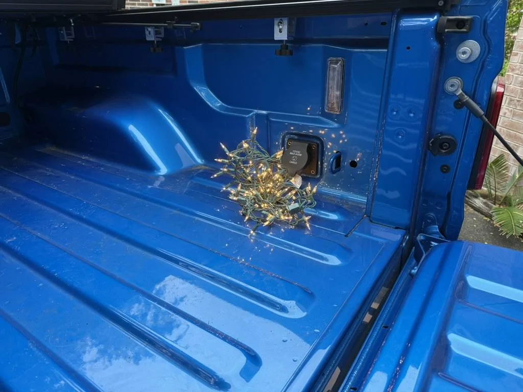

And tonight it's alive!!
I got my OBD2 and wire harness in the mail (amazon), installed Jscan app. Paid $20 for the single VIN permission and turned on the power to the outlet.
Seems like this whole install shouldn't have taken over two months to figure out. Given how "easy" it is when you actually know how to do it.

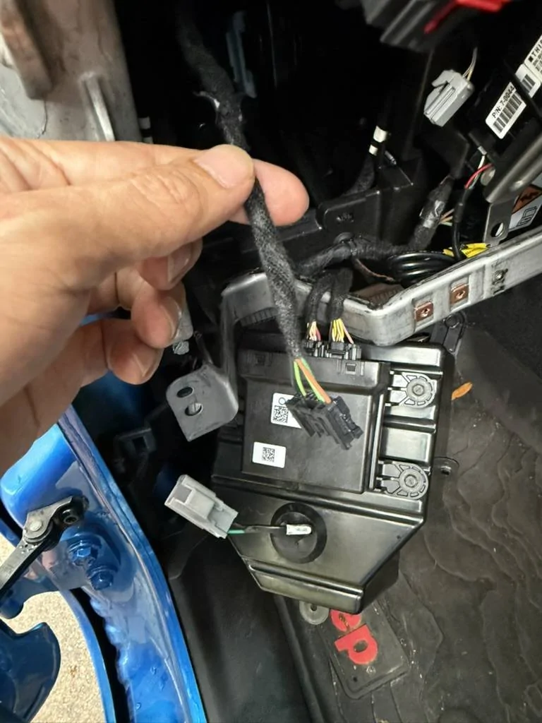

Had some free time today to install the the outlet and attempt the lower dash knee speakers again on a 2024.
I found the connector tucked and taped with the harness for some kind of antenna hidden behind the main light controls. I don't think I could have gotten to it without removing the driver's side speaker pod.
@AllMoparParts.com, I ordered the kit from you but the 4 plastic nuts were not included in the package.
