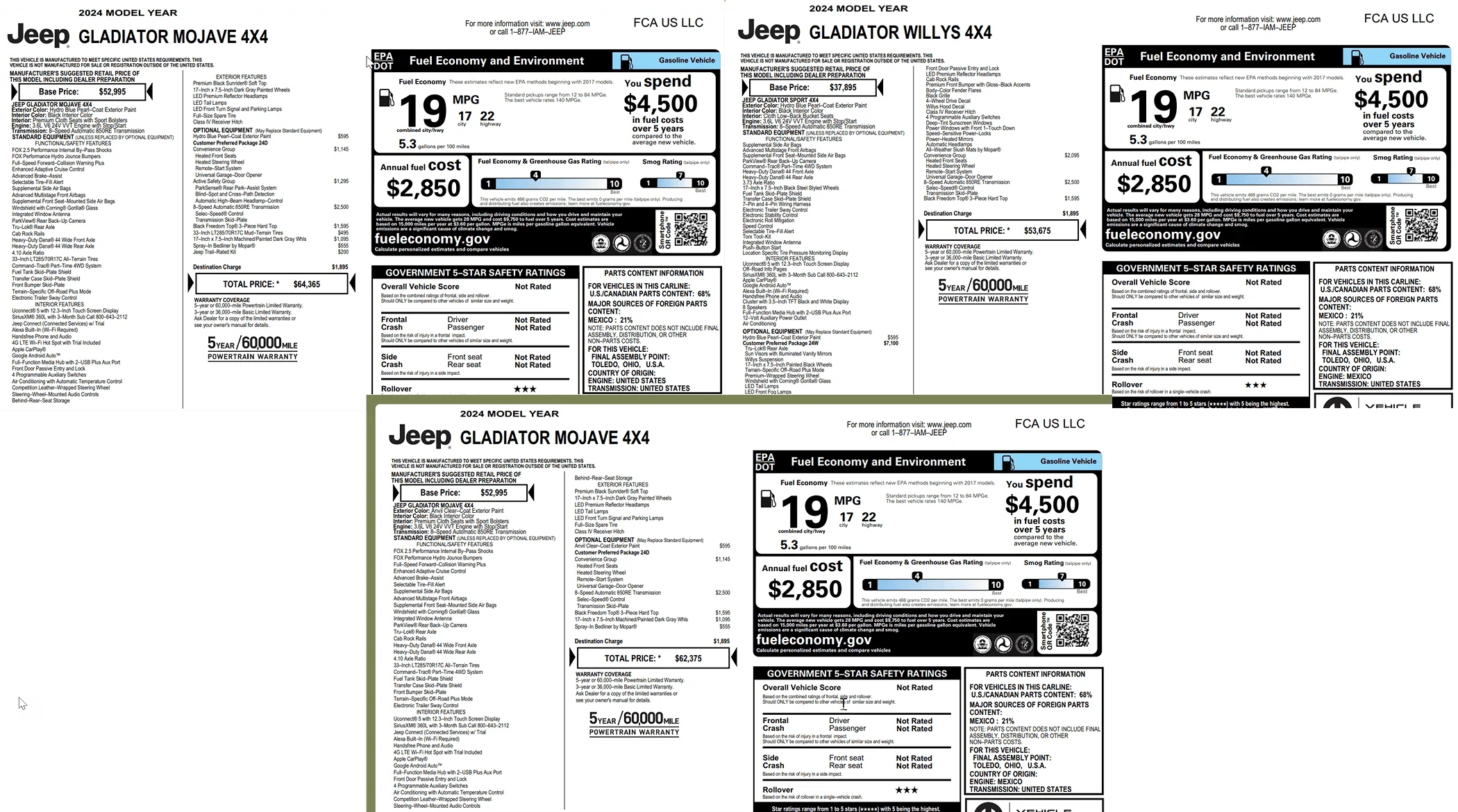

I've scoured the order guide and can't see anything other than standard axles and 3.73 ratio.
Willys - 2TW - has a lot of stuff like LED lighting and so on, but not the 4.10 unless I missed it in all of those pages.
Right. Here's the ones I'm looking at. The main Mojave I'm eyeballing is the Hydro Blue Pearl one, but the Anvil one is pretty attractive too. I like the color choices the most (I love blue), but the blind side sounds appealing since my last vehicle had it.
Seems like that link isn't working for me, maybe this'll work.
Jeep Gladiator 2024 Willys versus Mojave 2024-05-05_23-08-21

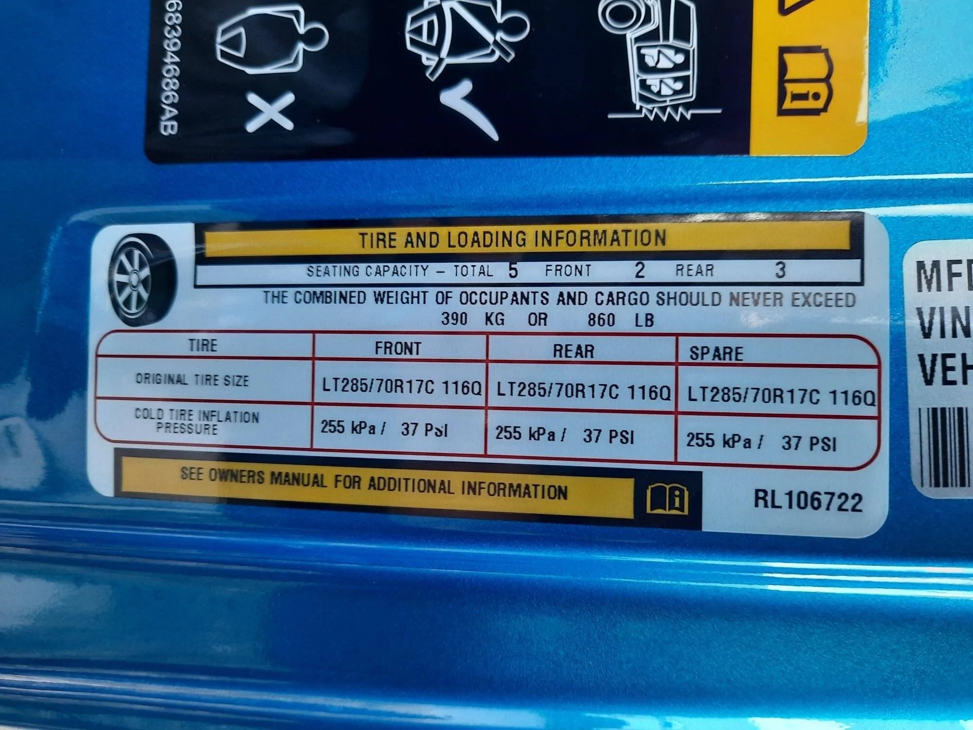

and the 24 Mojave X is reported to have a lower payload , but bear in mind that has steel front and rear bumpers.
Steel hood (at least in most cases) those steel bumpers front and rear with bed guards on the rear, and very heavy rails along the rocker panels that likely weigh in at 50 pounds each.
Then there's the weight of the power seats.
GVWR is 6140.
From a 2024 Mojave X. Maybe the metallic paint has something to do with it?
860 pounds payload. It's a heavy truck!
Jeep Gladiator 2024 Willys versus Mojave Mojave-2024-payload
