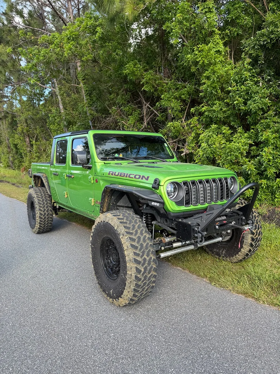

I have tried not to post and have searched to see if anyone has experienced this but I am truly at a loss and figure it is time. First off I will start with the build:
2025 Jeep Gladiator Rubicon
6.5" Evo enforcer level 4 lift (now with 4.5" springs) front control arm correction brackets
Apex Chassis Aluminum 2.5 ton steering with drag flip
Synergy track bar relocation bracket
Synergy sector shaft brace
Currie 5.13 gears
Adams 1350 front and rear drive shafts
Fox 2.0 shocks
Rear drive shaft carrier bearing drop
40x13.50x17 Nitto Trail Grapplers
I had all of this installed and took my keys on 1/9/2026. After completing the break in period for the gears We put in the front drive shaft and immediately there was a vibration. At this point it still had the 6.5" springs. The shop adjusted many things for months and I even sent the front drive shaft back to Adams who rebalanced it. I then brought it to another shop who had it and aligned and adjusted and finally we lowered with the 4.5" springs but the vibration is STILL there. The vibration is theere between 55-70 mph and also at low speeds approaching a stop you can hear the front drive shaft grinding...
It is a 2025 so the FAD is not there so this front shaft is contantly spinning. I have searched and searched and see so many 2024+ JL's and JT's lifted with 4.5 and 6.5 kits and not having the issues I have. I am being told there is nothing that can be done unless I get a free spin kit or go with a different (one ton) front axle that doesnt spin. I truly am at a loss as I am $17k ish into this build with just the above and labor and not to mention the time.
Anyone experience this? Successfully fix this? Any insight? I am at 6 degrees of castor and that is what they are telling me we should be at. The pinion angle was only reduced 3 degrees going from the 6.5" springs to the 4.5". the front axle was over 20 degrees opetation angle. I am not a technician nor a mechanic but I am truly just wanting my JT to work and be AMAZING...

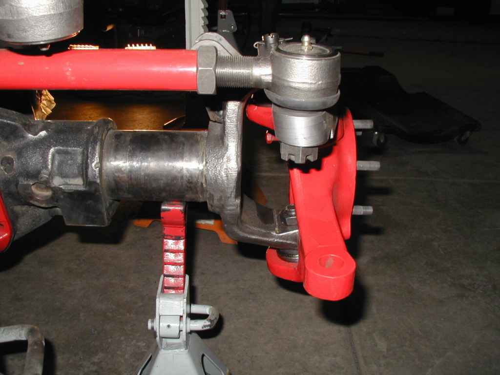

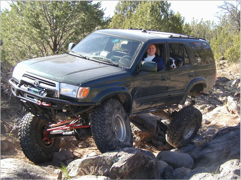

Back when I did a custom lift on my 99 4Runner SAS conversion, I swapped in a D44 from an old Jeep Grand Wagoneer. I installed 12" coil suspension up front and to get the axle Pinion pointing towards the transfer case, without inducing Death-Wobble, I had to cut the inner knuckles from the axle tubing, rotate them accordingly, then reweld them. This actually worked VERY WELL, and allowed me to have vibration free miles of smiles. The guys who did the alignment were really impressed with the work, stating it was closer to spec (Grand Wagoneer) than a lot of vehicles they have worked on.
