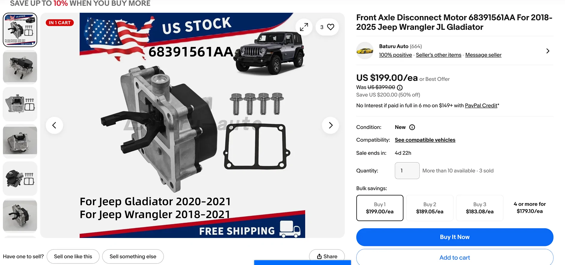

i wonder if anyone has experience with this. half the price from what the dealer is telling me.

No experience with that, but personally I would either go with OEM or used OEM. I would think there are enough in junkyards to make it possible to find a used setup, complete.
Or look it up in one of the many discount Mopar online suppliers.
https://www.mopar-direct.com/oem-parts/mopar-axle-locker-actuator-kit-68391561aa
More expensive then the offbrand option, but a lot less then dealer retail.

Yeah, that’s almost $200 less than what I got quoted from the dealer

As long as they don't nail you on shipping, the online OEM parts stores are usually a better deal than the local dealer.
An exception to that was recently buying a running board for a Silverado, the online supplier was way cheaper but killed me on shipping because of size / weight. Ended up just buying it from the local dealer.

Ouch yeah I’m always leery on buying from those sites. Is this a good site? I don’t want to bend and pay the $474 at the dealer…

It is, in my experience, OEM parts. They all use the same exact website format. Just find the one that has the best price including shipping. I did not look for that, and I don't know where you are so I don't know what shipping will be to you. But I have bought from these types of sites with zero issues in the past.

good to know thank you!

I see ypu went to ebay , see if you can find the actual Mopar unit used the motors are very resilient. Try lkqonline.com
