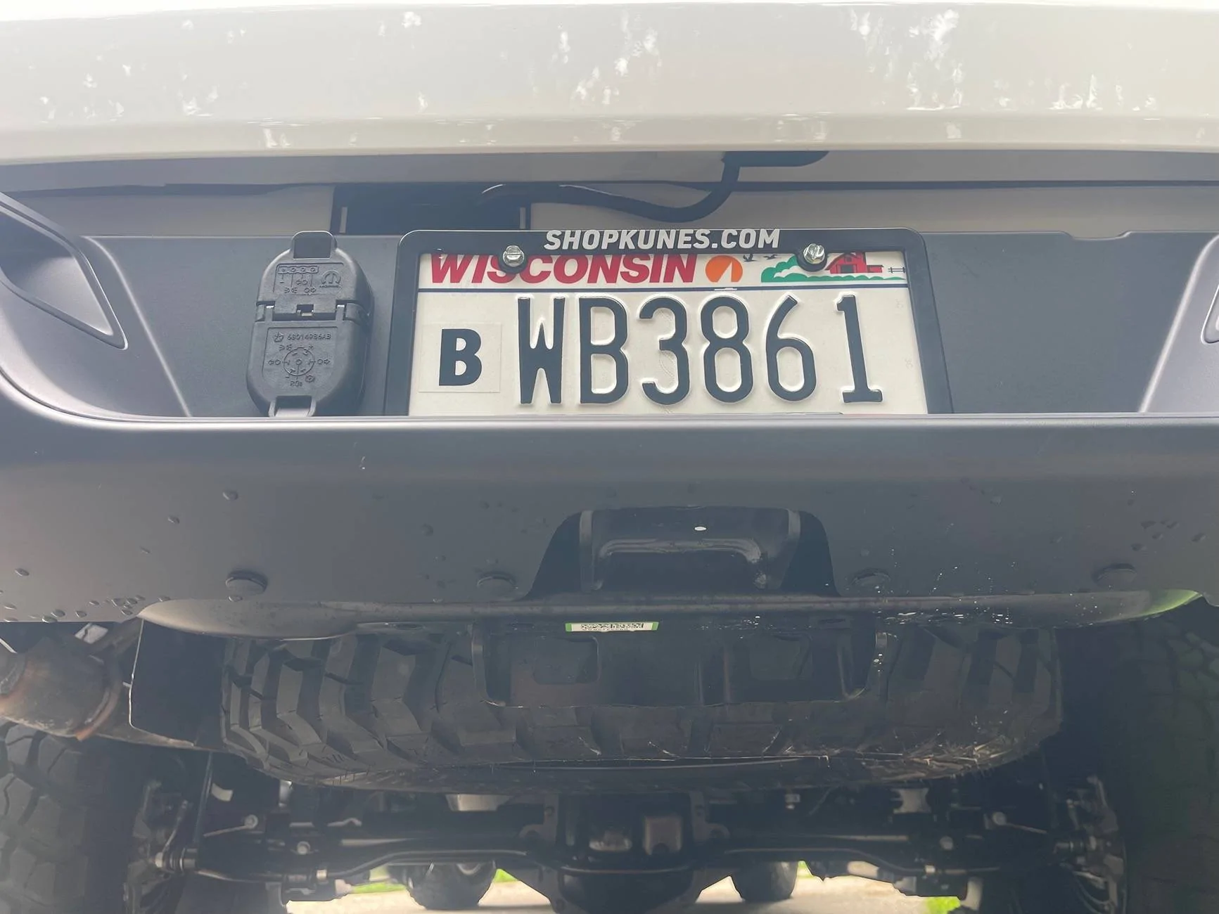

Jeep Gladiator 2025 High Tide - Towing IMG_9921
hardwaremike
Jul 10, 2025
Wisconsin
2015 Jeep Gladiator - High Tide
A fellow at O'Reilly's said it does have the bar on it I just need to drill the template on the bumper and get a tow ball.

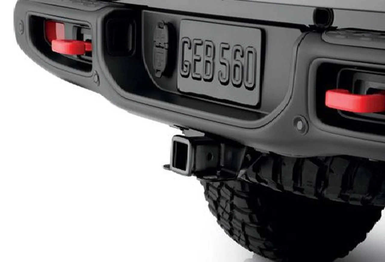

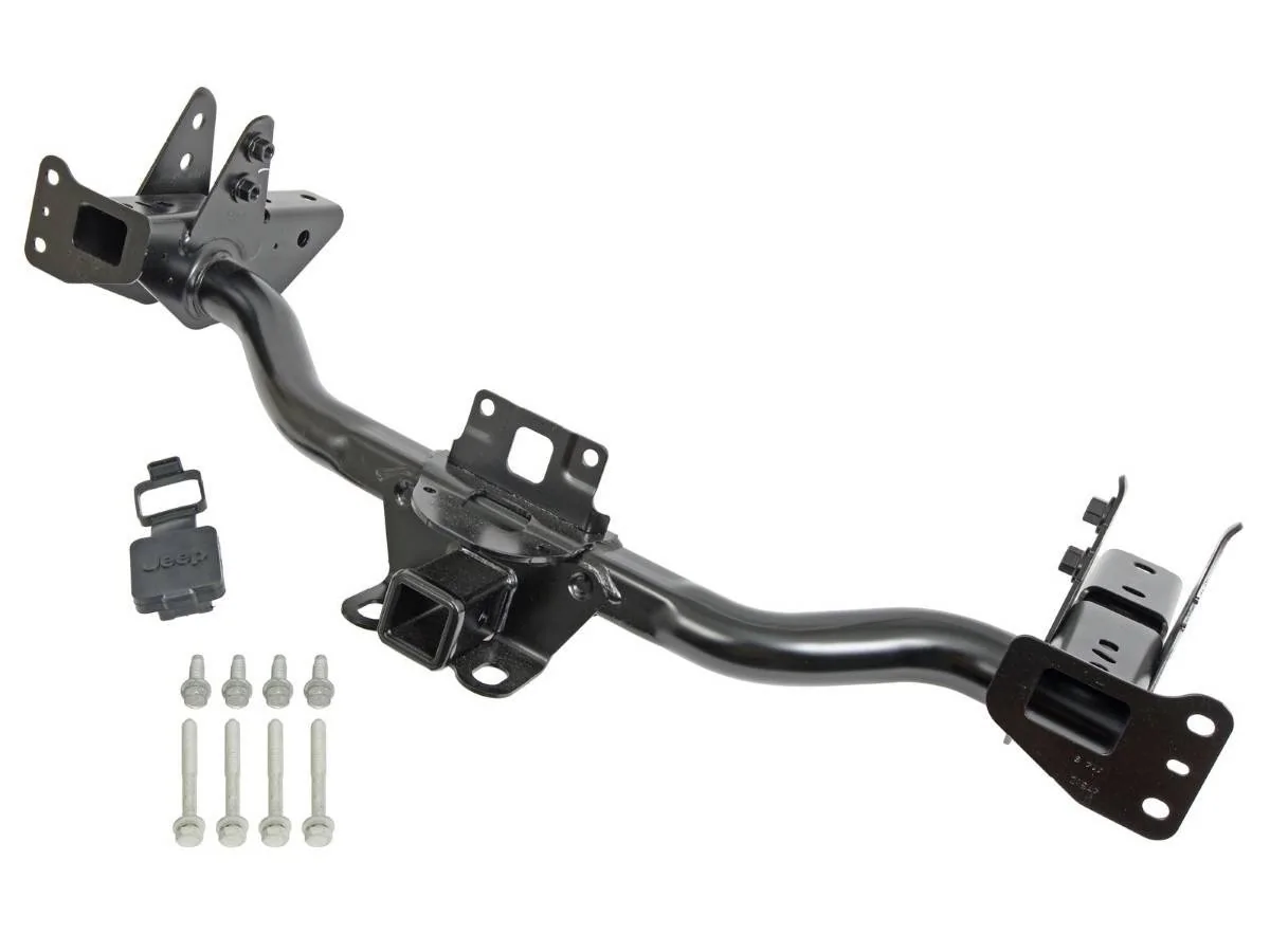

The proper class III hitch from MOPAR and what comes with the factory tow package is:
https://www.allmoparparts.com/sku/82215648.html
Replaces 90% pf what you have there already under the bumper but lacks the Class III hitch receptacle.
My base Sport also came without the Class III hitch. I chose to use a bolt in adapter from Quadratec:
https://www.quadratec.com/p/quadratec/premium-2-receiver-hitch-jeep-gladiator-jt
Links to my install is here:
https://www.jeepgladiatorforum.com/forum/threads/2025-base-sport-anvil.88796/#post-1430750
Regardless of which one you put in, you are still only legally rated to the 4500 lbs tow rating your vehicle came with.

IMO, you want to end up with a receiver.
I tend to go the full route, the MOPAR receiver bar that replaces the cross member at the rear.
Hootbro has had good luck with and likes the bolt on less expensive solution.
In your case? I can't say it would really matter - pick one and go with it.
But I would go receiver, not a ball on the bumper.
Why not the ball?
You can't control the height of the trailer tongue - it's going to ride the height of your bumper.
With a receiver, you can buy the ball mount that places your trailer LEVEL behind your tow vehicle.
You want to tow a trailer level as possible, more critical with a two axle trailer, but even with a single axle, it can really matter as far as how well it tows.
If your trailer is low, you can buy a ball mount that will slide into that receiver, lower the ball, to let your trailer tow level. Can't do that with a ball.
So I'd pick something like Hootbro's receiver solution if you really want to save money and easily tow your small trailer(I see no reason not to go that route in your case), or you can go the full receiver that replaces the rear cross member if you prefer "factory" (but more expensive) and I'd skip the ball on the bumper bit.
