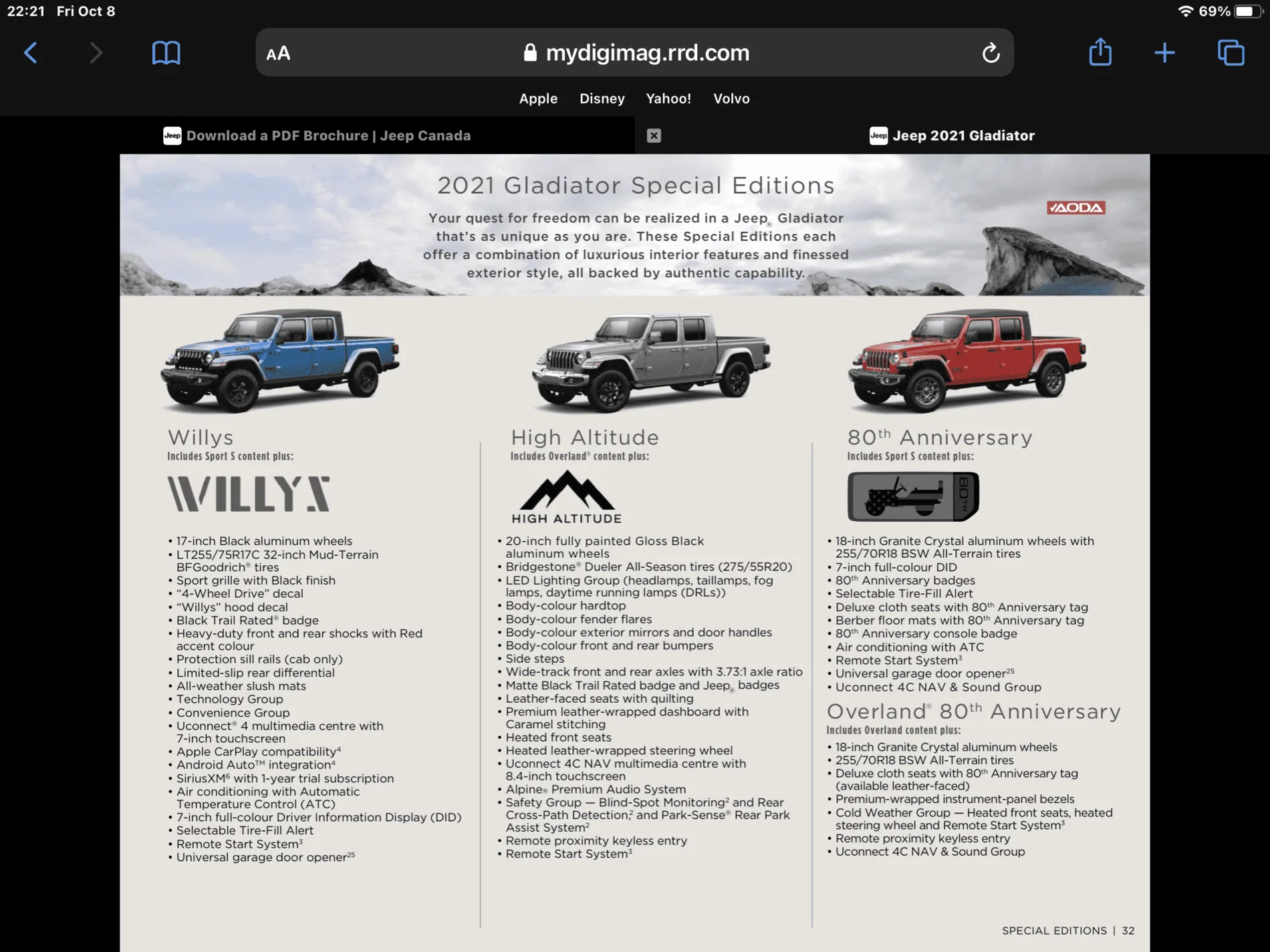

High Altitude comes with the wider axles, and Airlift airbags will mimic stiffer springs for about $120.
It does?
I thought the HA was essentially an Overland with an appearance package.

Good to know.
3.73 gears. That’s the killer.
HA does not come default with cold weather package, would have liked this. About the only option I dont have

HA is a city rubicon, no lockers, no disco, all the safety bells and whistles
