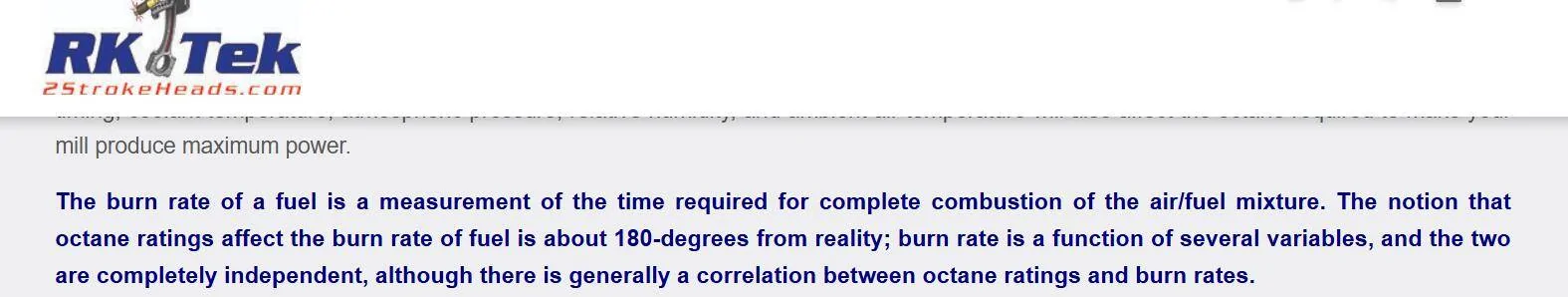

I suspect it is due to the limits of the Cam Phasers to retard timing enough to account for slower burning fuel that higher octane is composed of.
Octane doesn't burn slower. It simply resists self-ignition.
Same energy content, same burn.

The cam timing isn't going to depend on how fast or slow a burn is - it has no real idea of that, there's no sensor telling it of burn completion, only oxygen content of the exhaust.
That will impact fuel mixture.

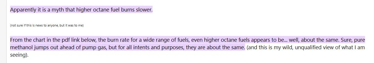

The higher the number, the more difficult the fuel is to ignite. It does NOT mean the fuel burns any hotter or colder, or slower or faster. It was once thought that high octane burned “slower” and that was why it didn’t knock, but we now know that’s not true.
The reason for it, is because of the purity. Higher octane ratings have more complete strings of hydrocarbons and fewer “pieces”. Think of a container of cashews. You get a tub of “fancy whole cashews”. That’s like your premium or high octane. Most of the cashews in it are, in fact, whole. But there’s still some pieces, halves, etc. Now, take a regular tub of cashews. You will have a lot of whole cashews in the tin, but there will be many halves and pieces. And then there’s the tin literally labeled “cashew halves and pieces”. There will be whole cashews in there, but more pieces than whole. That’s your low octane.
That matters because complete strings of hydrocarbons have to be broken down before it can combust. A full string is harder to break down because the bond between atoms is stronger than a broken chain. A partial chain takes less heat to break apart, so it will ignite at a lower temperature and pressure. Once broken, they are all hydrocarbons, so they burn at the same speed.
Research shows that the flame front generated in the combustion chamber has a set speed for Regular and almost exactly the same speed for Premium. There is a difference, but it is very slight. This is a requirement of commercial grade fuels for the public to use in piston engine aircraft and automobiles. Other racing car fuel blends can be quite different though. Confusion arises when ethanol is part of the fuel blend, because it takes more heat energy to turn it to vapour, so causes the engine to run cooler. There is negligible difference in the flame front speed of the blend though.
Premium high octane fuel resists any secondary ignition that may be caused by the compression increase plus the increased heat of the ignition. It does not burn slower, just resists having that second flame front. Regular low octane fuel in a high compression engine is affected by the ignition temperature and the sharp increase in pressure. This can cause a second flame front to develop away from the first. This has nothing to do with either a fast or slow burn, just a second place the flame front is moving across the air fuel mix. The problem comes when these two flame fronts converge, because a supersonic shock wave happens at the convergence. This is called detonation. Pre-ignition is a totally different thing.

Similar for the slower burning. That likely originated when lead was taken out and gasoline suppliers scrambled for ways to increase octane. A lot of things were tried and used, and back then, some really complex circular chains got used. However, without a big chemistry lesson here, those also left behind a lot of soot, and had other issues, carbon and so on.
The idea of the slow burn stuck, even with other compounds used to increase the octane in gasoline that have similar burn speeds to plain gas.
