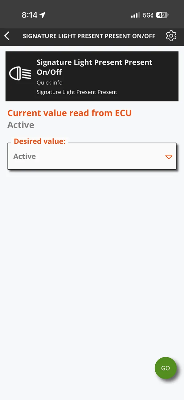

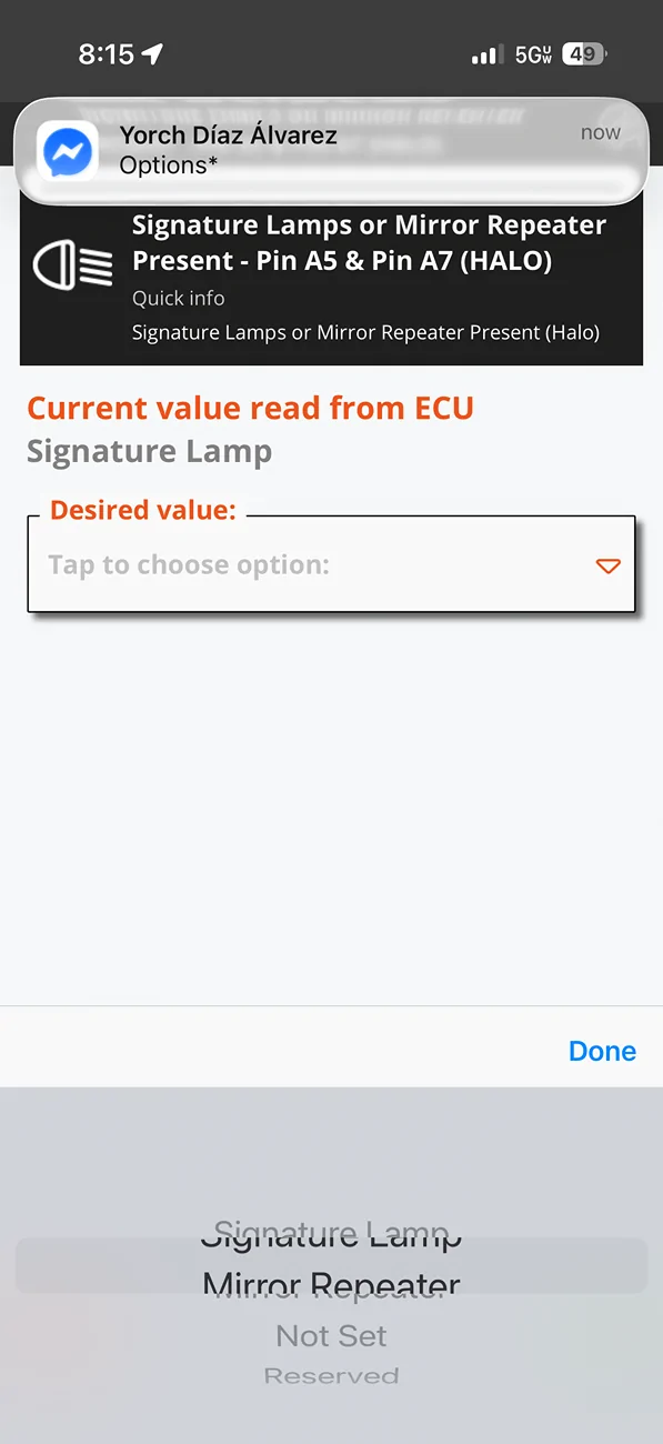

"Signature Lamps or Mirror Repeater Present - Pin A5 & Pin A7 (Halo)" setting, and the "Signature Light Present Present On/Off"
correct. I did those two settings. Made the one active and the other as signature lamp. Would the grill lights affect it? A different Jeep accessories company installed those separately way beforehand. Those come on when the car turns on and with the ACC

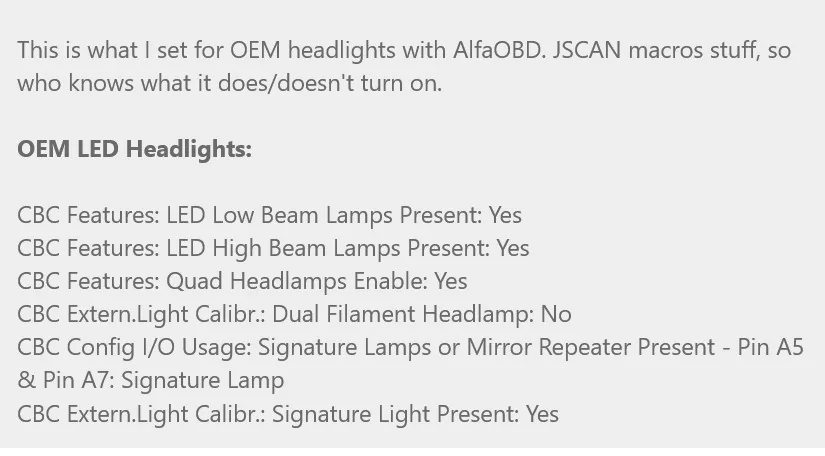

do you have a list of your configuration.I think this is what I used when I went from Halogen to LED W/halo enabled 2023 Mojave
Jeep Gladiator 2025 jeep gladiator nighthawk upgrade to LED OEM LED config
I only have the jscan but I have all of those settings except the Quad headlamps enable. What’s Quad?
