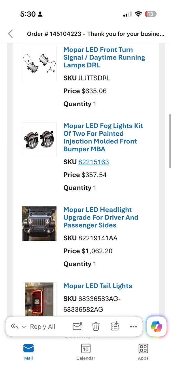

I recently had new LED Mopar headlights kit, front turn signals, tail lights, and fog lights housing installed by a reputable third party company on my 2025 Jeep Gladiator Nighthawk. Original halogen packaging (The part #s are the Sku#s there in the picture attached.)
The people who installed it said all works except I need to take it to a local dealership to get the system reprogrammed to LED. It’s a MUST even according to mopars site. Needs codes LPY and LPX. After my second trip to the dealership, Dealership said they can’t install the code LPY??

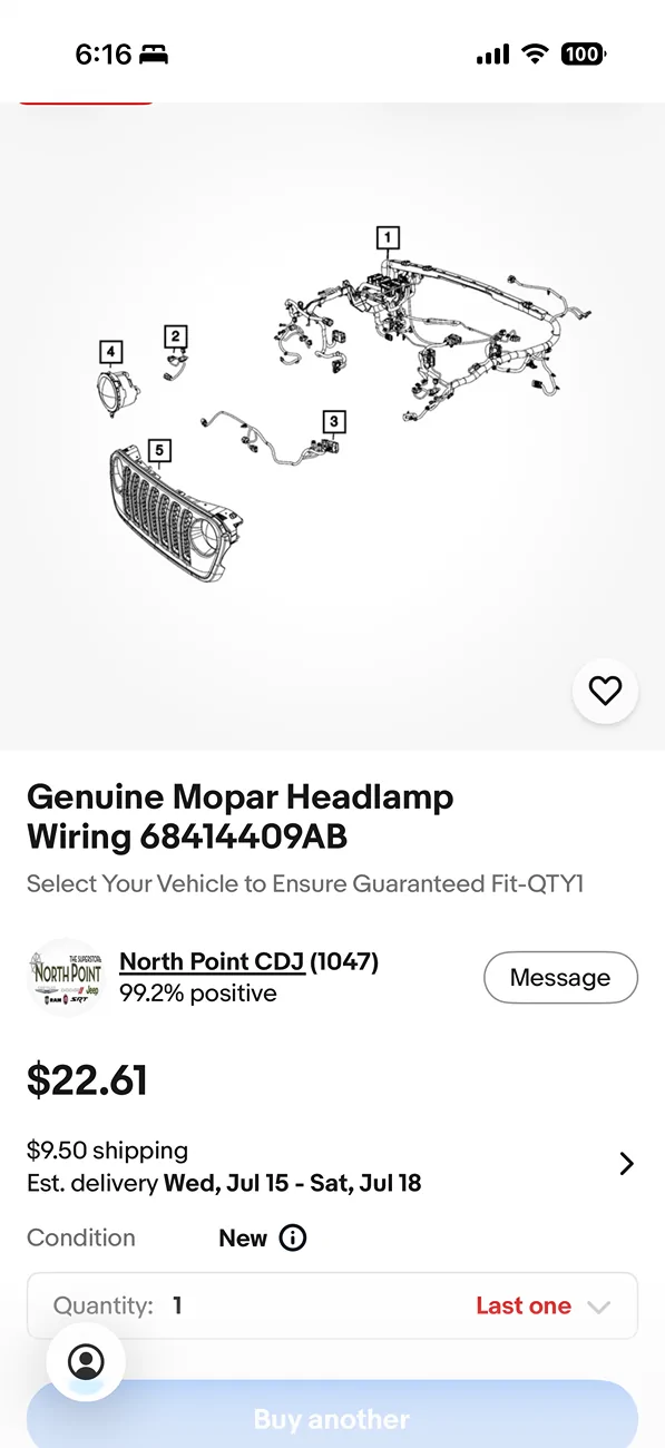

Will do. I do think the unpinning of pin 1 will work. I’m assuming the people who installed would be able to do that for me? Or would any auto parts? I want to avoid the dealership like the plague. The dealership did do their part and added the LPX code and made it all LED
Now as for the daytime running halos on the headlights? Will that need a 4th cable? Confirmed with the installed that there are 4 cables coming out of the headlights? This would be the part I need though
As of 2021 all JT have the 'Halo wire' in the harness... as far as I know. 2020 had to run it. BCM programming should turn it on.
