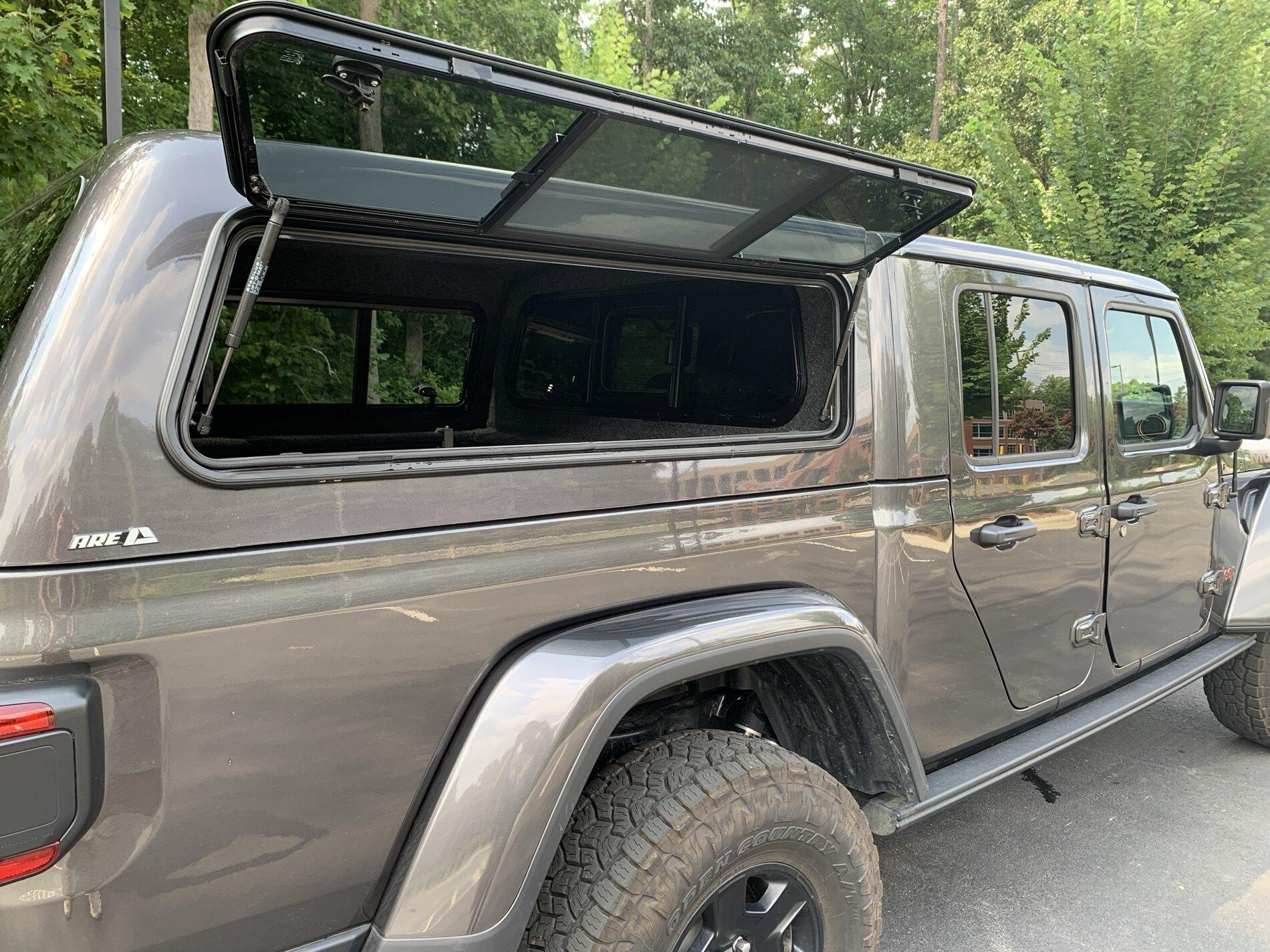

Continuing to catch up... a few months after lift I received my cap & bedslide.
My wife was pushing for the topper and to be honest I really like it. So much room for cargo and it's protected from weather. My wife overpacks... yes the family is comfortably prepared to be away twice as planned... but its a lot of stuff. We always struggled packing past vehicles. She can't fill this thing up and now everyone in the cab has room (no bags stuck around their feet).
Now that I think of it... I've been overlanding for years.
There's a measurable squat after 170lbs (topper) & 80lbs (bedslide). I expected some but it was more than I expected. The weight is starting to stack up now.

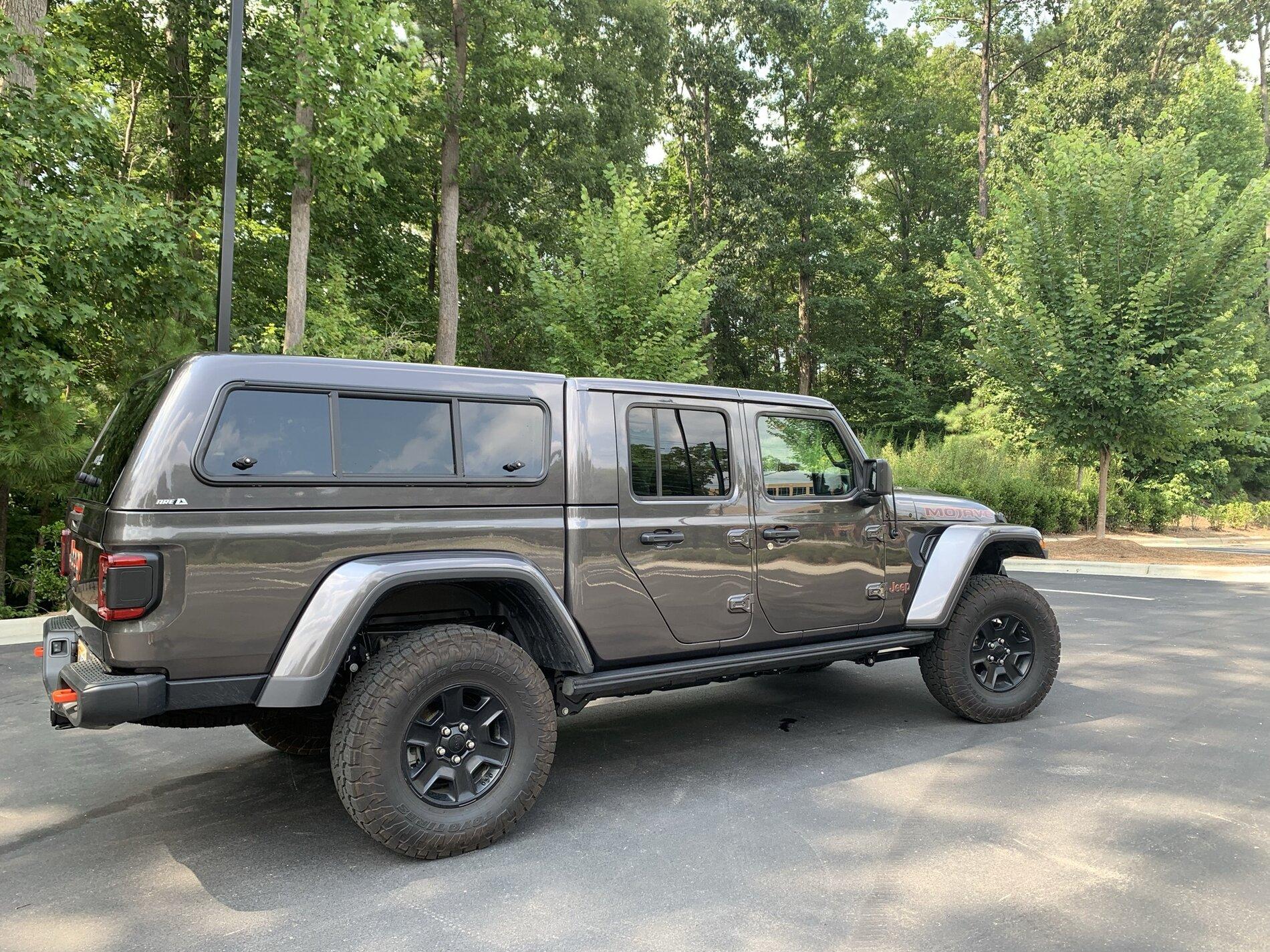

Can't really see the squat here, I'm on a slight downhill slope.

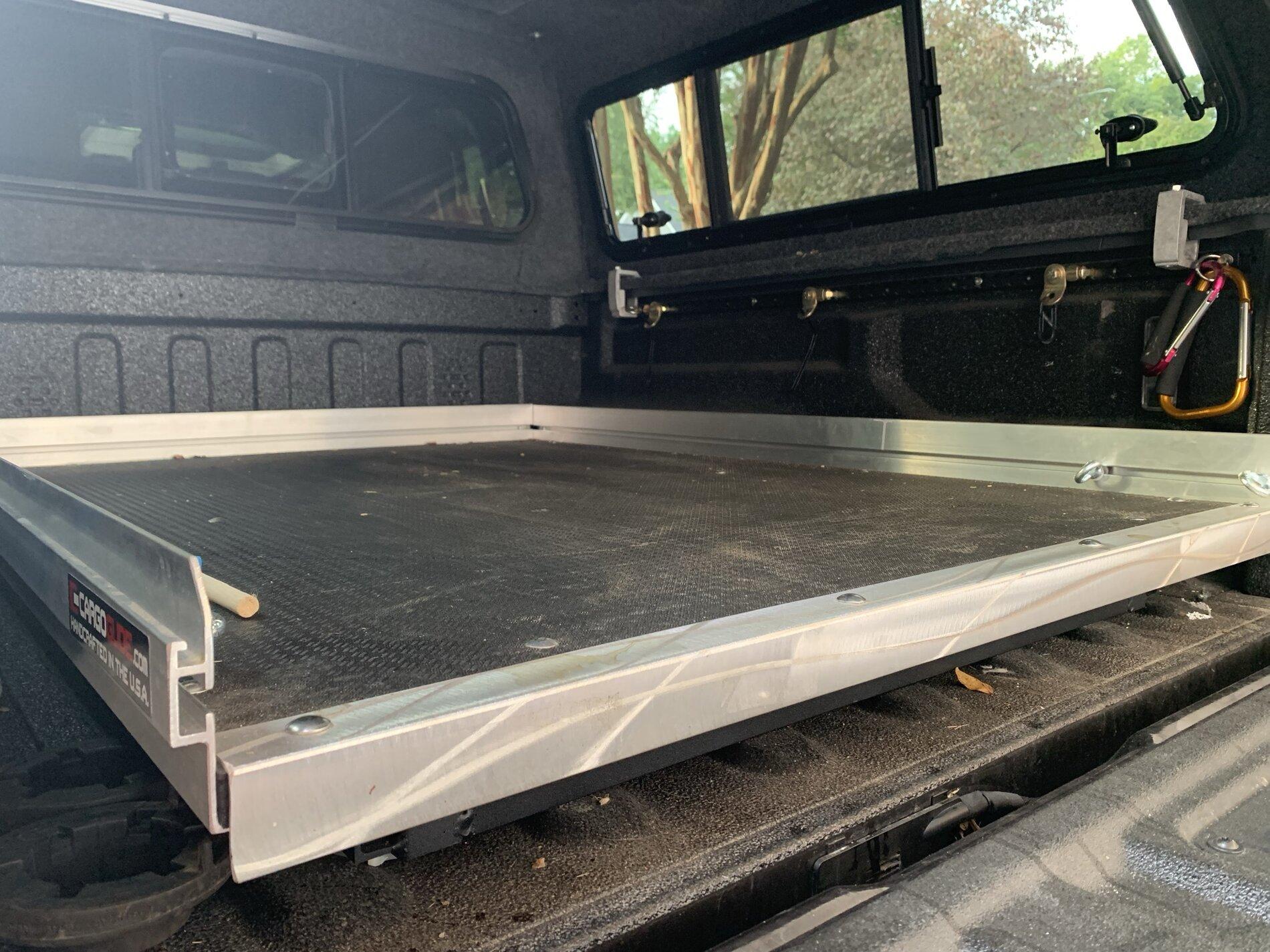

I got the full open windows incase I pulled the bedslide out. The cap really limits your ability to throw/grab stuff out of the back. So far loving the bedslide.

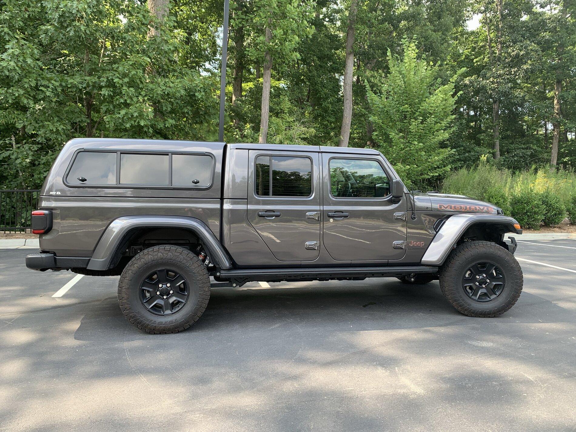

Surprised that the topper is that heavy.
Yeah, after the topper + bedslide then RSE slide steps... squat was just too much. Last week I pulled the rear stock coil springs and AEV spacer and replaced with a springs from Clayton for a 2.5" lift which has fixed the squat and ride. Best upgrade to date. I'll post a profile picture soon.

Added bedslide and more weight to the rear... 😞 but it's so useful!!!! Adds and extra 80lbs.

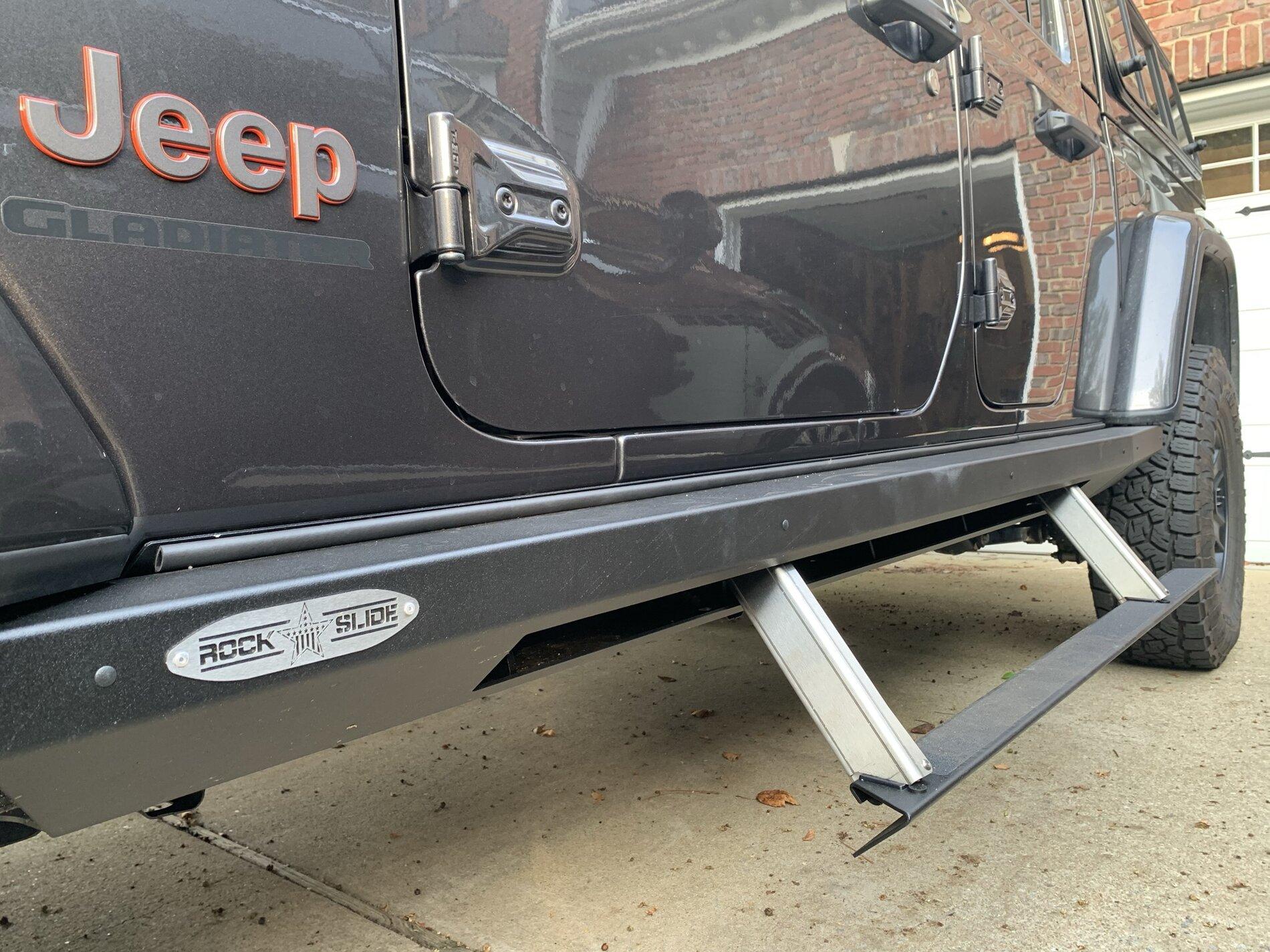

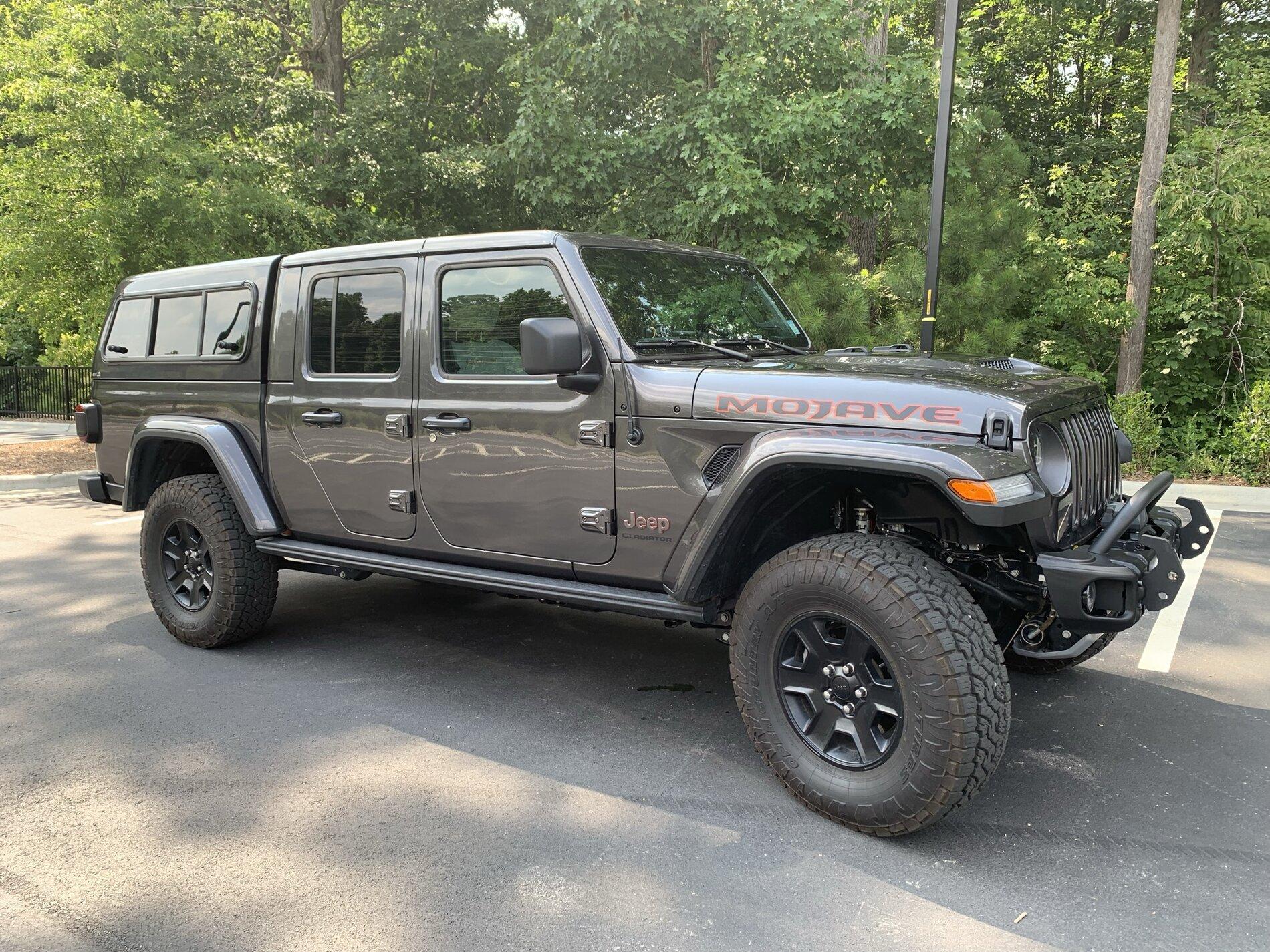

Added Rock Slide Engineering step/slides a couple weeks back; my wife and kids were struggling to get in/out after 2" AEV lift. The weight on this was 225lbs... I haven't wheeled with them yet; hoping to go out to Uwharrie in a week or so.
Install was smooth. I bought an inductive heater for the body bolts. I was terrified on this part of the install and it took me many weeks to build confidence; broken body bolt stories scared me.
https://www.amazon.com/gp/product/B07PCMRRFZ/ref=ppx_yo_dt_b_asin_title_o05_s00?ie=UTF8&psc=1
So, I heated each bolt for 30sec x 3 times and measure temp with temp gun. Once I reach >550d I used a regular 1/2" drive ratchet ... no breaker bar. Some snaps and pops. When I heard these I would reverse and drive bolt back in for a 1/4 to 1/2 a turn then reverse and continue backing the bolt out. induction heater was key here. Other than that, install was smooth.

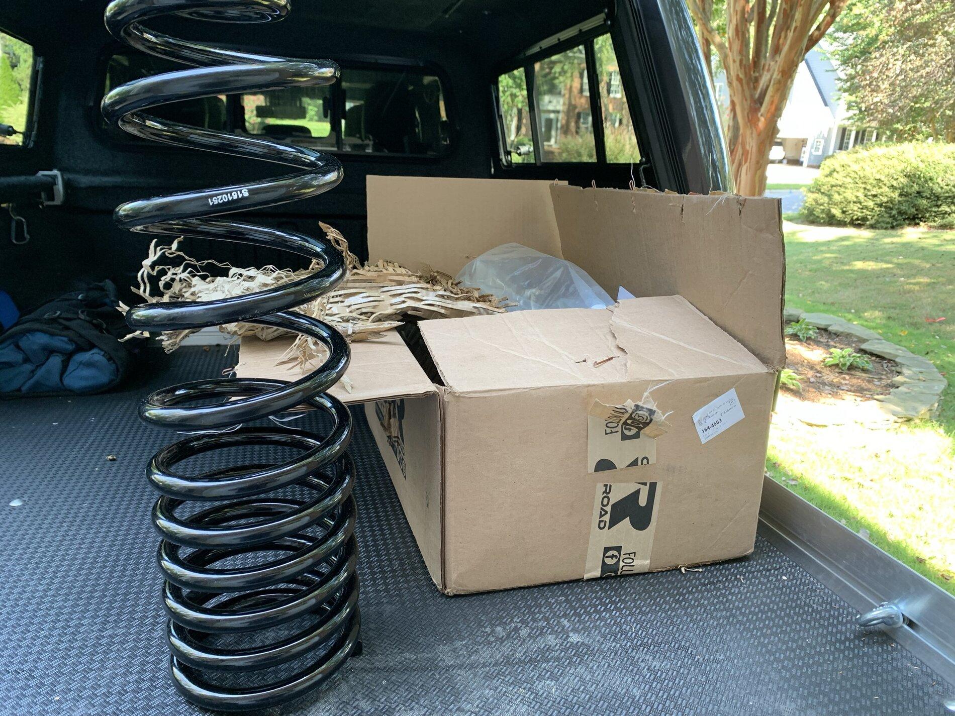

To help with squat (which was noticeable after cap, bedslide, RSE step/slide) I pulled our the AEV 2" spacer in the rear and replace with Clayton Offroad 2.5 Triple Rate coils.
https://www.claytonoffroad.com/product/jeep-gladiator-25-triple-rate-rear-coil-springs-2020-jt
This put the truck at the perfect height. There's a slight rake that I can measure (< 1/2") not noticeable but when loaded the truck is level and when I'm driving fully loaded I don't feel like the front is pointing high.

Will post profile when I can get a good shot.
