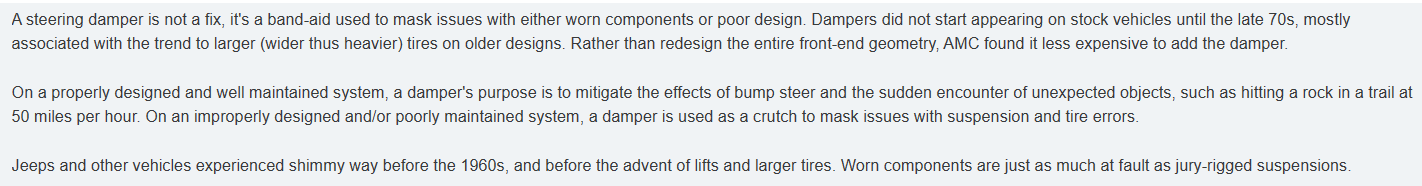

i swear FCA recommends steering damper/stabilizers because they are hoping it will mask the problem til it's out of warranty.
40,514
54,044
Sad, but I'm inclined to agree. That's their official standing and yet experts for years have said otherwise.
This ⬆. Steering dampener/Stabilzer is not usually the problem, and will only mask the true issue. As Bringthelightning said get them to re-torque all of the front end first. If any of those parts are worn out they will likely be the cause. The dealership should fix everything for you without question on warranty specially if you are stock. Report back once corrected. Good luck.
Yup - I've said it dozens of times here, and posted supporting evidence and commentary from experts 'till the cows came home and still........ few like to believe it, including dealerships.
This is from Norm Layton - look him up -

Body shop? Hmmmm, Maybe you mis-typed it. Not sure I'd let a body shop touch any steering or suspension. Maybe the dealership shop........ maybe.
Assuming your Jeep is truly stock - stock tires, stock wheels, stock everything - it needs to be checked out thoroughly for proper torque on all suspension and steering components, checked for loose, worn, bent or otherwise damaged parts.
