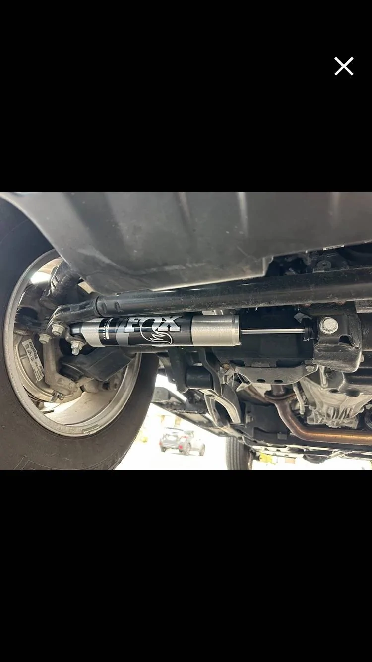

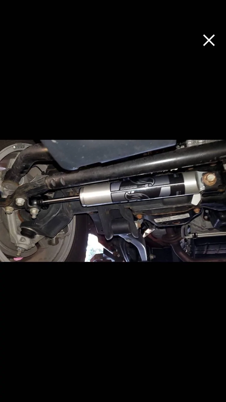

Fortunately I don’t have DW on my Glady, 3 years and 36000 miles. I did have issues on my JKRU but I changed the shocks and stabilzer and fixed my issues. My question here is as I prepare to replace my factory Stabilizer (which has worked fine) w/ a Fox, looking at these 2 pictures I found on install videos, which is correct or which is wrong? ?. Forgive me if this isn’t exactly on topic but I thought it was loosly related.
Doesn't matter. I have 2 JT's with the same fox stabilizer and they're both installed different from one another. Just like the pics. No difference whatsoever. If you must decide though, install it so the text reads normally. ?
Yeah, no use spending the money and then not showing off whatcha got.
