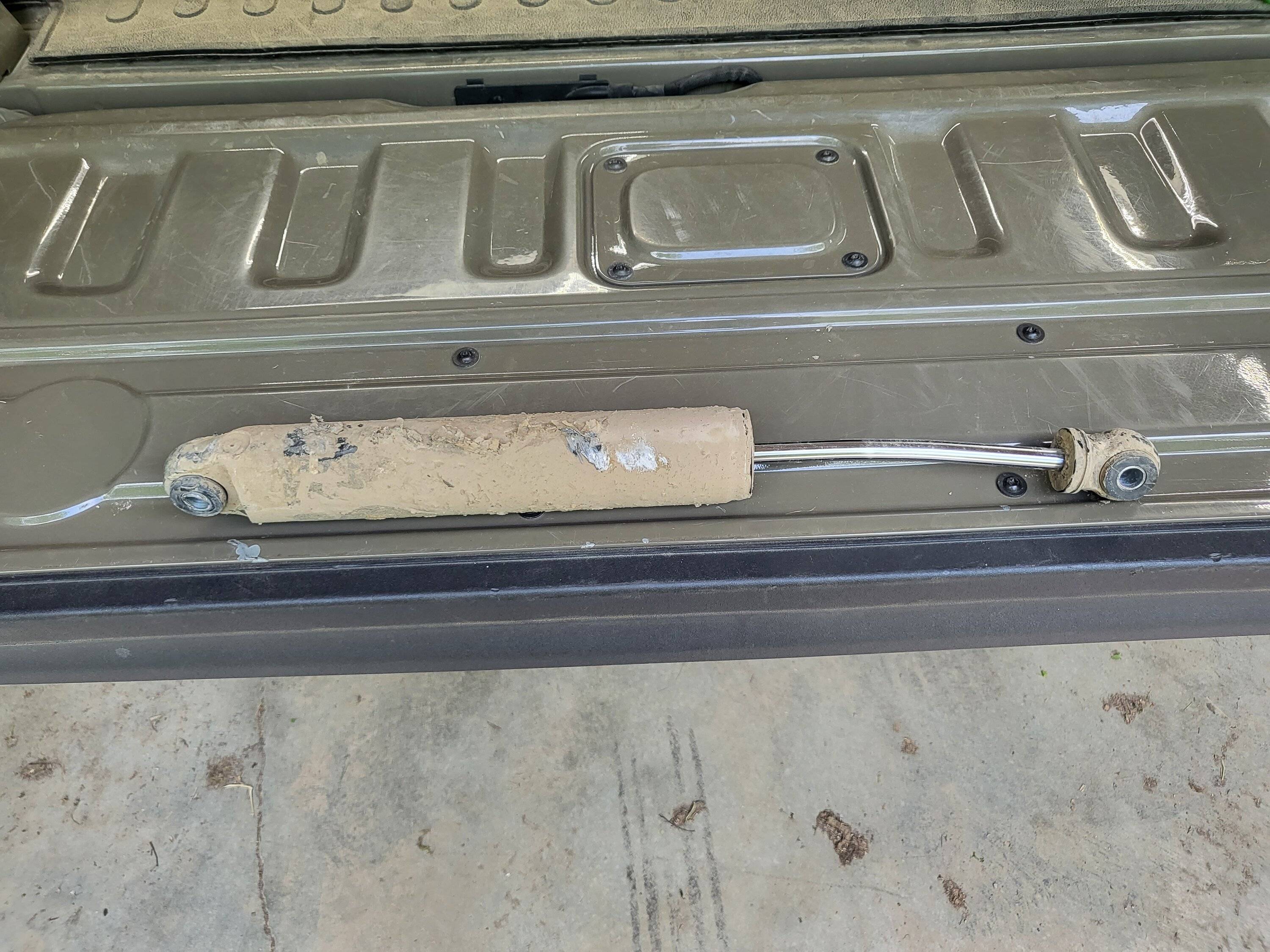

I have a stabilizer I'll sell cheap!! Just be ready when you turn hard left, it doesn't want to let you go back straight. Hmm, that almost sounds political! ?

That's the drag racing version........ keeps your wheels straight.
