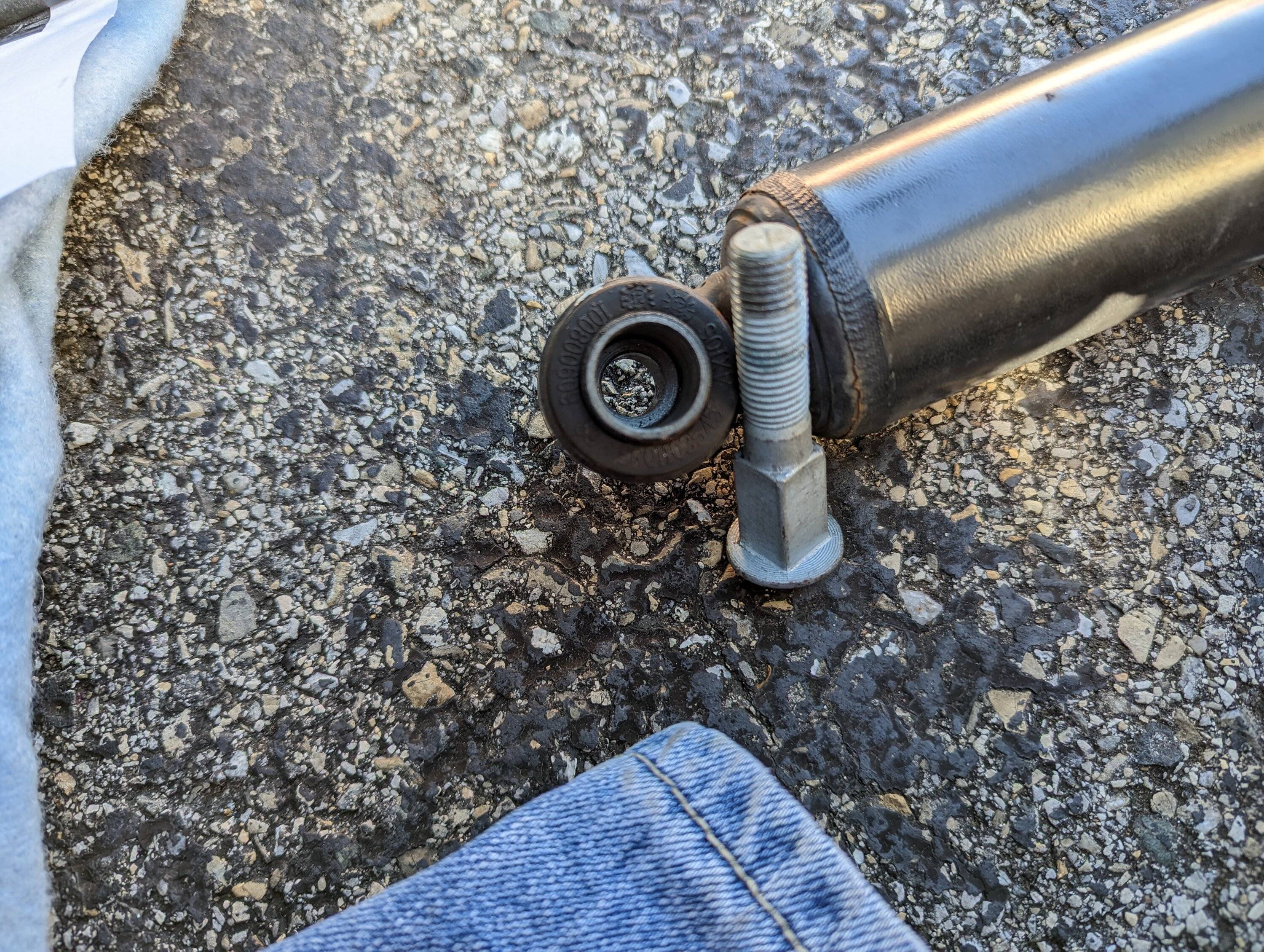

Dropped my jeep at the dealer for them to diagnose the death wobble. They claim its the steering damper which doesnt exactly surprise me. Down side is they also said they cant get a new one in for 45 days. So I ordered a skyjacker hydro 7008 and had it in 3 days. Figured it was 2 bolts, what could go wrong!
What went wrong is the square neck bolt on the tie rod end of the damper wont fit the crush sleeve of the skyjacker. Looks like skyjacker assume a round neck bolt, the factory damper had a wider inside diameter for 3/4 the depth of the sleeve to fit the square neck.
Question I have, is the square neck bolt normal on the JT? from what I could find for part numbers and the years they apply to the bolt (06513445AA) is for 20-22 JT and 18-22 JL. But I cant find a single oem replacement damper that appears to work with that bolt. Trying to understand if *all* the supposed oem replacement dampers online are advertised incorrectly or if jeep maybe changed things due to parts supply issues and the square neck bolt isnt really standard?
I also have a support request in with skyjacker to see if maybe what they shipped my had the wrong parts in the box but figured I'd ask here to see what others have run across.
