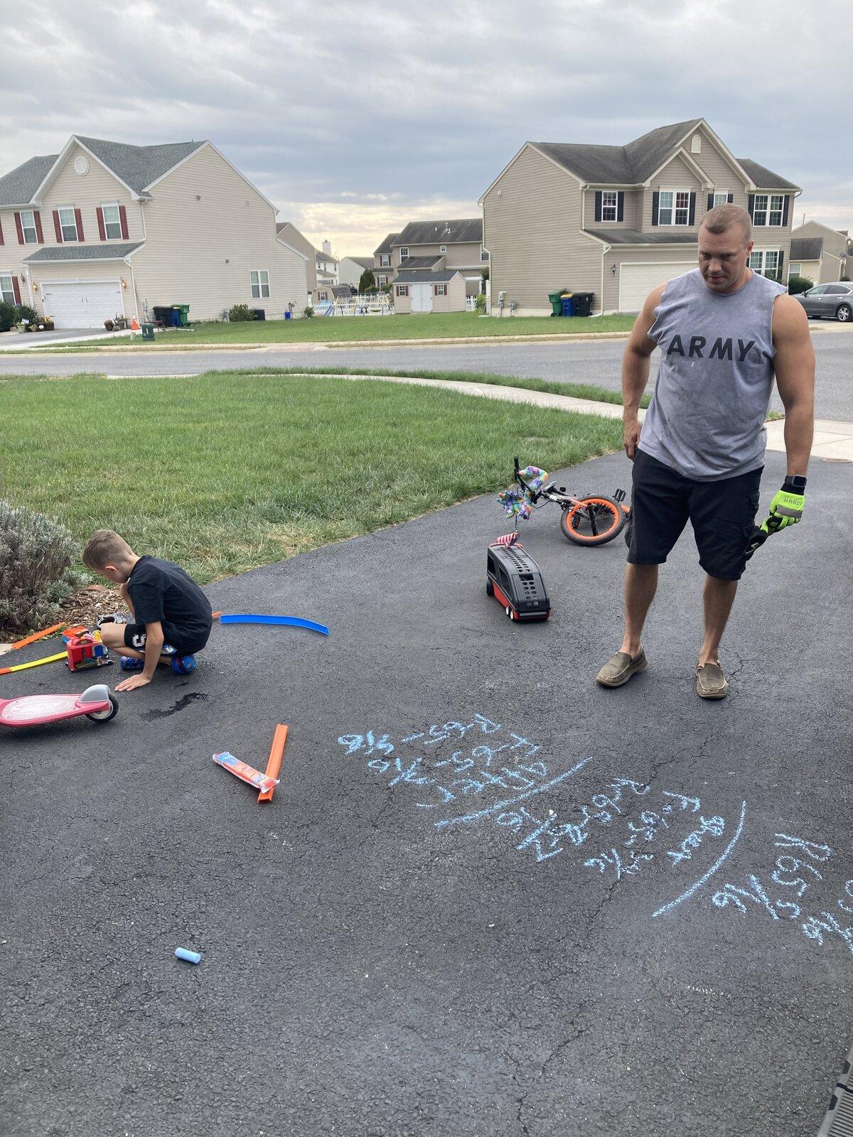

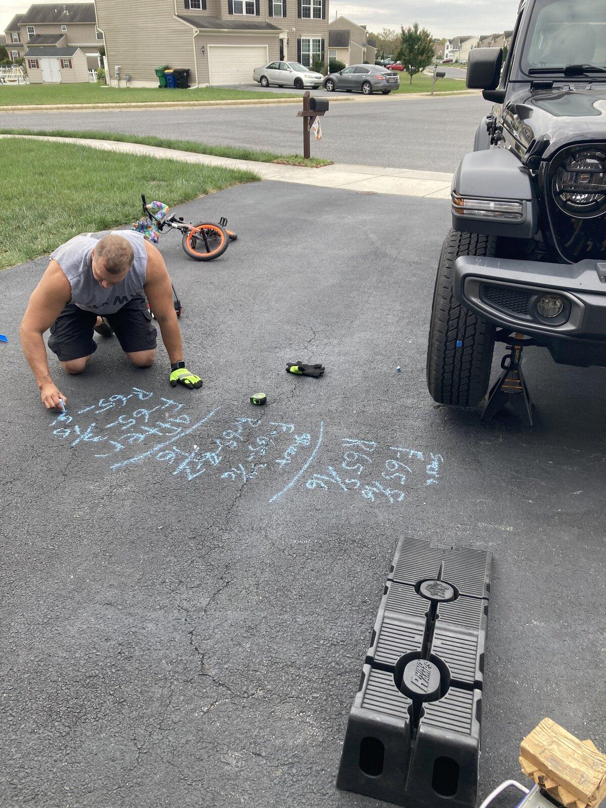

I picked the point on my tire for my measurements by measuring from the ground to the center of my axle and then putting a piece of tape in the same spot on both front tires. Pretty much mirroring the picture that Papa put up for us.
I did my initial measurements with the wheels on the ground
Then put the front axle on stands and repeated the measurement. (They were the same)
then made my adjustments with the front axle suspended.
after getting it set to where I wanted it. I locked it all in and did a test drive with some aggressive turns. Once i got home I rechecked and my measurements were about the same. They were slightly different, but still within spec. (1/8th-1/16th)
i had my wife help me which was very nice to have her hold the end of the tape measurer. Also having my kids sidewalk chalk handy worked out!
