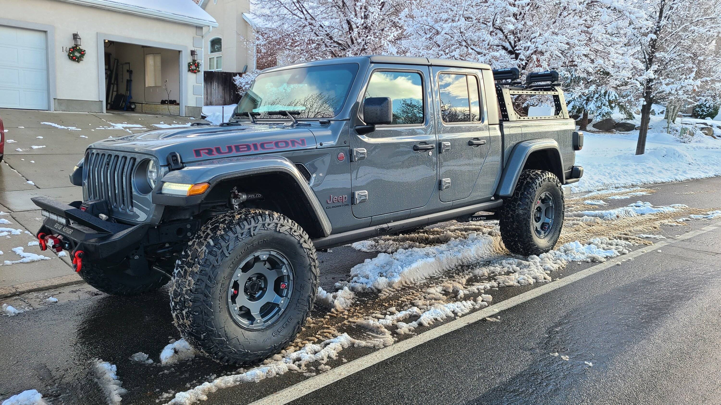

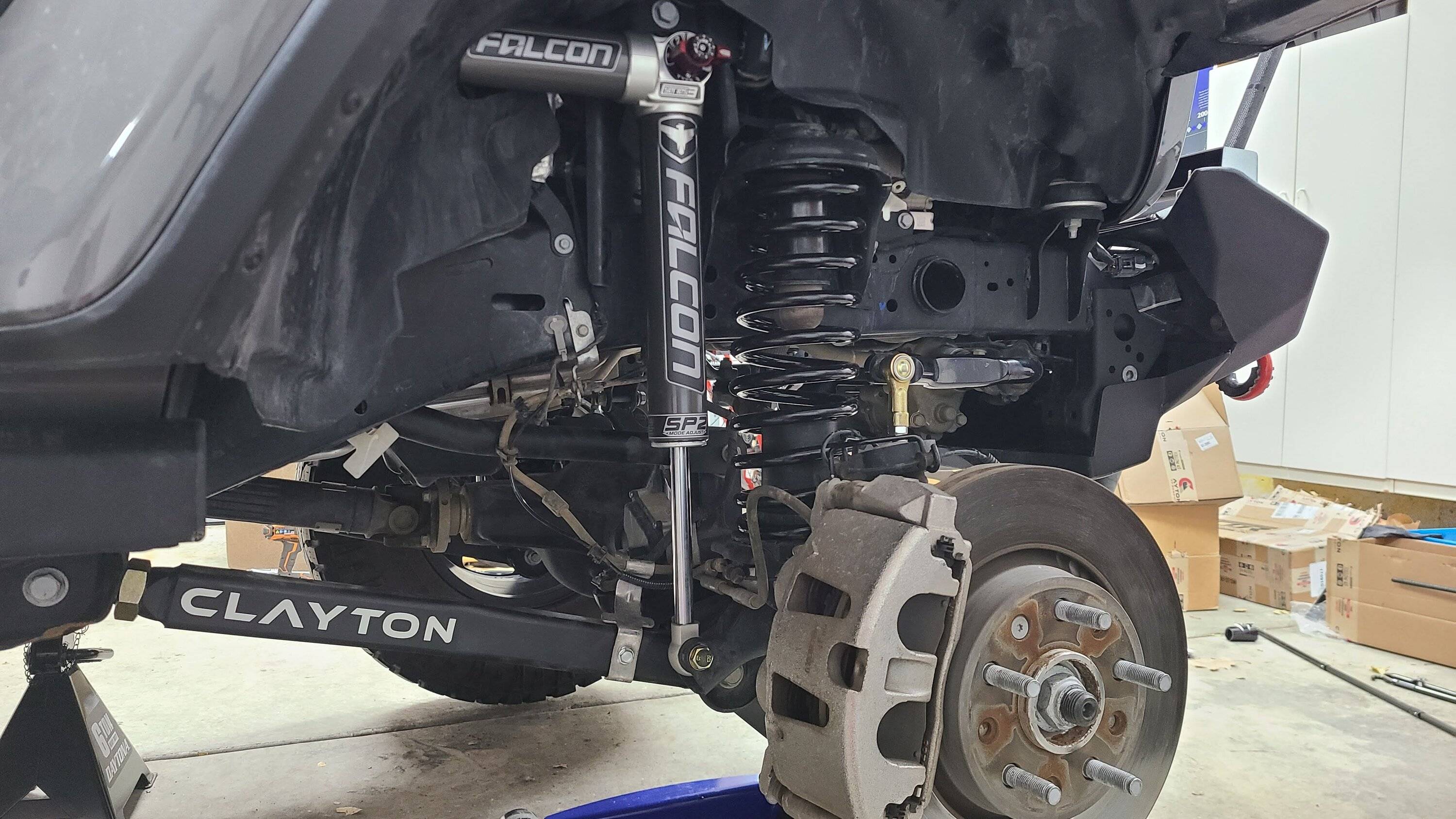

I am somewhat of a YT Engineer (technically I'm a real engineer but chemical, lol) but beyond what has already been said I may have some insight as I just fixed my death wobble. A little background: I just lifted my 20k mile JTR using a full 2.5" Clayton Overland+ kit (upper + lower front and rear control arms, F + R track bar, sway bar links, springs, Falcon SP2 3.3 shocks, Teraflex 0 offset 17" wheels with 37" tires). This information is important as all of the geometry changes and extra weight make a significant difference. Prior to the lift kit I ran 35s on stock wheels and suspension since purchase with no problems with wobble. After I installed the kit, I took it to the dealer for an alignment as it was going in for warranty stuff anyway. This was a mistake as they didn't even give me a print out and argued with me when I wanted to add more caster than 4.5 degrees but that's another story. After the alignment was done I still had DW. I took it to a reputable 4x4 shop and had it realigned with somewhere just over 7 degrees caster. Toe stayed the same around .20 total. I went for a drive and still had DW induced by uneven bumps to one wheel or the other. I took it back and we did the wiggle test (turn the steering wheel quickly side to side a few degrees and look at the joints for movement that is not normal spinning but is vertical or "clicky"). We saw a little play in the knuckle side of the draglink. I had that replaced with a nice heavy duty Steer Smarts Yeti XD. The steering felt tighter but the DW was still there. I started to think ball joints or tie rod ends. To test the ball joints I lifted one tire off the ground and stuck a prybar under the tire and pried. No vertical movement from either side. I pulled and pushed in the horizontal plane on the tire. No play in any other BJs, either. Still, I have heard cases where the wear is undetectable via these tests. I was about to pull the trigger on the tie rod but decided to experiment. According to the alignment printout, my toe was .2 which I believe is a little less than than 2.5/32nds toed in. Since I didn't have a second hand, I rudimentarily used a tape measure on the tires to estimate the toe but decided it didn't matter and that I would go by 1/4 turns of the adjuster on the tie rod end. A quarter turn appeared to be around 1-2/32nd movement in the front measurement. So I added 1/2 turn of toe in to the original setting. Took it for a test drive and the DW was much worse. I could feel that on any bump it wanted to go into an aggressive oscillation. I got back under it, set it back to the original setting and then went 1/2 turn in the toed out direction. By my guesses this would probably put the toe at zero or slightly negative. I took it out for a test drive and DW was 99% gone! Hurrah! I was elated! I brought it back and added another 1/4 turn (total of 3/4s from the original .2 setting) and it was completely gone and the steering is perfect! I did have to loosen the drag link and recenter the steering wheel with the new setting but it works great now. When checking torques on everything I did notice a loose swaybar link but that didn't have any effect on the DW.
SO, long story short, going with more negative toe (counter to many experts that suggest up to 1/8" toe in) solved my DW problem and did not make it dart into turns or make braking less stable. I agree with other posters that if the OP did not modify anything on the vehicle I would start with a torque check of control arms, TRACK BAR, drag link/pitman arm, and tie rod. The stabilizer is unlikely the cause and a new one could mask your problem but not solve. Do some basic BJ tests as above. Have the alignment checked as it can be a major portion of DW issues. In a rare case, an unbalanced wheel can cause it, too, but I feel like you might feel that regardless of hitting bumps. Hopefully this helps someone.
