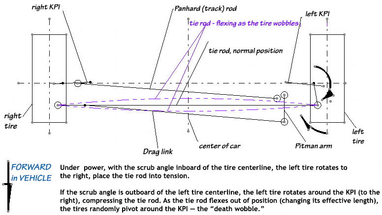

You know I agree with you - we've covered all of this and more over many months. The problem is - it's the internet and there's always YT trained engineers out there..........
I've posted quotes, diagrams, explanations and more from suspension and steering experts, designers, even a guy who owned a 4x4 shop and another who was an engineer for Chrysler/Jeep for years (and other companies as I recall.
The internet knows better, I guess.
This is a quote from a guy who raced Jeeps, built Jeeps and Power Wagons and so forth - but will anyone buy what he says? No, because the YT trained engineers know better. They put on a stabilizer and suddenly the truck was fixed.
Jeep Gladiator New steering damper made death wobble worse 1675311182127
Then people go and change things - move the wheels out with spacers, change the wheels, bigger tires, lifts and throw the geometry out of whack and you can end up like this explanation -
Jeep Gladiator New steering damper made death wobble worse 1675311507547
That came from an engineer who worked for GM, Hummer, Freightliner, as an engineer, etc.
Toe, scrub angle/radius, the intersection of angles, stock parts having to handle the huge gyroscopes on the front corners we call tires...........
Any looseness is bad.
Some of the torque specs out there are not factory specs (oddly, the specs that circulate out there that come from the MOPAR lift kits are actually not as tight as the factory stock specs).
Brother, we're always on the same page! Someone asked me was I an expert. I laughed and said, "Hellllll No!!!". Everything that I say, I've either learned from a shop or expert on the subject or I've learned from my own experience. When I have to take my Jeep to a shop for something I can't repair, I hang around while the work is being performed. I ask questions. I learn things.
And just like you, in the past, I have posted specs, diagrams, and charts. And yet we see the same questions answered over and over. And once again, you posted another diagram which is SPOT ON!
And when I originally had my lift installed, the dealer did it for free. Got a huge military discount. I started checking specs. Not for an issue, just wanted to learn about the components used. And you're correct again! A lot of the lift torque specs are different. As a matter of fact, I've noticed a lot of aftermarket replacement components has different specs.
I see a lot of your comments and posts. And just like everything else, I always learn something. I'm definitely no expert, but I know how to learn from an expert. Lol. Again, good diagram, good explanation.
