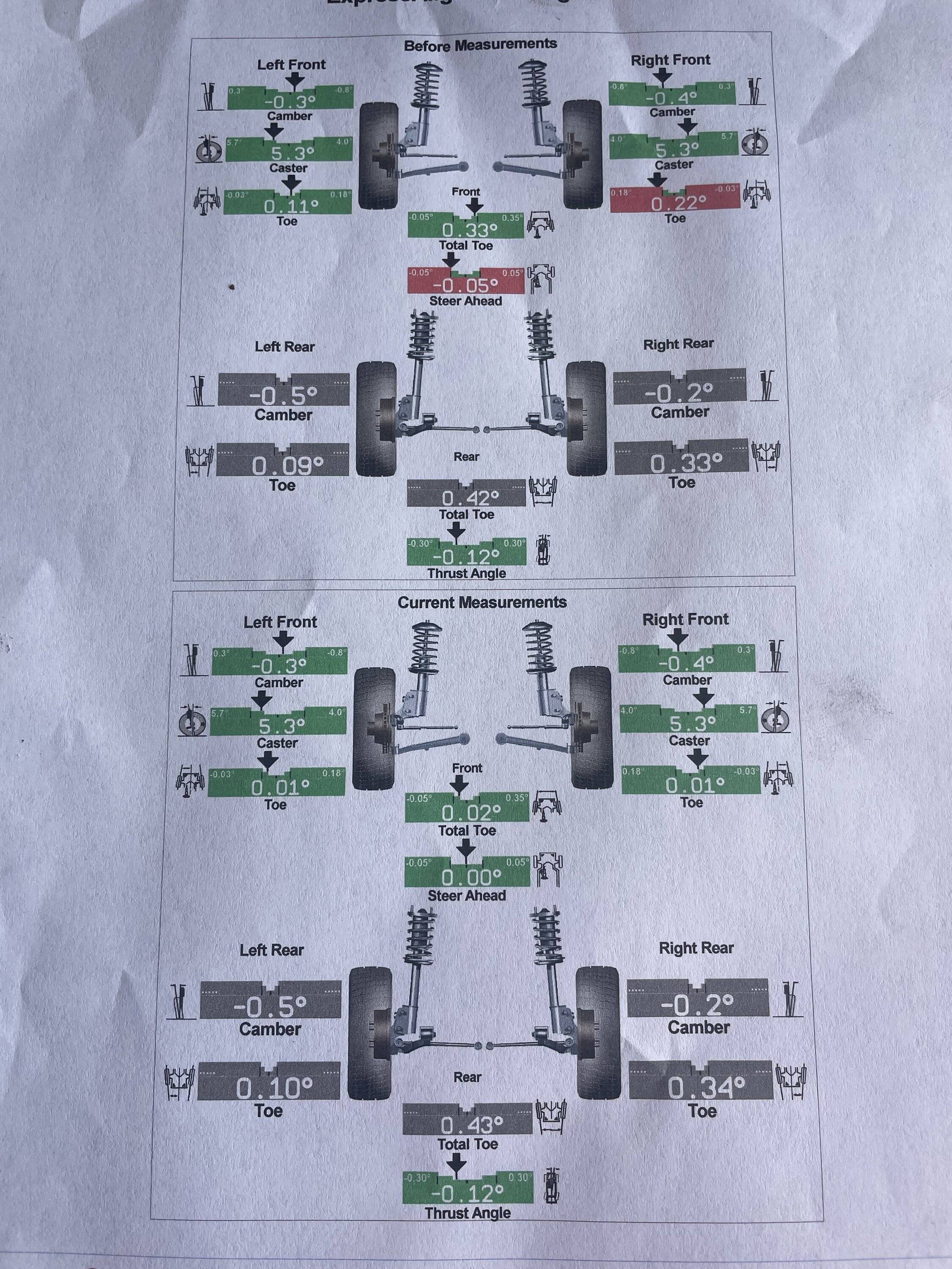

2022 JT Overland 18k miles. Took advice from Josh at Jeeping for Beginners in Las Vegas, he owns an alignment shop. Check alignment this morning, toe in, 1 tire more. Adjusted toe out to max allowance, mine is .02* overall out, now no shimmy at all.
That was waay in. And your steering wheel was off-centered.
What I see is that it could have been fixed by putting it very slightly toe-in and still gotten good results.
you are comparing something way out of spec and off-center.
