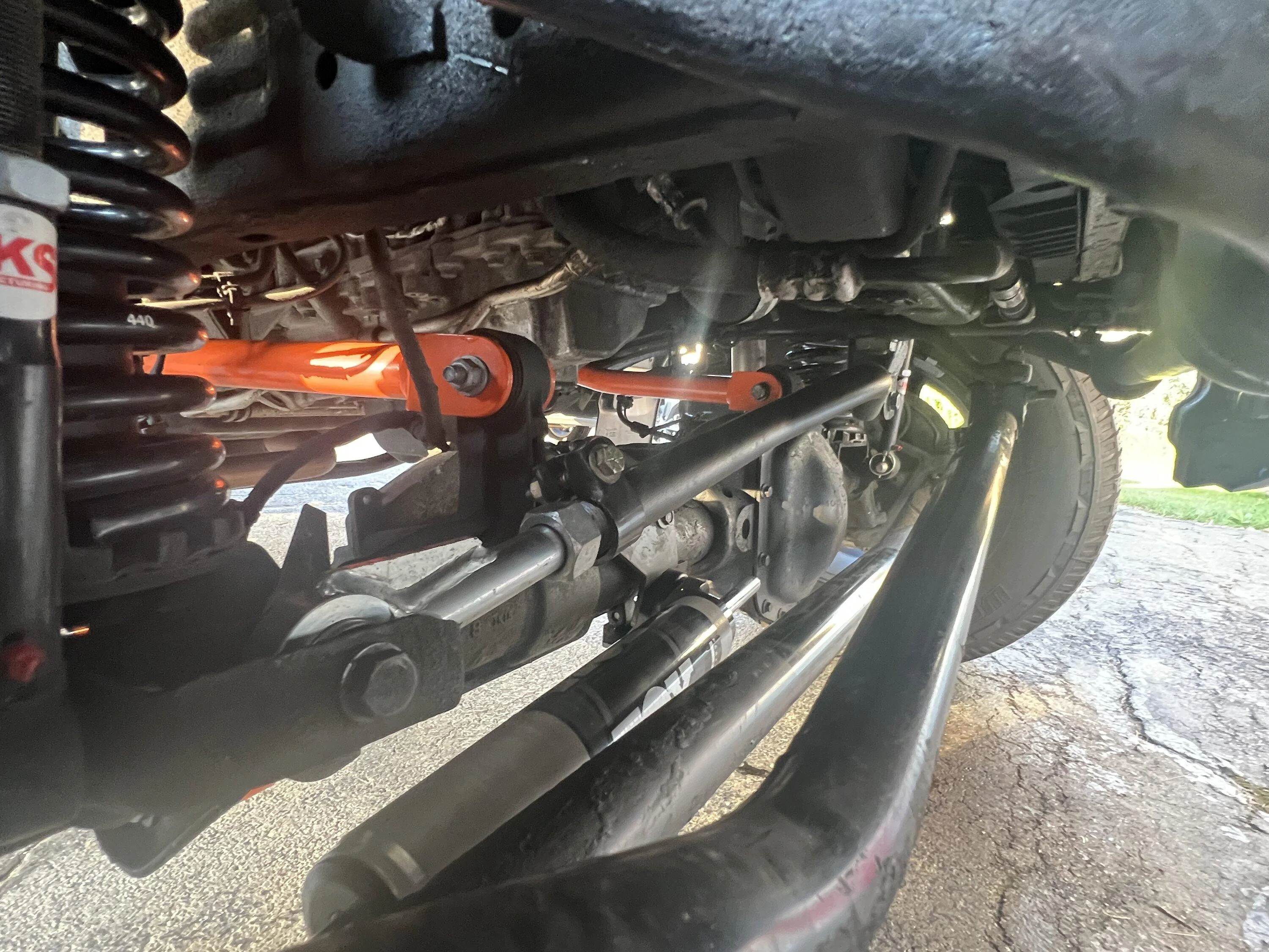

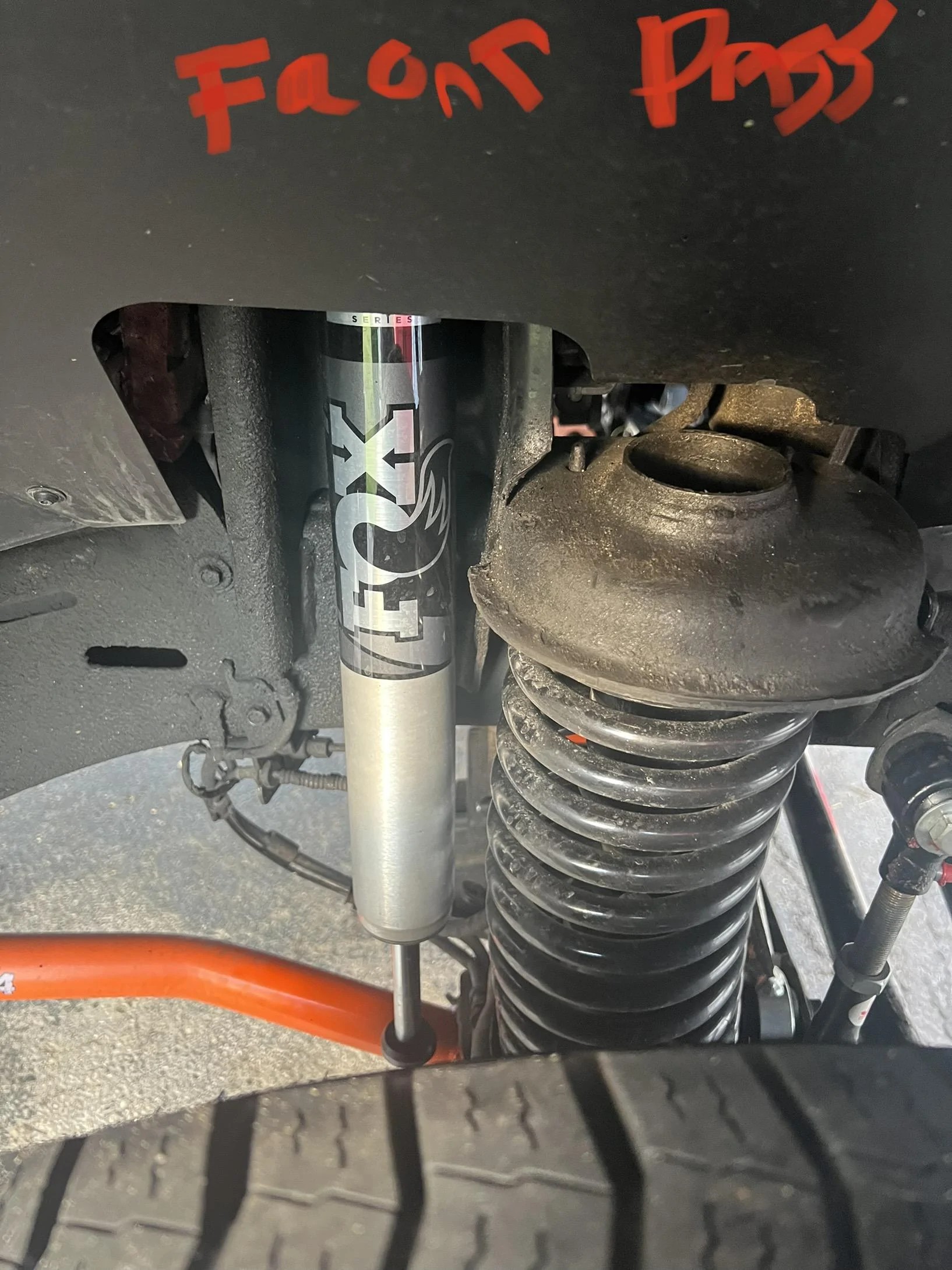

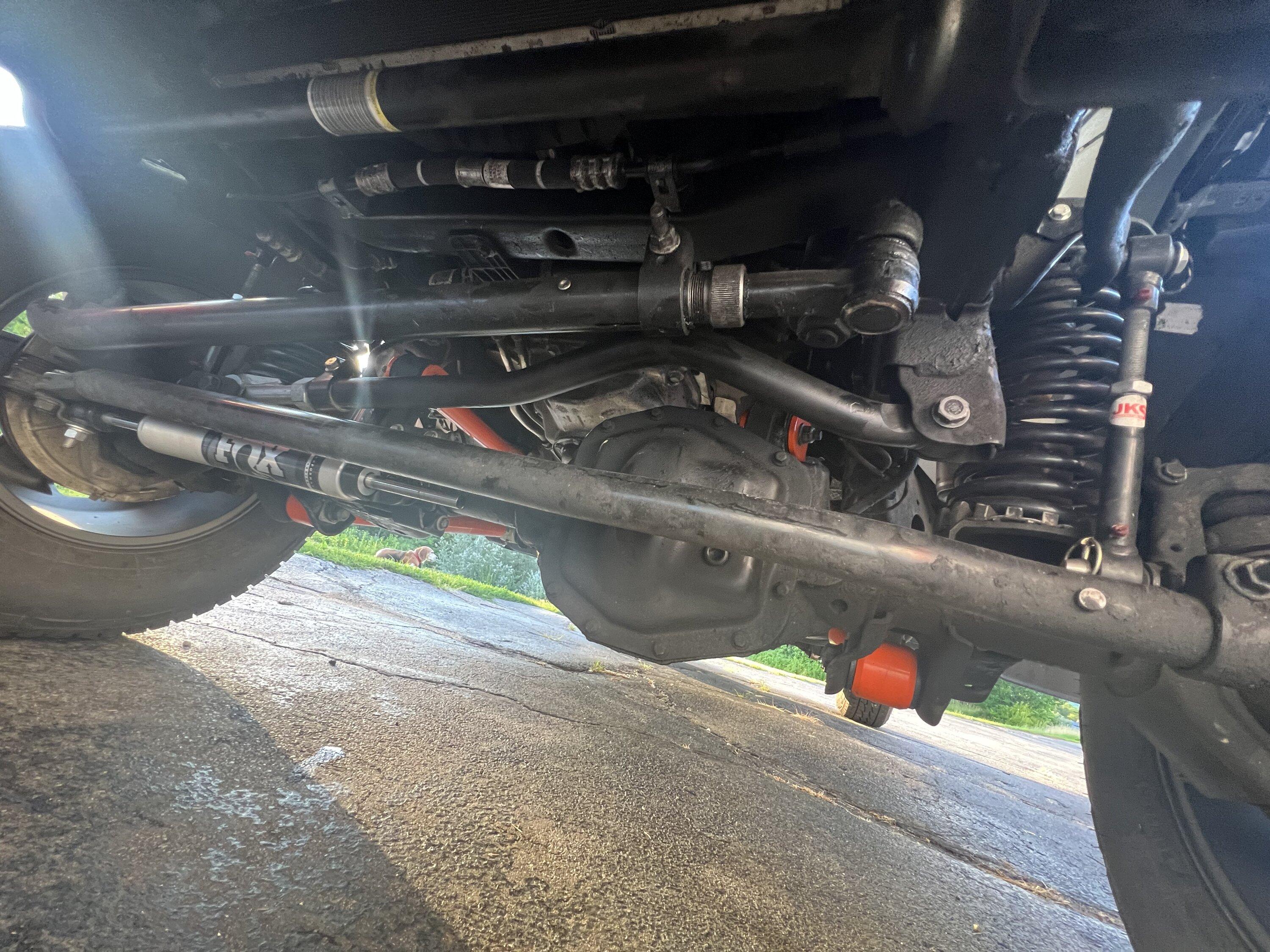

Possibly however the shake in the wheel was not a sway. That insulated pvc weighed maybe 150lbs so the trailer was almost empty which may have been worse.
did check the bolts bushings and I took some pics of my control arms and bushings and sent them to Bds/core 4x4. Nothing that can be diagnosed through pics but I do feel maybe the front axel is too far forwaed. Idk drivers great but like the front shocks lower is close to the shock tower. All my arms were set to speck I know I’m reaching.
springs look great little bow outward on drivers side but seems to be common and my track bar is at the right length. Does seem like the sway bar is closer to the frame on the passengers side than the left. I feel like my front disconnects are angled different than most I see.

Looks like your pinion angle is off- your spring is bowed in the second photo.
If the pinion angle isn’t off- check and verify the length on driver and passenger side…… one side might just be a hair shorter than the other.
Get a magnetic angle finder and level ground and check your pinion angle. - this is a contributor to DW. This is important for drive line vibration (& life of the u-joints). The upper needs to be extended to correct the spring bow- but your lower might need to be extended as well to correct the angle. They both need to be checked together- make an adjustment and recheck everything…
Next check your toe- usually 1/16” out is good- sometimes needs a bit more.
Ensure the track bar bolt is torqued to spec not just “tight” check with a torque wrench. They can be tight, and still be loose enough to cause the bolt to wallow out the mount hole (axle side most of the time).
My money is on the control arms given that your spring is bowed just a bit.

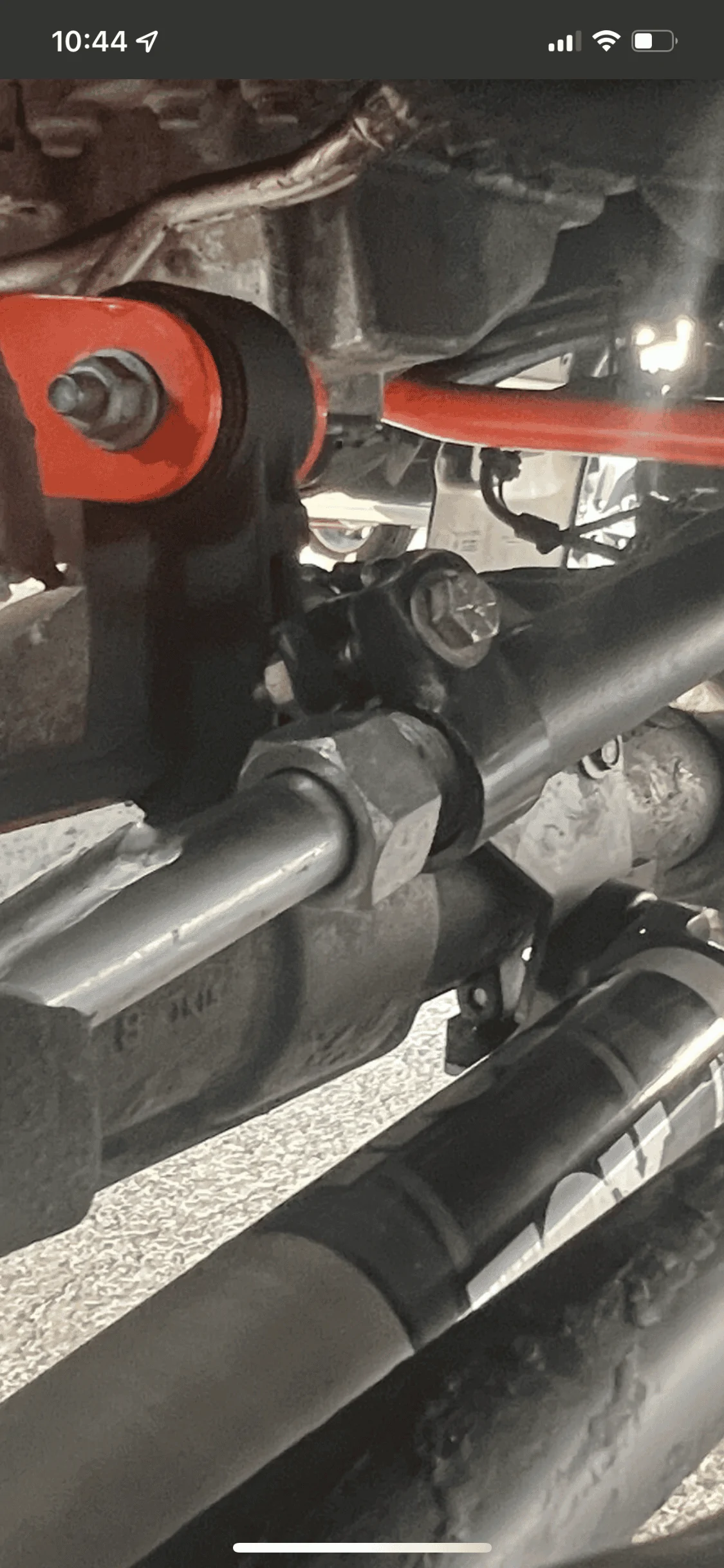

I thought the orange control arms looked familiar!!!! Looks like you got the axle centered and the track bar extended.

Track bar is extended for the center axel I was 1in off to the drivers side and now I’m within 1/4 inch on both sides. I agree with the pinion angle as I did have to shorten the upper control arm. The springs were pressing against the upper bump stop tubes (previous forum issue lol).
