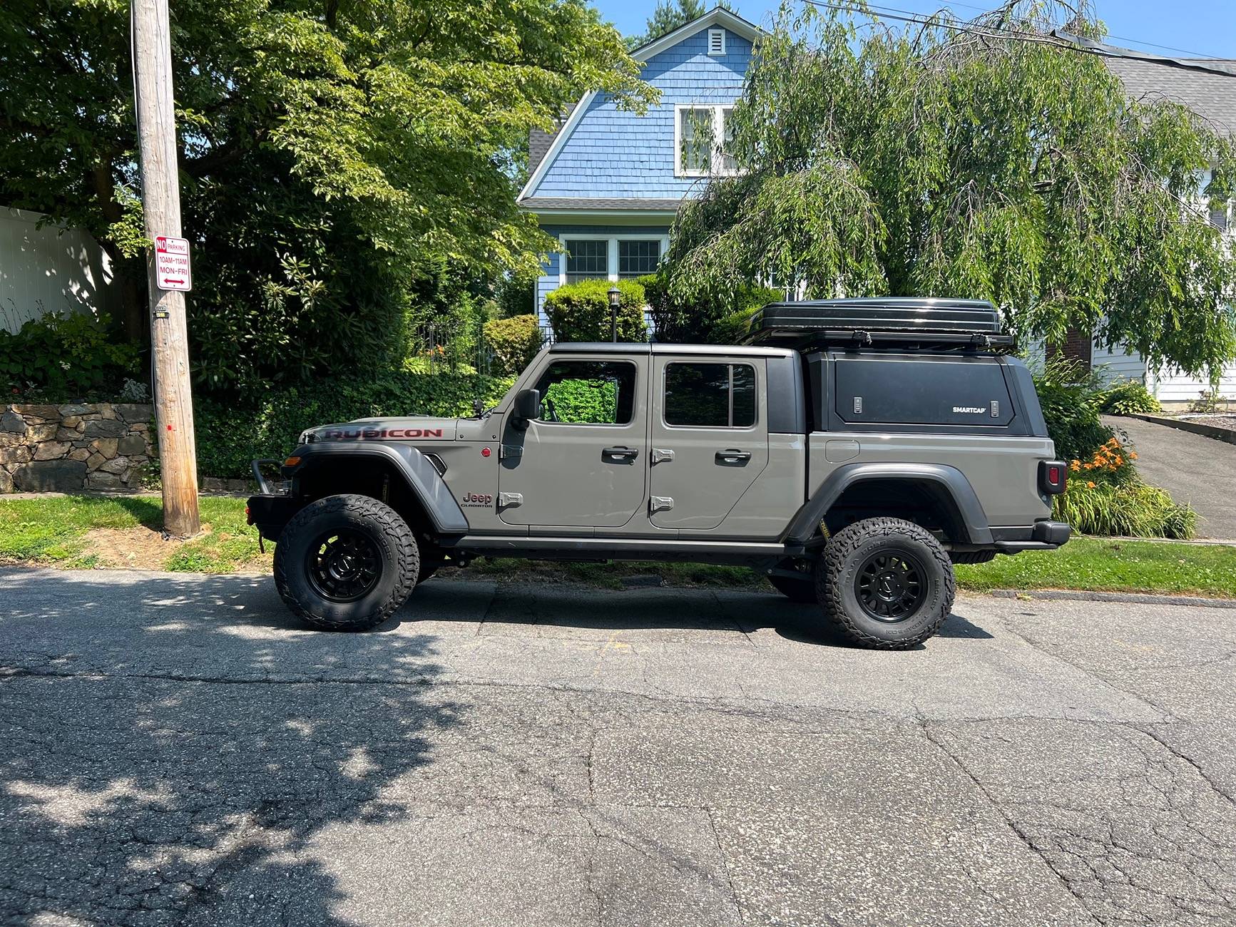

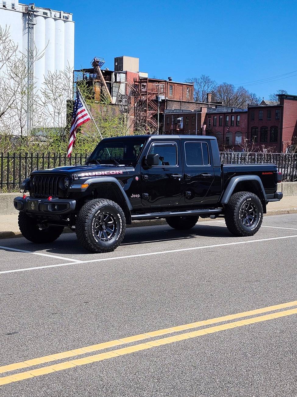

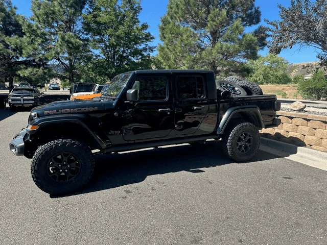

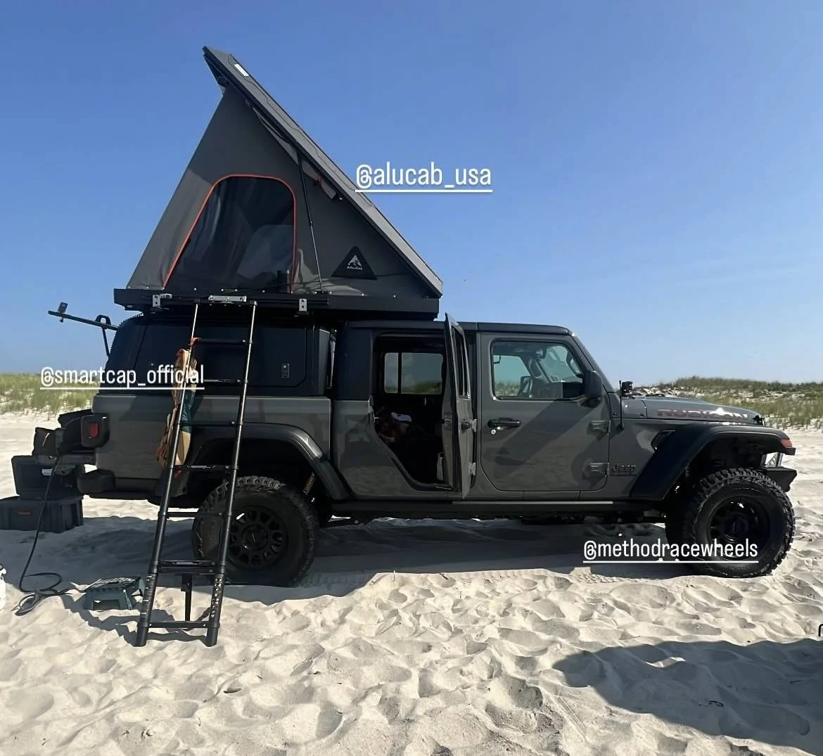

Both pics have the Jeep with 3" AEV lift and 35" Mickey Thompson tires. The top pic shows you can see the ass up a bit. It's actually worse than the pic shows because I had 5 wheels and tires in the back.
This is due to the heavy duty springs you get with the 3" vs the 2.5". Bottom pic is from this weekend when back was loaded up for several days at the beach (sorry for the IG tags).

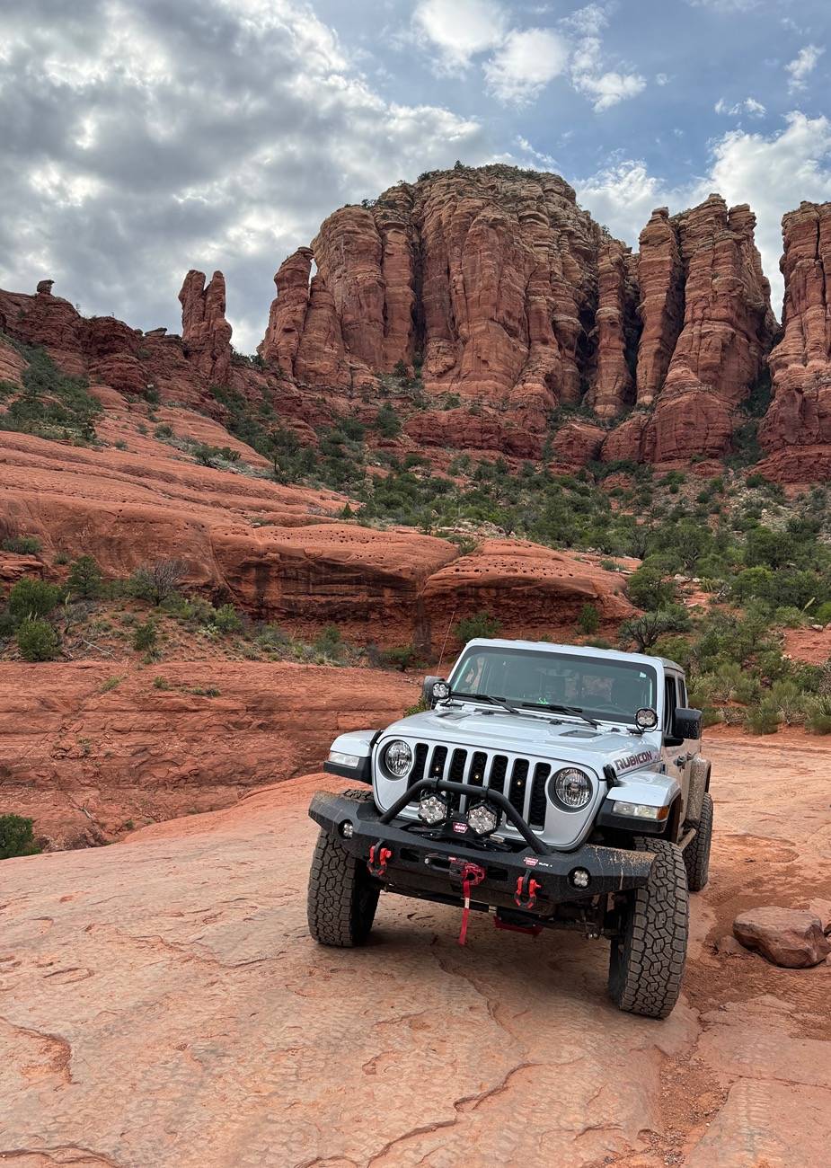

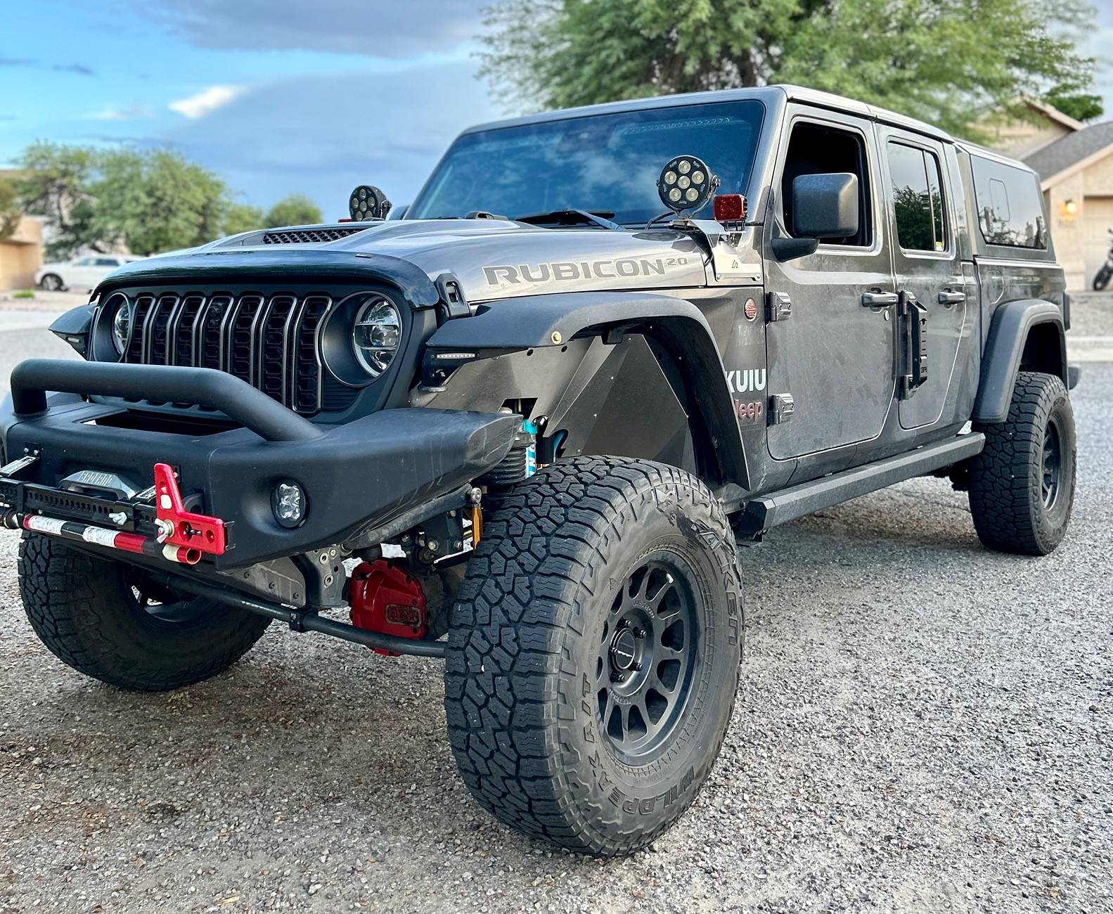

35x11.5R17's (Toyo ATIII's) on Method Beadlocks. Clayton 2.5+ Overland lift. Netting over 3' up front and close to 3" in the rear. The combo ended up being just about perfect for me. No real need for 37's or 3.5' lift. I'm not pretending this is a rock crawler :sun: - just wanted some extra peace of mind in the AZ/UT rocks.
Looks great. It sounds like we are similar in that I wanted a bit more clearance for the same reasons. Combined with the fact I have some limitations in the garage on height this seems like a logical combo. I guess the bonus is no need for a regear which would be needed for the larger\heavier tires.
What shocks did you use?

Yeah, that sounds about right. While I rubbed occasionally when stock, I haven't come close to rubbing the undercarriage after the lift.
Keep in mind that the Clayton 2.5" Overland + lift leaves the vehicle sitting HIGHER than 2.5 inches. I'd guess around 3.5 up front with no lift / winch - and although I have a winch and steel bumper, my lift came in around 3" up front. A hair under that in the rear.) Another added benefit on the 2.5" over a 3.5" lift - you'll have no need to address new drive shafts like you would with a 3.5" or higher.
I also put Rancho skids on the Diffs, and even those have not seen rock scrapes yet. My ASFIR skids have remained un-scraped as well, although they both will no doubt get hammered in the future. Although not incredibly technical (3/6 - Trails Offroad), I did all the hard lines on Broken Arrow in Sedona with no rubs. So overall.....very happy with the results, and no need (for me) for a 3.5" since I went Clayton.
When choosing shocks, I opted for their high end (which is not REALLY high end, but instead more of a high end of mid-grade consumer shocks) -- the Falcon SP2 3.3 2-3" JT Shocks. Really liking them as well as the Falcon adjustable steering stabilizer.
BTW, LOL, I took it back for a repair and re-torquing everything after a 500+ mile break-in, and the local shops expert wheeler guy took it out on their test trails and got it articulating to the point of being only on ( barely) two wheels, and he mentioned that he hasn't see a Gladiator ever articulate this well. It's more than enough for me. LOL
