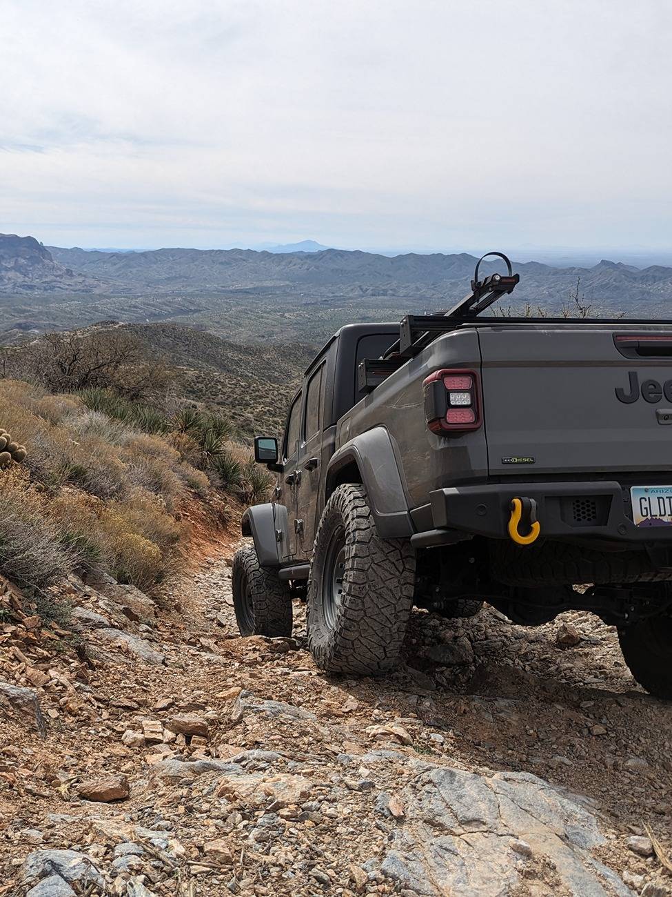

I run a 1in spacer on OE wheels, it does tub rub hard in the rear when flexing out, but hasn't deleted them yet. a 1in bumpstop spacer would fix that. My swaybars also don't disconnect, so with a rubi you might tub rub on the front at max flex but you also might not since the rubicon stock bumpstop sit lower than a Mojave and it doesn't move. Your main notice will be gearing. Some of us are picky and immeadiately require a regear to 5.13 or 4.88. While other find 4.10 to be more than adequate. Its all personal preference. So it will depend on your comfort level. My setup I'm happy with and it only rubs under max articulation in the rear. Not while jumping and never on the road. I like to keep my center low. If the fender contact ever becomes on issue. I'd delete the inner fender before i got more lift. But to answer your question, yes you can just slap on 37s and call it a day. you'd need at least a half in wheel spacer on the front to not rub but 1/3 and 3/4 spacer require cutting the OE studs, so i went 1in. With OE +44 wheels on 1in spacer i'm somewhere at +18~20 offset which is perfect for widetrack axles.

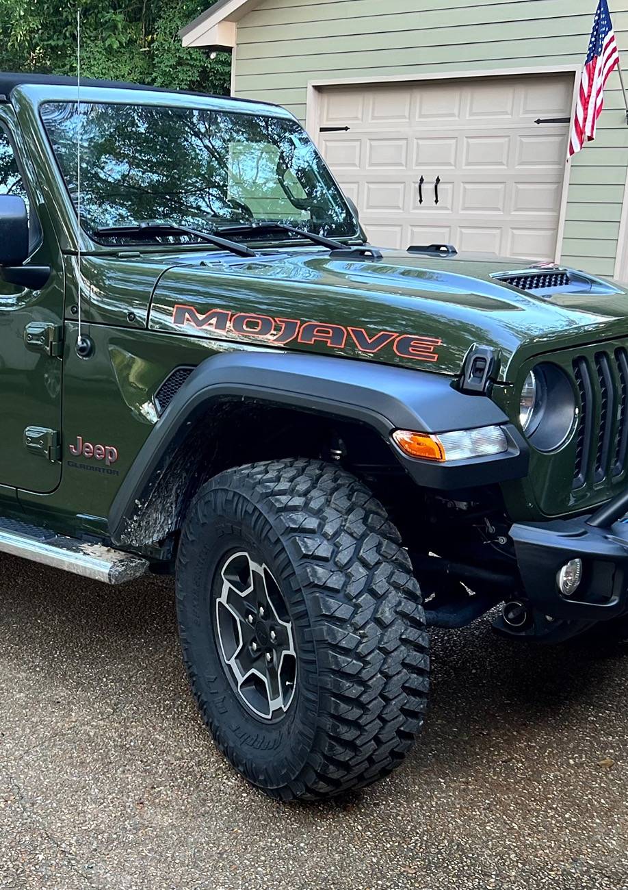

I run the 35x11.5 Toyo AT3 on the stock Rubi wheels. No rub anywhere and the 11.5 is an optimal fit for a 7.5” wheel. That said, I haven’t seen anyone have issues running a 12.5 on stock wheels. You just might experience outer wear a bit faster.

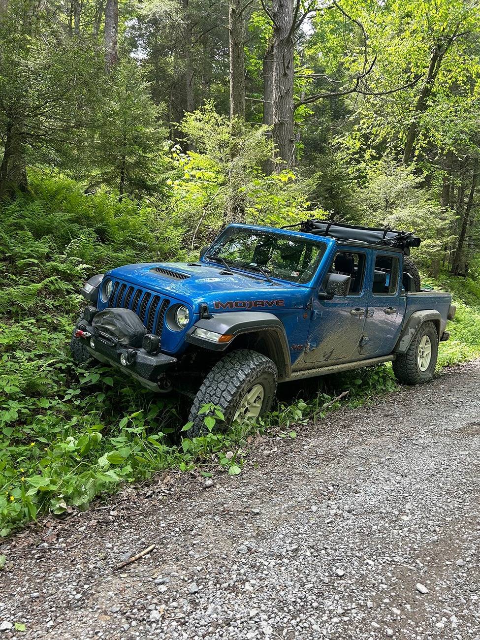

35x12 nitto ridge grapplers on 17x7.5 stock rims. No issues at all for three years
