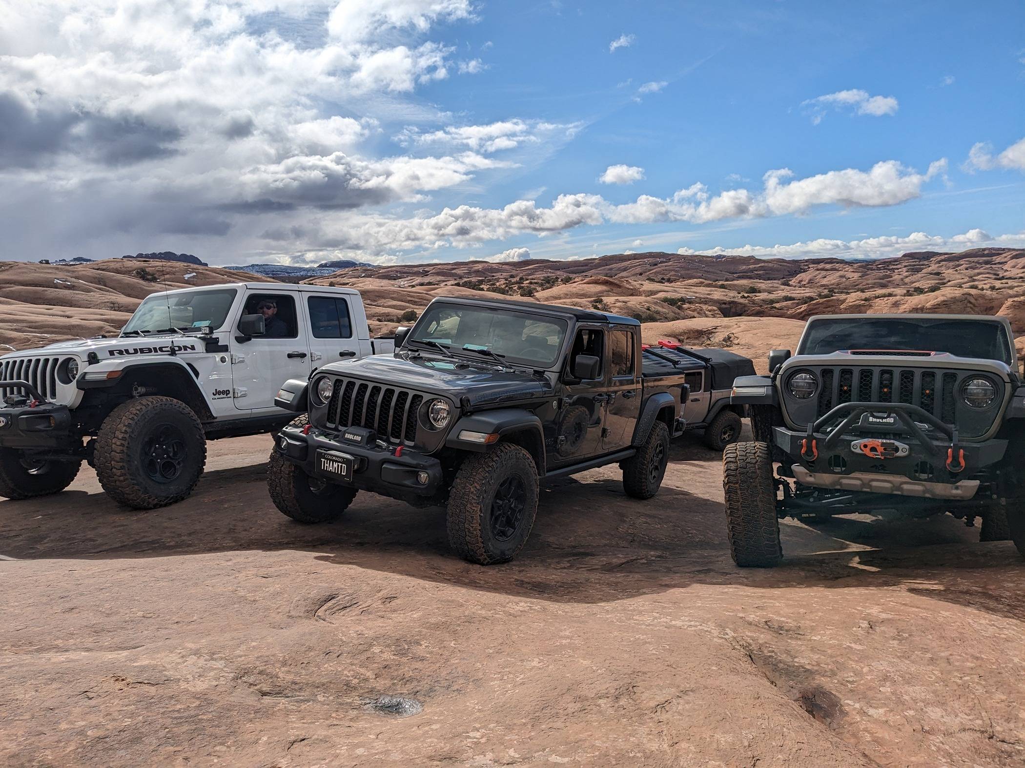

Duratrac isn't a good example. My buddy lost a D-rated Duratrac on a trail we did in Moab. My C-rated KO2's went right through it, as did my cousin's JK with C-rated Wildpeak MT's. We had many scars on the sidewalls, but only the Duratrac failed. I've been back to that same trail 2x on General Grabber X3's (C rated) and they held up fine. I've been all over the place with them, in fact, so far so good. But it is hard to compare that way because sometimes you hit a rock just right while someone else doesn't.
I do know that a JK guru on a big JK forum, Mark Dioron, puts tens of thousands of miles on his overlanding rigs. He moved away from Duratracs because he felt the sidewalls were weak, having lost at least a couple of them. I'm pretty sure he was running E-rated 35's. He's the one that steered me away from them when I wore out my KO2's.
