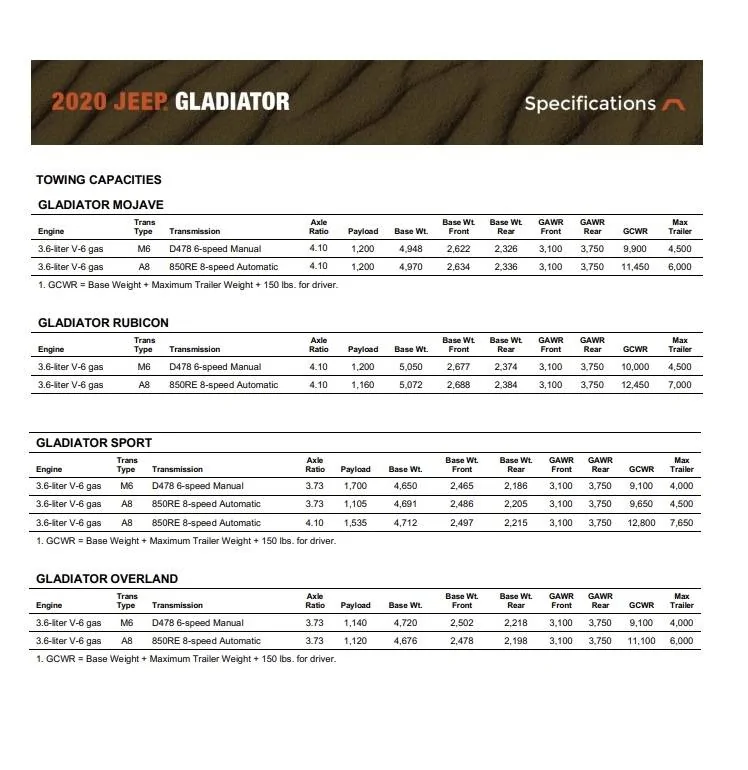

Mariner
c = 2910 pounds (per tire)
e= 3970 pounds (per tire)
Gladiator rear axle rating = max gross = 6250 pounds
You are wasting your money.
E rated tires are thicker and much more puncture resistant than C rated, hence the extra weight.
